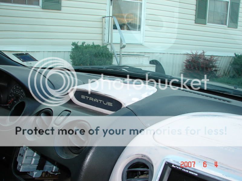

Do you still have a passenger side airbag?
Yes, the airbag is still in and functional. It is actual on top of the dash. I found one in a junkyard (the one this cover came off of actually) that had blown the airbag and measured so that I could be sure the cover and the airbag blowing wasn't going to turn the screen into schrapnel if it went off.

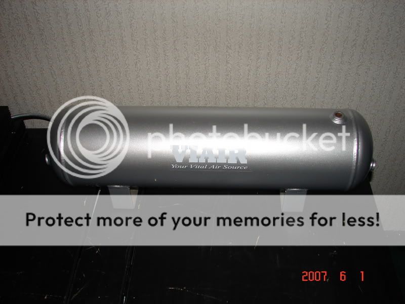

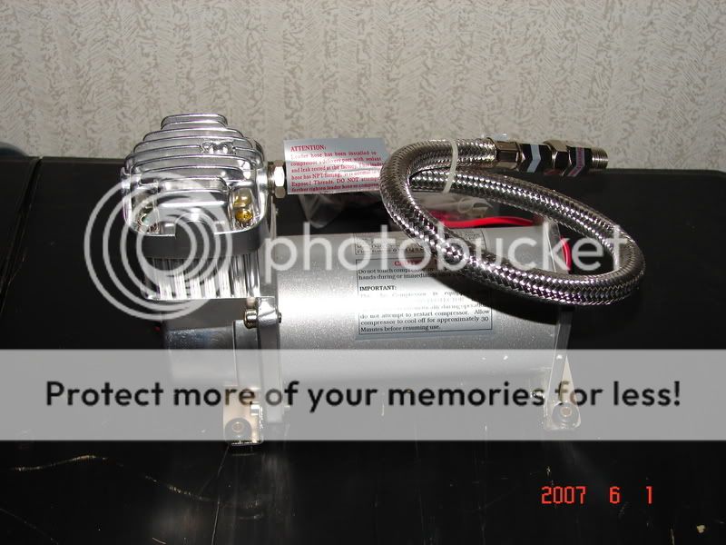

Got a couple new toys in the mail today also:

cool lookin doors. im not a huge fan of the dash tweets tho. its gonna be fucking loud however. i can tell ya that //content.invisioncic.com/y282845/emoticons/smile.gif.1ebc41e1811405b213edfc4622c41e27.gif
The dash tweets aren't true tweeters, or that's not how they will be used. CDT calls them mid-tweeters, and they were actually designed to be mounted exactly like that in conjunction with the Soundstage setup, which I have. That's the centerstage setup, specifically designed for use as a centerchannel, and they recommend firing them off the glass in the center. They won't be given the full power of the rest of the tweets, they come with an adjustable crossover/level adjustment, so they can be adjusted down just enough to bring the imaging up.
Or at least that's the theory behind them......lol
