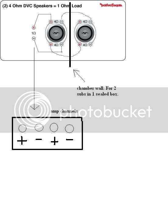

Im trying to wire 2 subs in 1 ohm load, but my question is.. I have a sealed box with separate chambers.
1. Would it be ok to cut a hole in the chamber between and run the wire through and seal it up?
2. Also, If im putting my subs into 1ohm load which holes would i hook it up in?

1. Terminal cup. (And if you don't wanna spring for that, another thing you can do (which is pretty rigged) is drill a screw/bolt through and connect terminals to each side. So it, in effect, acts like an electrical pole.
2. What kind of amp is it? Are you just using one channel or bridging?
If you're just using one channel, it shouldn't matter. If you're bridging, that was a dumb question.
Is your amp a 1 channel or 2 channel? If it's 1 channel and has the 4 speakers connections like your picture you should be able to wire each sub to 2ohm and put them in that way...if it's a 2 channel amp is it 2 ohm stable?
