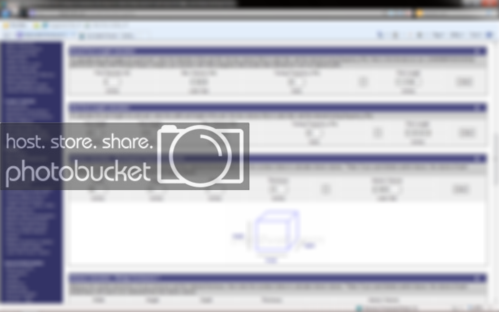

Ok so Im trying to build a box for a RE SX 12".
2 cubes tuned to 33hz is what Im shooting for.
So far using the 12volt.com enclosure calculator and the room Im working with, I have come up with a box that is 14" tall, 56" wide and 7" deep. That gives me a volume of 2.168

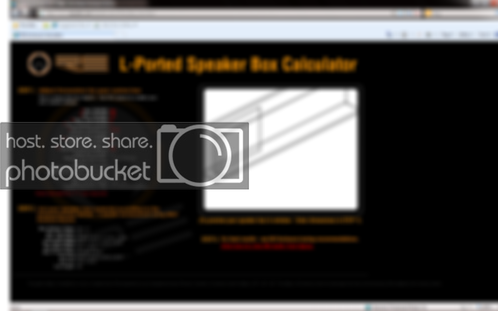

Now I also used the port calculator and came up with a port that was 4" wide, 12.5" tall and 51.228 long.
Do all these numbers add up correctly?
If I need to add more volume to the box to get me the 2 cubes the only measurement I can change is the width of the box.
Thanks in advance,

Sounds like trouble to me. Ive never built any other box except slot ports. I did mess with a round port calc on the 12volt also though. Could I just use a PVC pipe as the port?
Of course this was working off the first set of measurements I posted.
