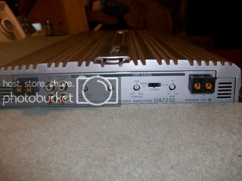

is this what you meant by 4 RCA inputs?
No. I'm not quite that ignorant, the output ones are to "daisy chain" your amps. But I assume that is what it would look like if I could find something, just both being inputs.. Not sure why eclipse never made amps to match their hu outputs.
i apologize for testing your ignoranage..lol...but no, I have never seen an amp that would accept the inputs straight from that Eclipse...It is a unique approach to eliminating patch cable interferences by recombining the signals near the amp location, which leaves very little unbalanced patch to be contaminated...but makes a rat nest of rca's that befuddled many a installer. like I say, another Japanese trick, I tell ya!
