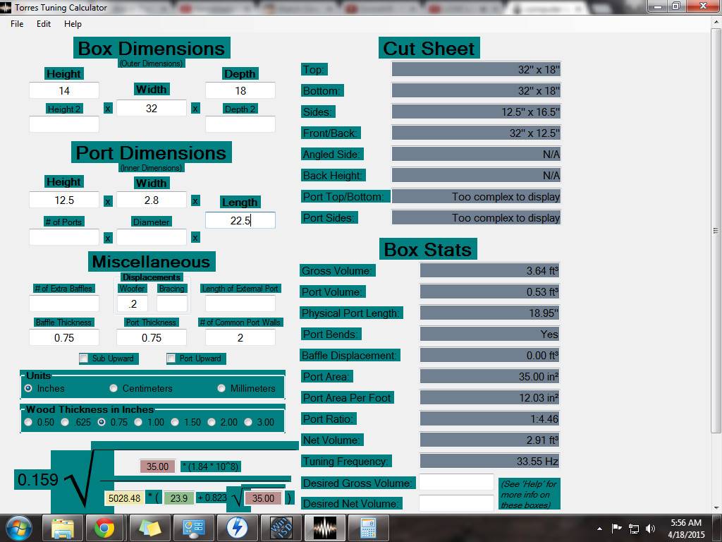

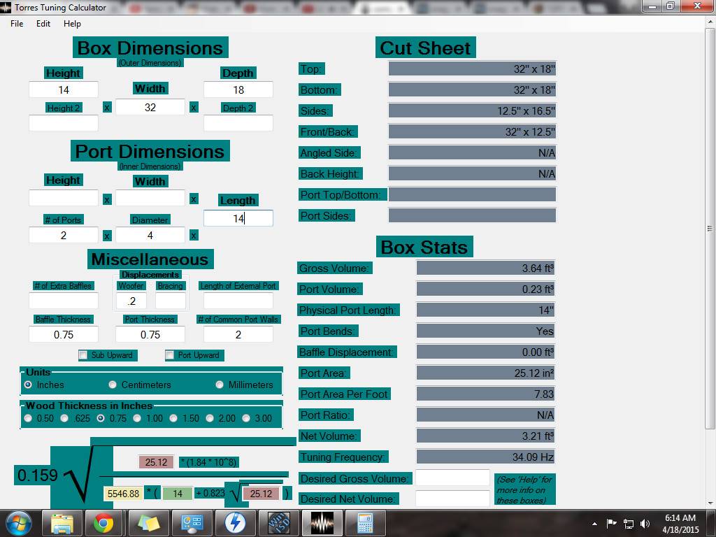

I have two infinity reference 1262 want in a slot port box 32x18x14 tuned to around 32 to 35 and I'm using a android phone can't get Torres to download can some one help so I can build this box need to know port measurement s and not sure on speaker displacement can't find it nowhere .75wood
I have two infinity reference 1262 want in a slot port box 32x18x14 tuned to around 32 to 35 and I'm using a android phone can't get torrent to download can some one help so I can build this box need to know port measurement s and not sure on speaker displacement can't find it nowhere .75wood
preferably middle slot 2 wall style
Just used .2, normally 12s are around .1 in displacement.
