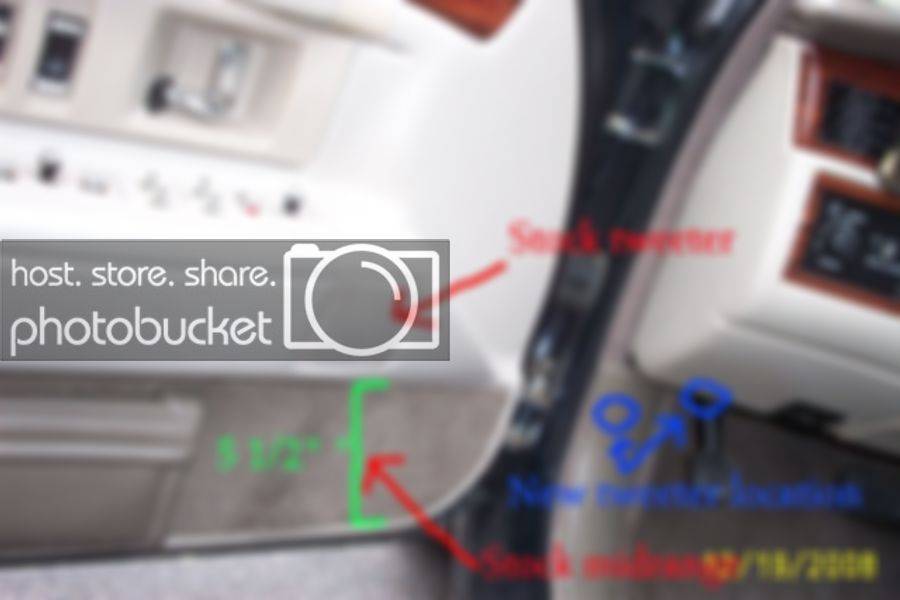

OK I had another idea... how about if I keep the midrange drivers in the stock lower door positions, and mount the tweeters on the lower part of the dash on either side, and swivel them to fire towards my ears?
My dash gradually slopes down so the mounting would be easy and would also provide a clear shot, while in reality only being maybe 6" from where they would be mounted in a kick panel installation, and only a few inches from the midrange.
In this picture, the midrange location is behind the carpeting on the lower front part of the door, and I was thinking of mounting the tweets roundabouts where the leftmost pedal is underneath the dash.

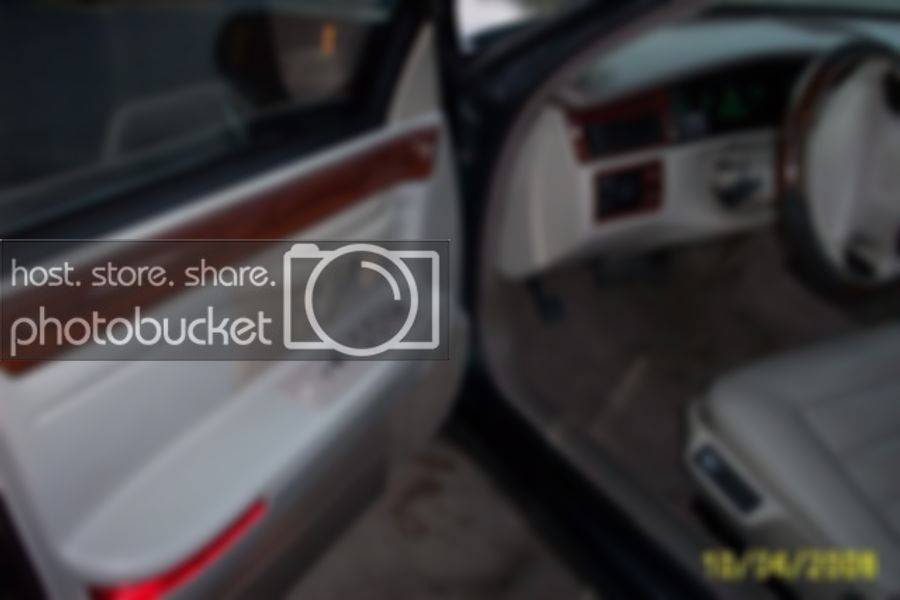

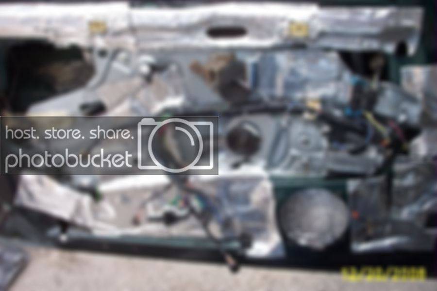

What I'm struggling with now is trying to fit these 6.5"s in a 5 1/4" slot //content.invisioncic.com/y282845/emoticons/crap.gif.7f4dd41e3e9b23fbd170a1ee6f65cecc.gif
Going to need some MDF rings, a grinder and careful planning.
if you can get a better straight on shot of your door i think it kinda looks like mine. my factory was a 5.25 on a plastic "plate" after i removed the plate and did some slight altering on the interior of the door and built a plate i was able to fit 26.5s in each door.
