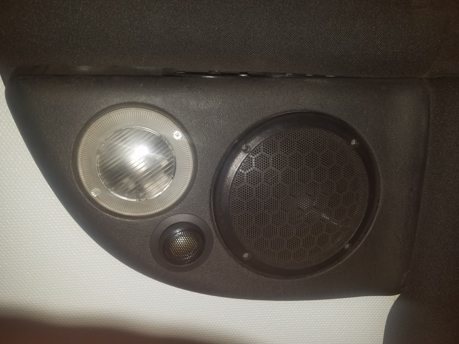

My question is about the speaker pods. Here are some random pics of the pods and their location in the Jeep.
This is a view from the back seat. There is a pod behind the driver and passenger seats:
These are some pics for size reference. They hold 5 1/4" speakers, but I can make up some adapters to fit 6.5" speakers.

1) Is there enough air space in there for a 6.5" mid-bass speaker from a component set?
2) Is that a suitable place to put the speakers? I ride with the top back and the doors off when the weather permits. Would those be too close to my head? I want to have good midbass and be able to hear it over wind/road noise.
Does that pod look like it has enough air space for the 6.5" to preform well on the low end? I think I'm going to go with the Polk DB+ component set.

The bigger question is will that extra inch of diameter make any difference whatsoever for the amount of trouble of modifying the factory mounts. If you have or are planning to run a sub anyway just don't attempt to run your mids full range and the airspace should be a non-issue.

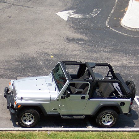

Here's a random jeep. I had planned on putting the woofer in the sound pods seen behind the front seats, and the tweeter on the dash/A pillar somehwere. That's not even close!

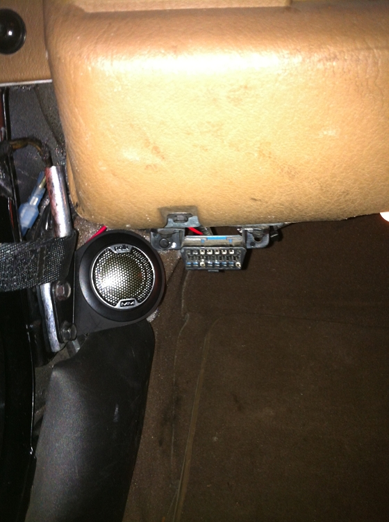

A guy makes tweeter mounts, but its down around your knee. They are, however, points up and towards the passengers. People who have bought them say they like 'em, I'm just not so sure.
I don't really want to go with the woofer in kick panels as it's already cramped enough down there anyways. Any thoughts or suggestions on speaker/tweeter placement?

As far as tweeter placement, yes, ideally they want to be on the same plane as the mids (coils should be equal distance to you and as close as possible)... this may or may not make an audible difference but it guarantees you avoid phasing issues. If you were really trying to win SQ competitions you would try absolutely everything either way so don't get too hung up on that. More importantly most "car audio" marketed tweeters are designed to perform best off-axis (listening from about 45 degrees to the side of where they're pointing) and may get harsh if you point them directly at you. Home theater type tweeters are designed for on-axis (pointing directly at you). Again, you'll just have to test everything to see what you like especially if you can't see published on and off-axis response curves on whatever you've bought.
