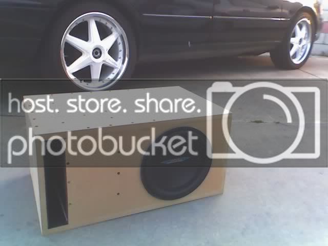

well, i've made more boxes since this old thread was abandoned. so i'll post some more pics. all taken w/ my cheap camera phone though...

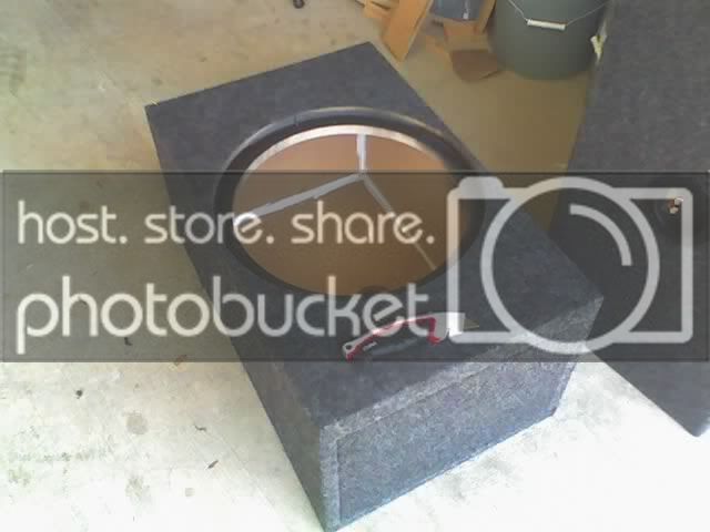

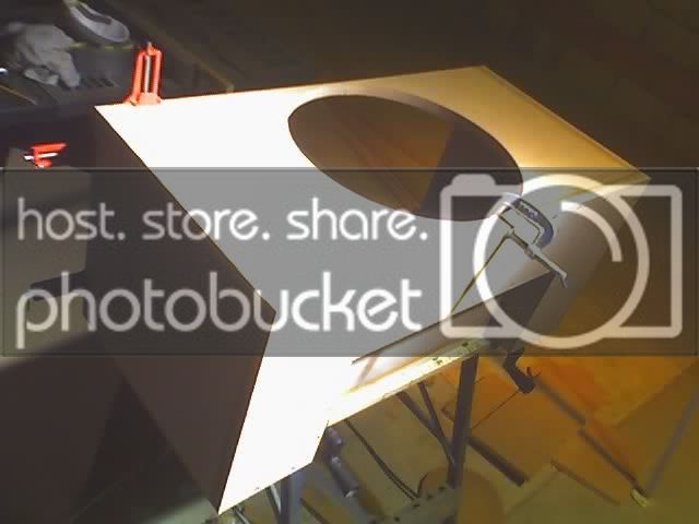

sealed w/ double/recessed baffle for a 15" Brahma.

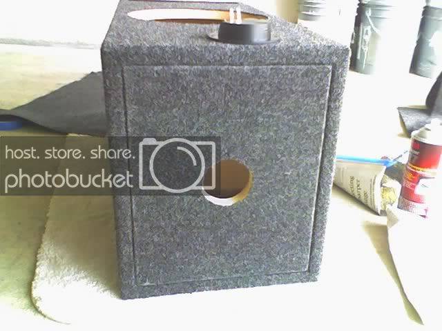

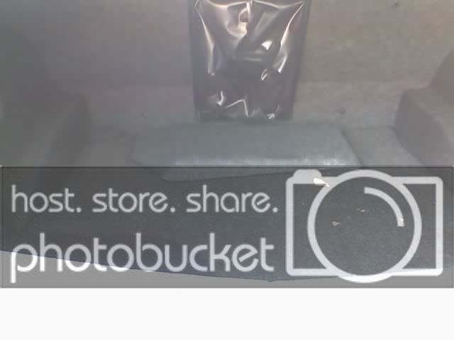

in progress: for a 15" SI Magnum. bottom needed to be modified to comply with a weird hump in the trunk of an Lexus IS 300
and i need to design/figure out a nice way to mount a 5 channel DLS A7 amp to the back of the box. Thinking of integrating a fan into the box/amp-rack to cool the amp since it will be between the box and the back seat. also because i noticed that the amp has the function of controlling external fans.

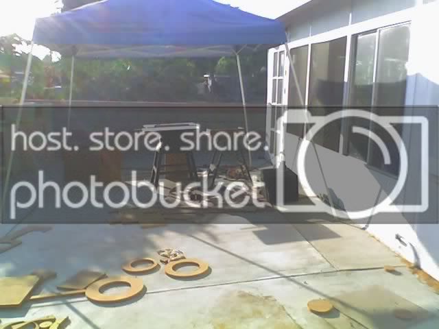

and all this is done in my funky little workshop outside.

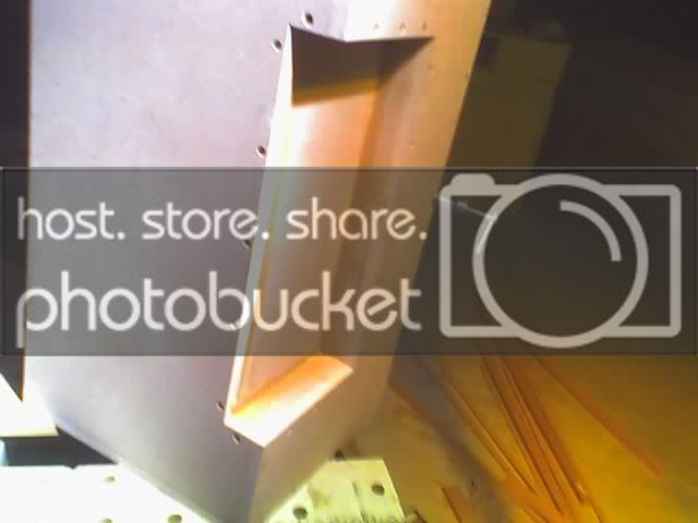

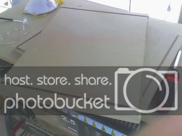

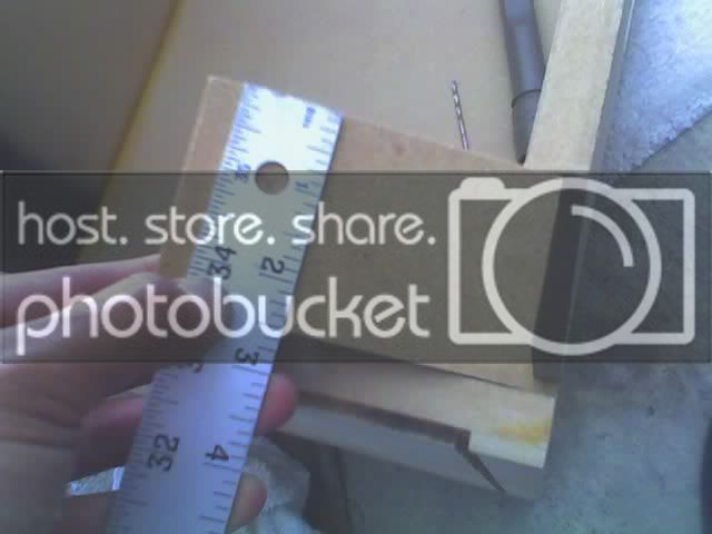

i used a router with a straight cut bit and cut 1/4" deep since i used a 1/4" rabbet bit.
the thing is that I had to use the straight cut bit 3/4" away from the edge.
I hope these pics help:
OHHHHHHHHHHH, now I get it. Thanks!

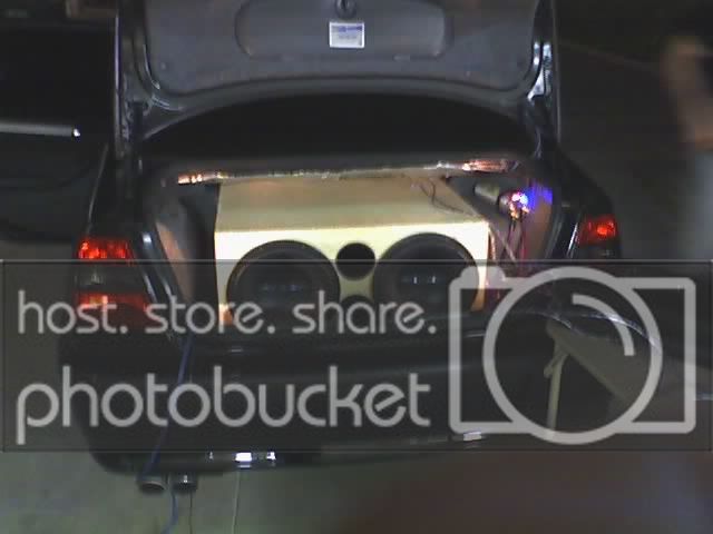

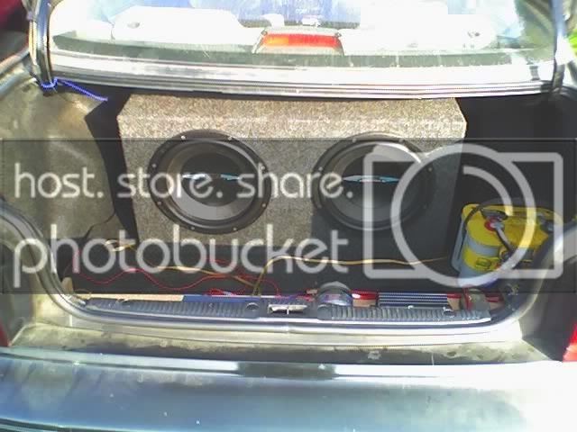

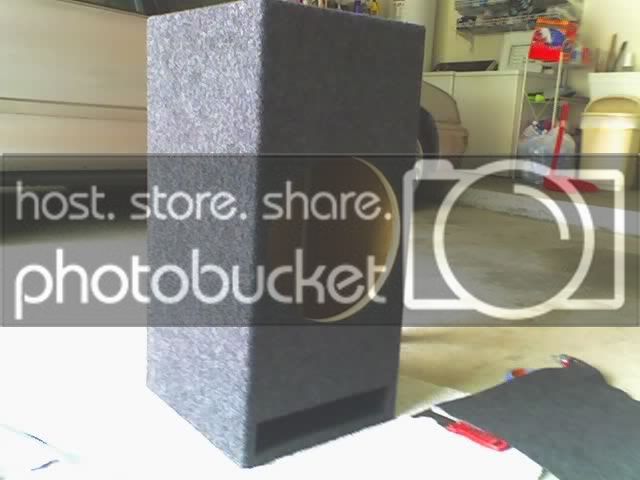

Whats the box ur using for ur IDMaxs'?
dual sealed box, 1.5 cubes each, 800w a piece, and lovin' it. //content.invisioncic.com/y282845/emoticons/yumyum.gif.0556df42231b304b9c995aefd13928a8.gif
...**** i gotta clean up my trunk.. false wall/floor soon to come, hopefully. if time permits.
