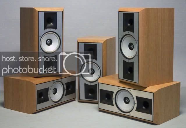

In a perfect world (i.e, at home), coaxially mounting the tweeter has several advantages //content.invisioncic.com/y282845/emoticons/smile.gif.1ebc41e1811405b213edfc4622c41e27.gif Tannoy, KEF, PHY, and many others do this.
It isn't recommended in a vehicle because of the problems of getting the speakers on-axis; the ability to mount the tweeter elsewhere helps with mounting compromises. But if path lengths were equalized, bi-amped coaxials could sound very good //content.invisioncic.com/y282845/emoticons/smile.gif.1ebc41e1811405b213edfc4622c41e27.gif
