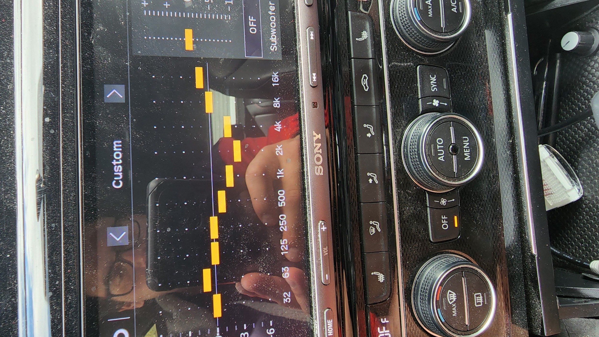

So you jacked up the bass and treble on the EQ and wonder why you're clipping??? Try flattening the EQ, nothing above +3db. When tuning an EQ you always cut frequencies first and only boost frequencies as a last resort (to avoid clipping).
Both crossovers to the component sets are set the same as you see. Currently the level control on the DSP is -2db for everything but the subs and the EQ on the DSP is flat for now. . I thought the -2 might help but I still get the same issue with an added muddiness to the sound.

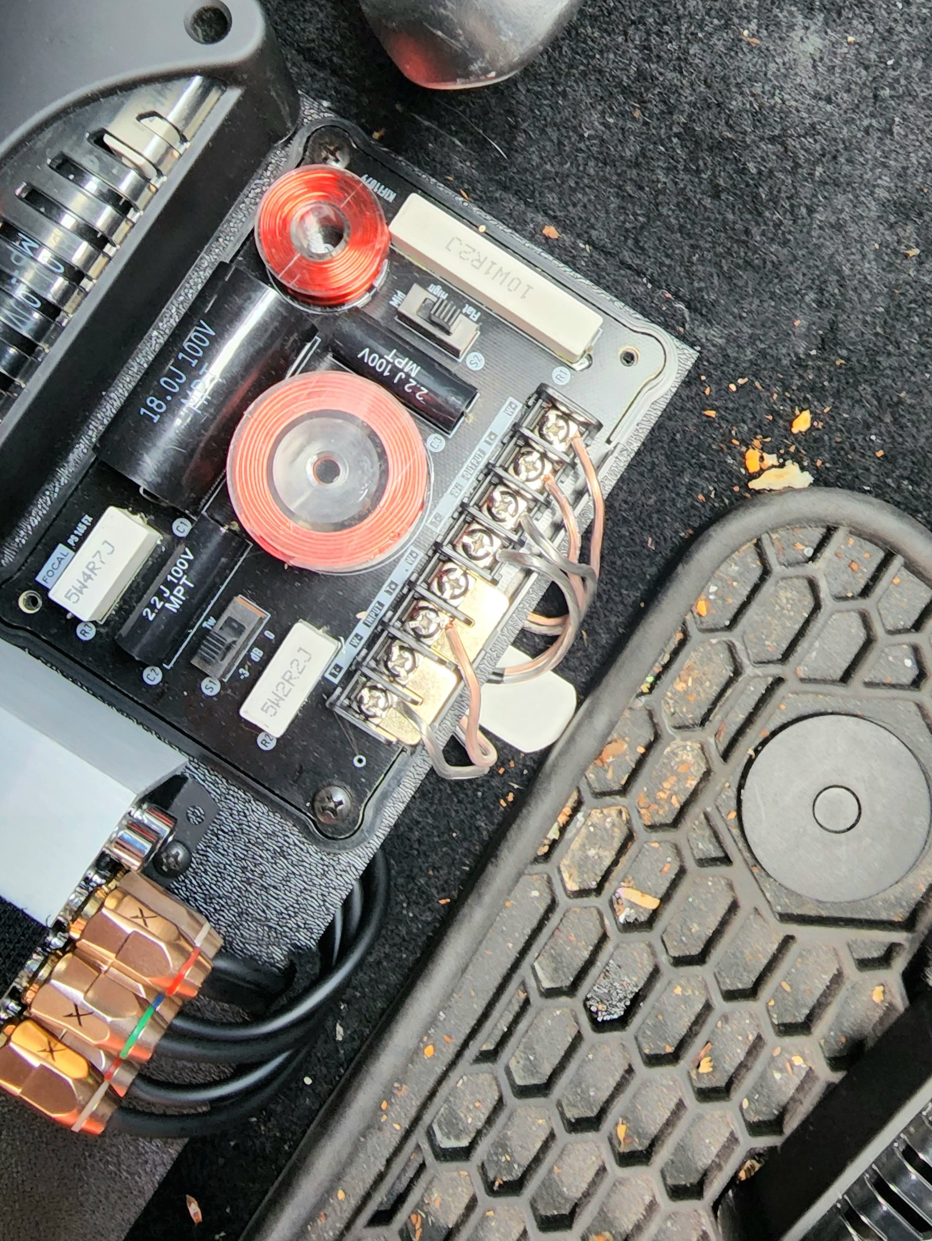

Here are some pics of the ground - I have been hesitant to take out any part of the car but at this point I'm willing to rip it all apart to get to the root of the problem.
Thats one of the Crappiest grounds Ive ever seen done for money. Self tappers..LOL and on sheet metal. What a Joke for hard earned money spent. Very Poor ground. Id be weary of the rest of the installation

I've tuned the mids / highs nicely up to a 40/50 volume. I've read it's best to keep the EQ from the HU flat when a DSP is involved, but I'd prefer to really dig into the DSPs tuning capabilities once I have the subs in a proper enclosure (ported ~ 32hz?).
