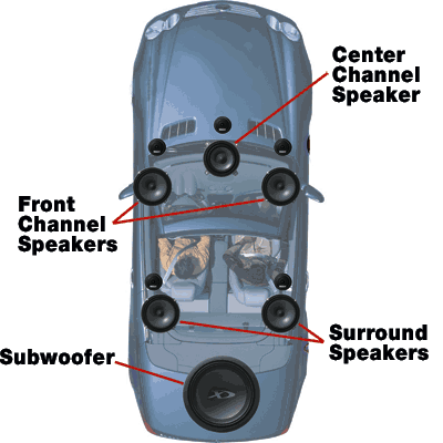

Multichannel sound reproduction is found in many premium factory sound systems, or it can be added with a DSP. The scope of this discussion is the way multichannel in the car is useful for getting better sound for 2 or more seats, not just 1 seat at a time. Some factory premium systems have a setting for the listening position, and if you've tried this you have probably heard a significant change in the sound. Some aftermarket multichannel DSPs do a good job of this; others fall short. Aftermarket head unit manufacturers have tried 5.1 surround sound, although a "listening position" setting is much more common.
Improving the sound of music for more than just the driver's seat requires 2 front left and right speakers, a center speaker, 2 rear left and right speakers, and a subwoofer. Some form of multichannel digital signal processing is required, and the DSP needs a way to "upmix" 2 channel audio into 5.1 "better stereo". Obviously the speakers all need power from an amplifier.
