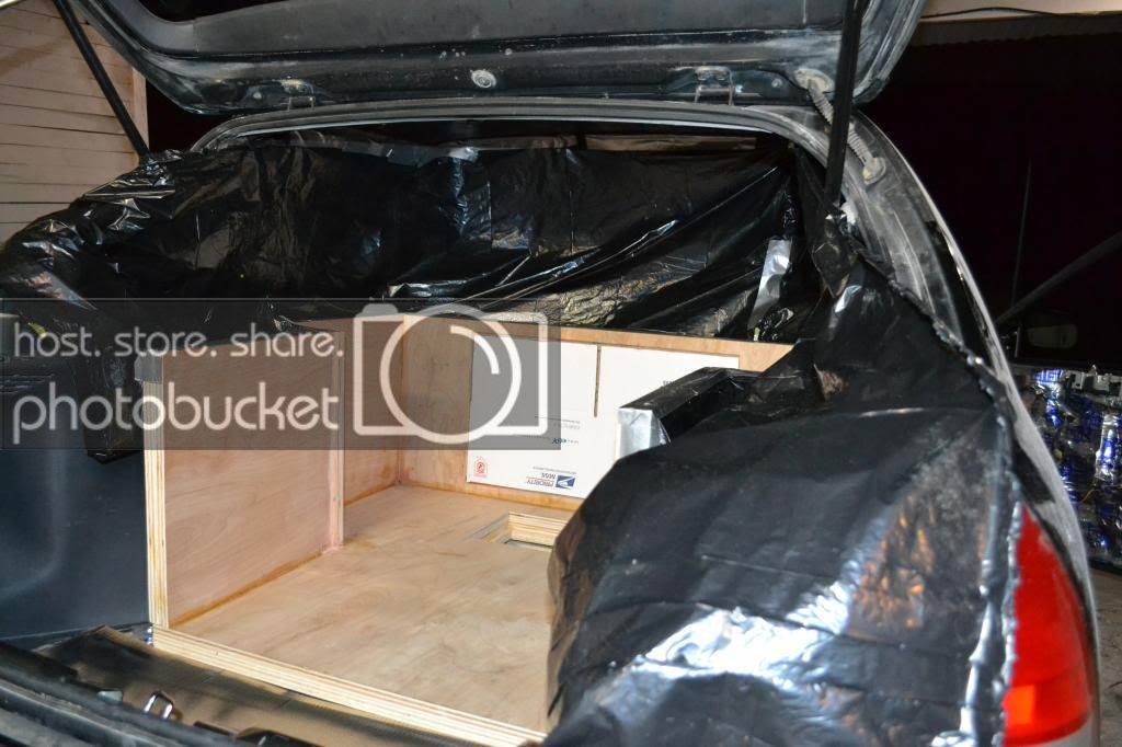

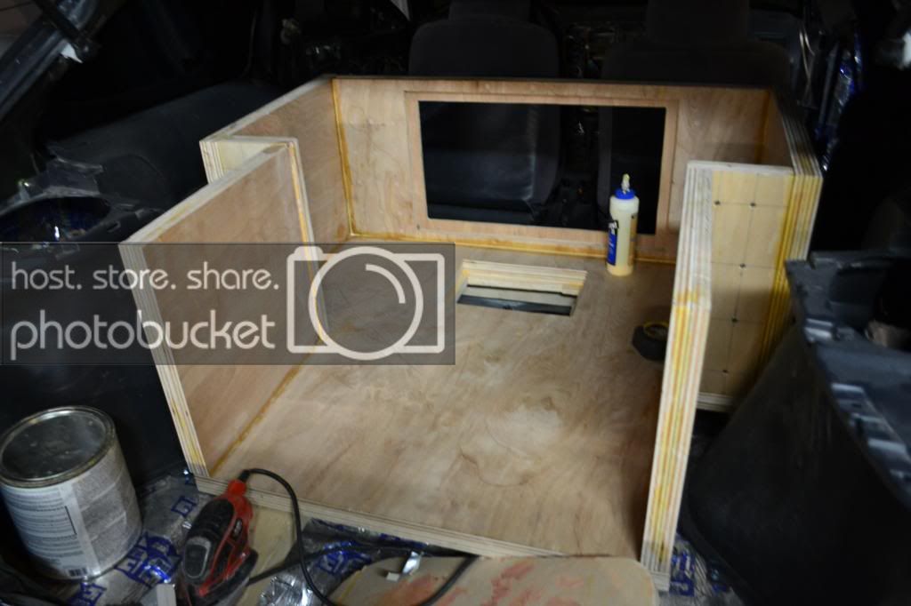

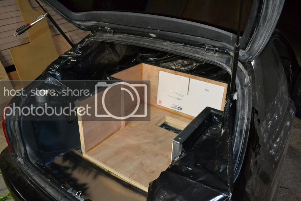

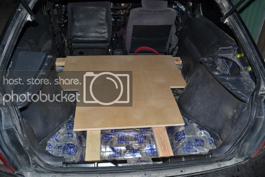

Decided not to use the false floor as one pics, still gomna cut it up and use it on the sides though. Test fitting the bottom of the box

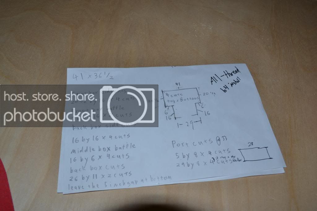

Box design, 10.13 cubes with the daily port at 31 hz

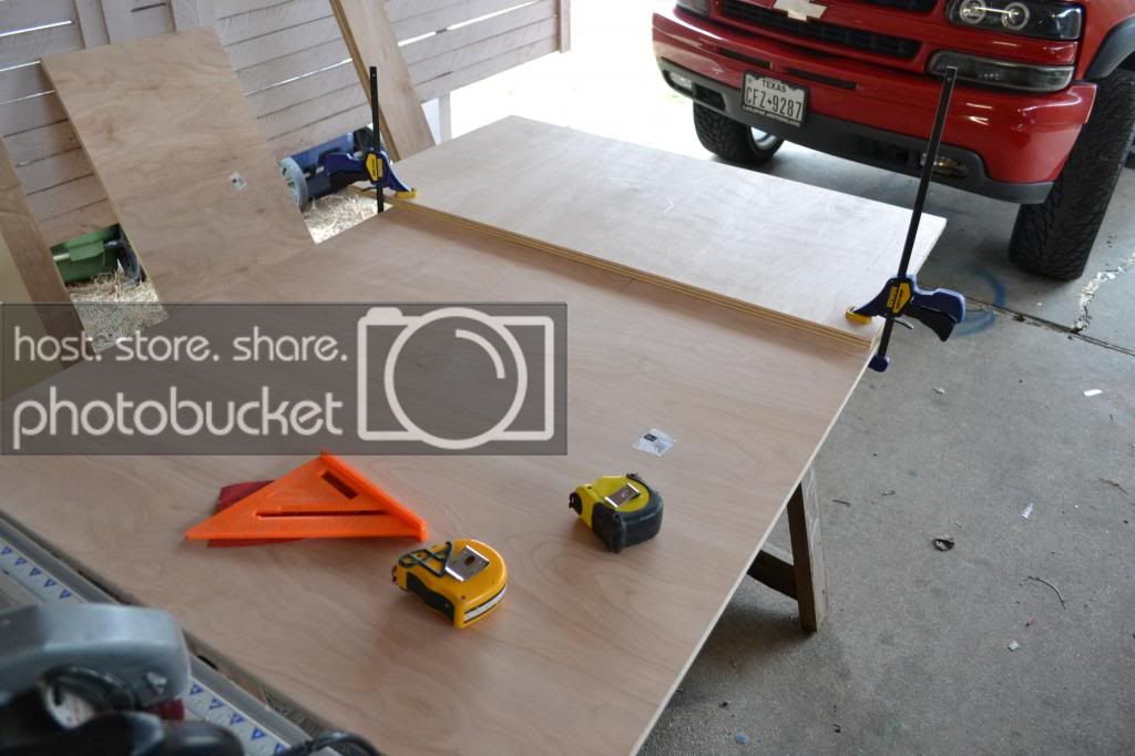

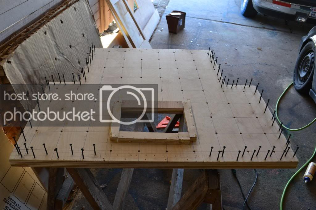

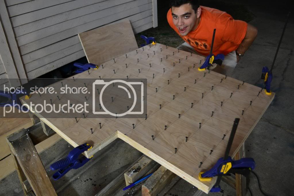

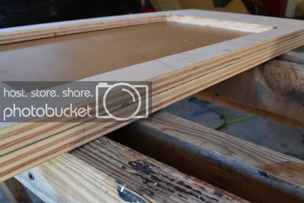

Box is double layered everywhere, gluing and screwing it together

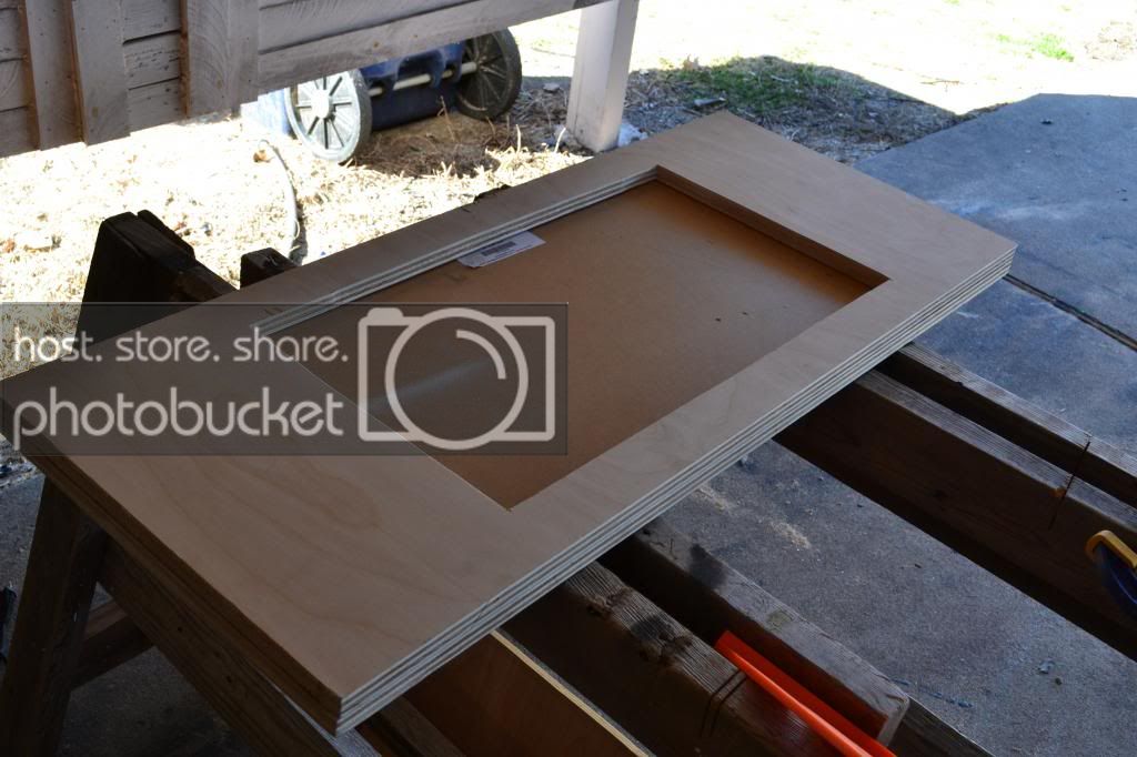

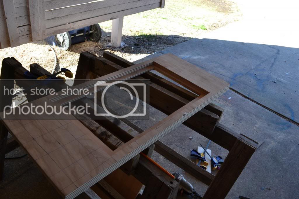

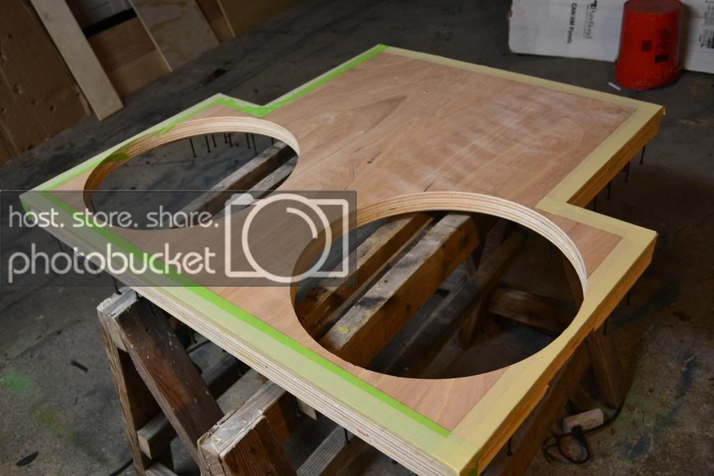

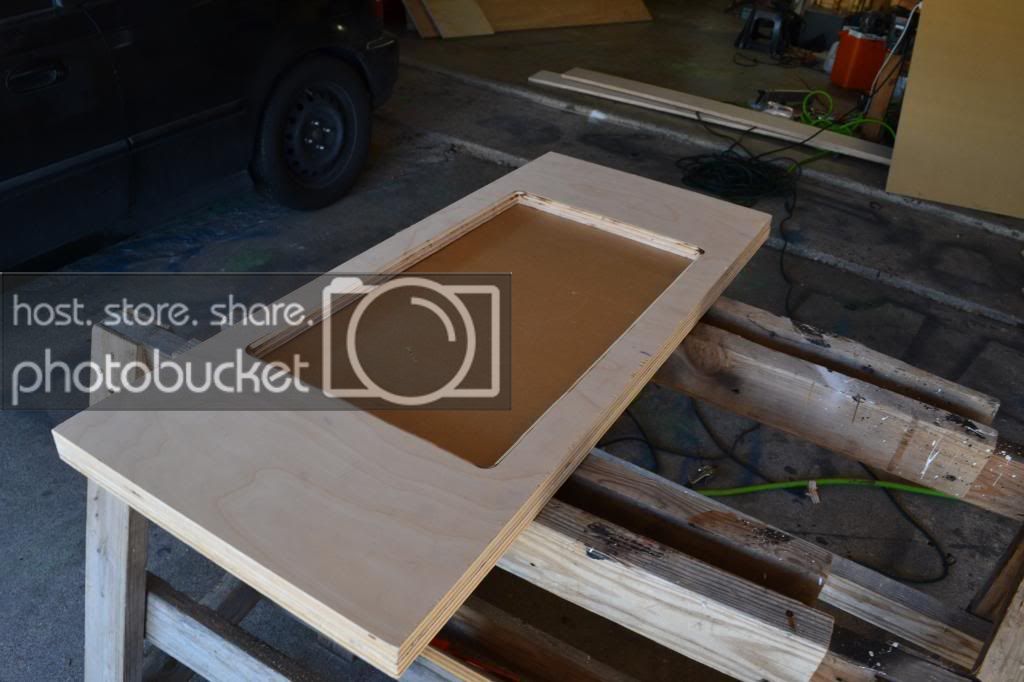

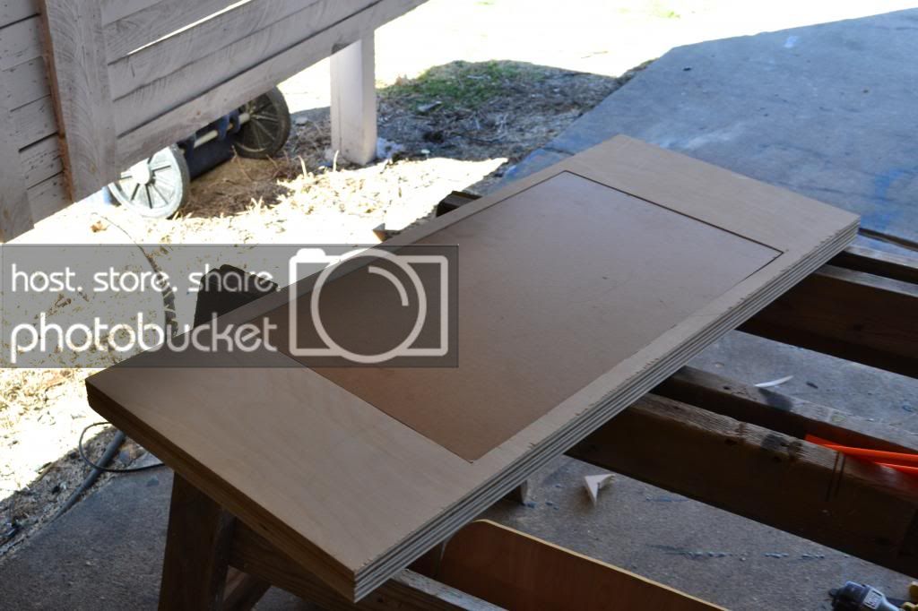

Front face of the box cut, and plexiglass flushed in

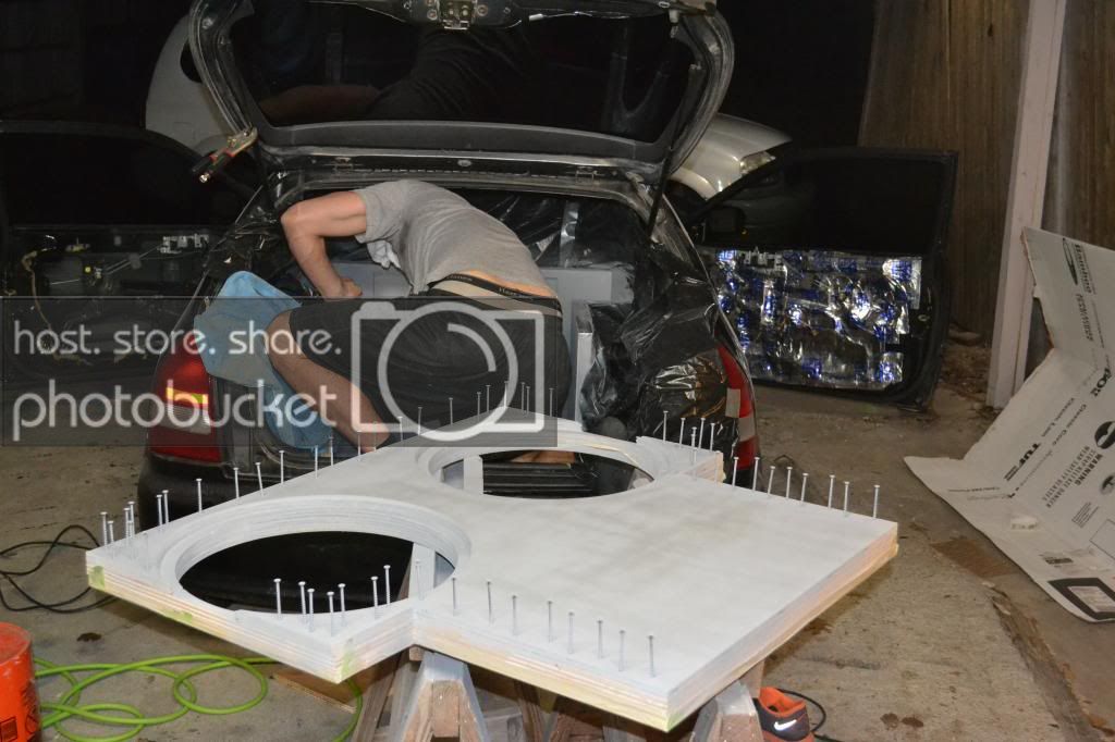

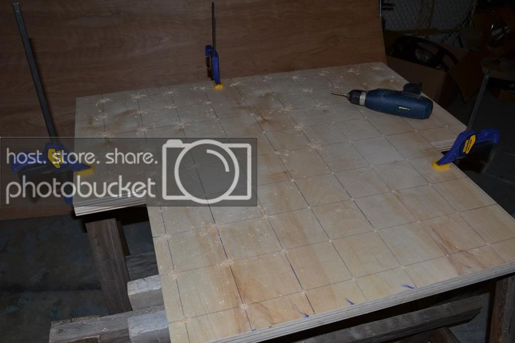

Gluin n screwin
Lol my friend tanner helpin me, holy screws?

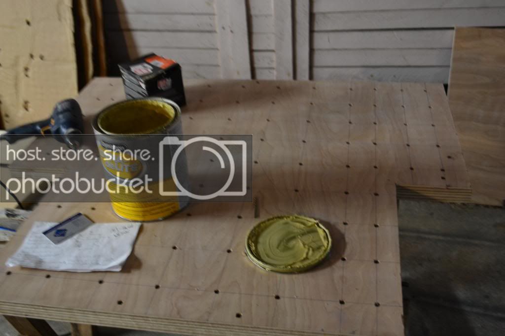

Filling all the screw holes

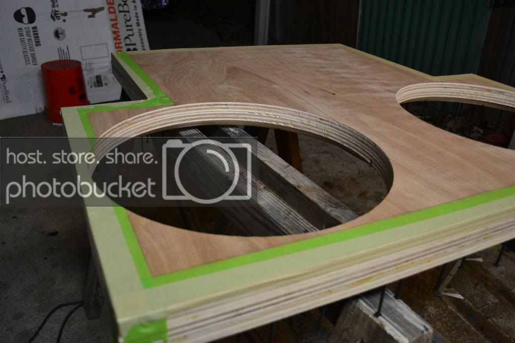

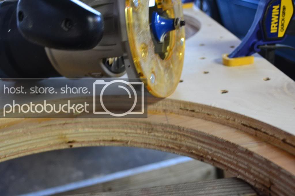

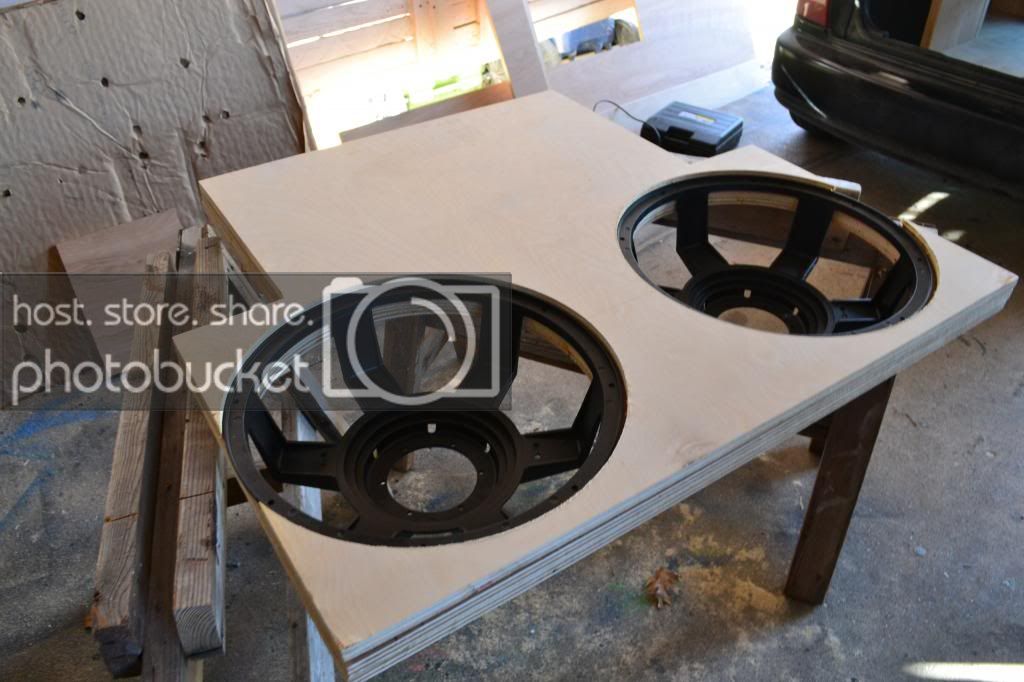

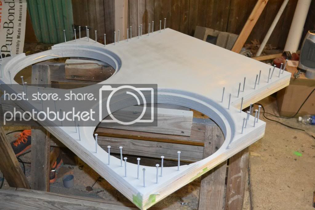

Double baffle with a flush mount 3rd baffle
Time for a round over

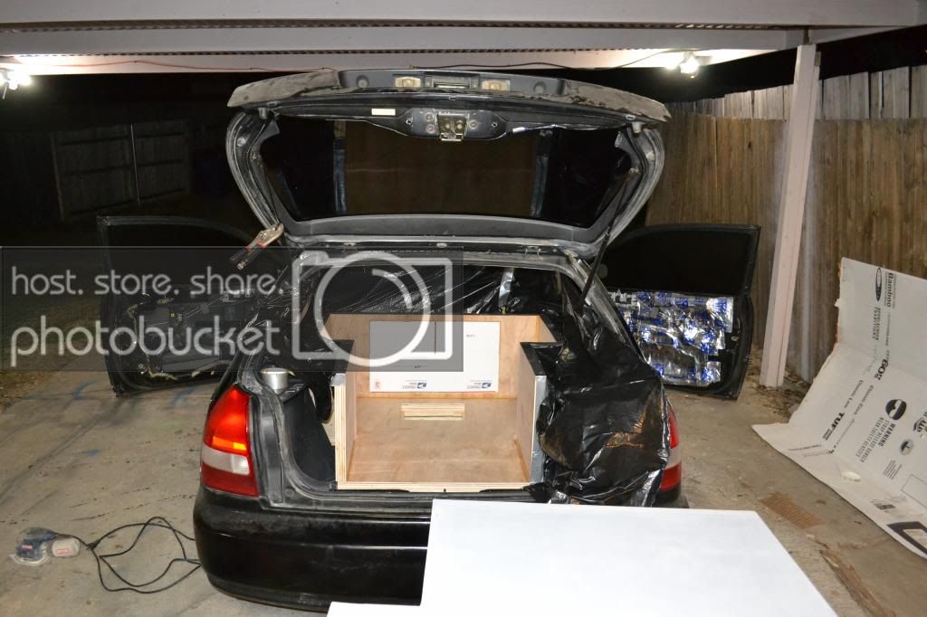

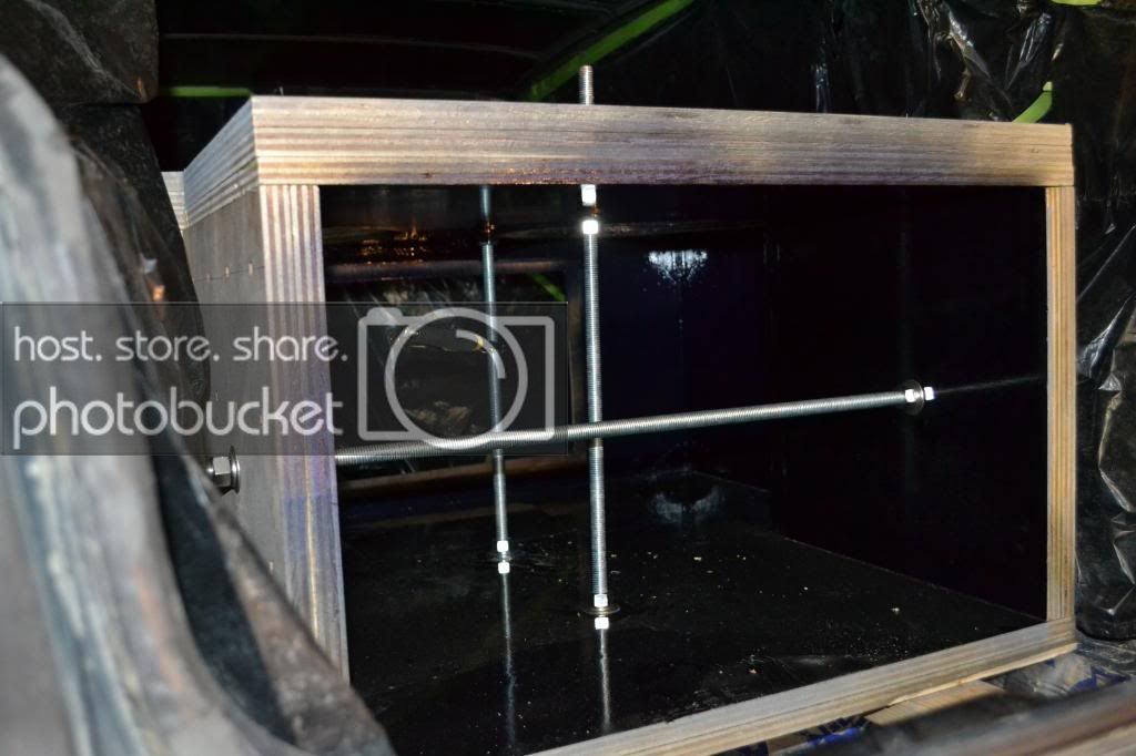

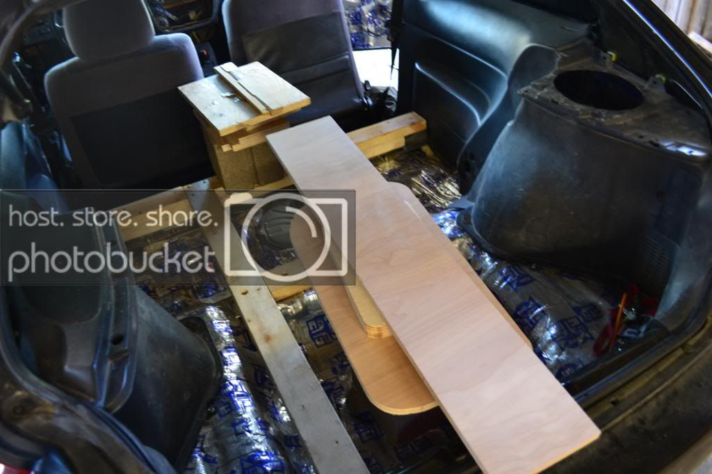

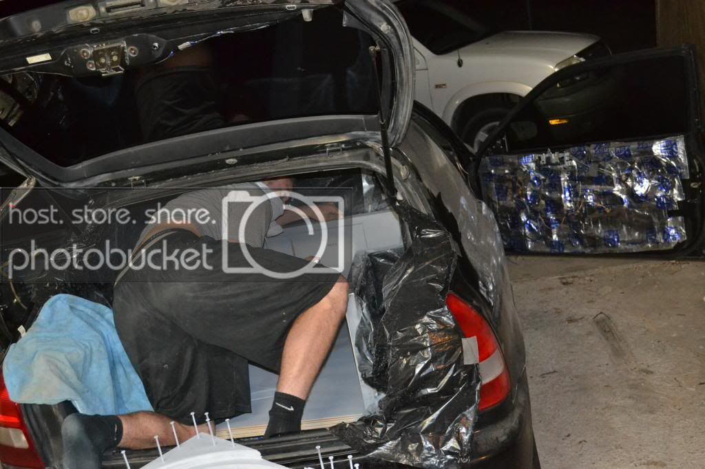

This box had to be assembled inside the car, I don't have a keg jig so I had to screw it together from the bottom, I rested the bottom of the box on some cinder blocks and screwed it together. It ******* suckkkkkkked, the BS cut wood in the middle is where the removable fuel pump plug will bolt into, it was the only scrap wood I had lol so I made it work, want be seen and will do the job just fine so I'm not worried
My bullshiiiiiit rigged up "stand" for the box if you will lol
Box in

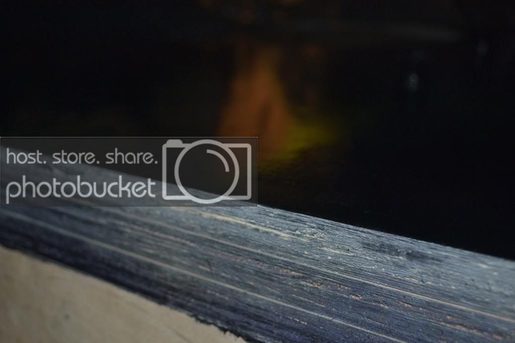

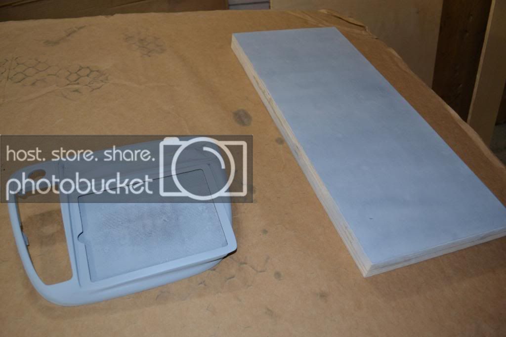

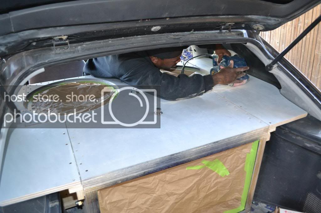

Sanded from 120, 220, then 400. Wood was soooo **** smooth it felt like glass, taped off, and ready for primer

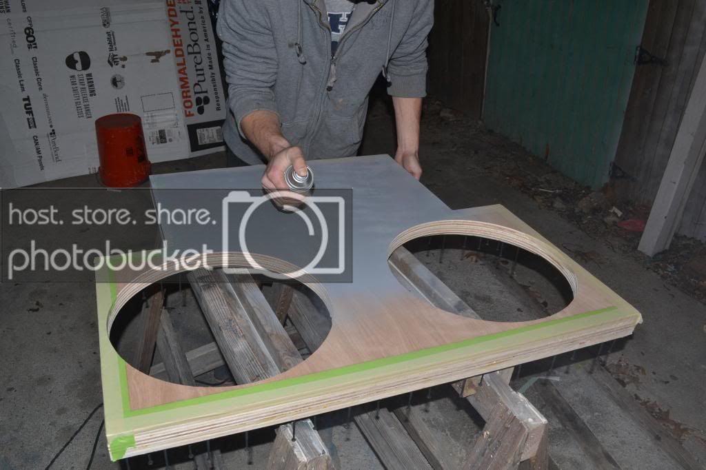

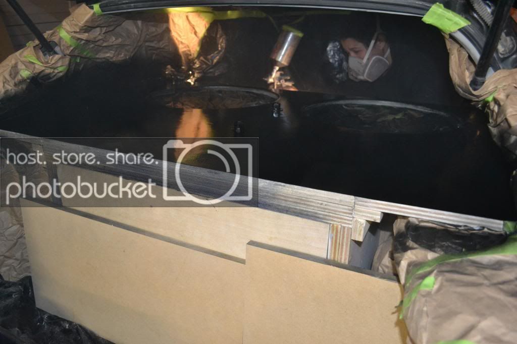

Laying down primer
Taped off the car to primer the box

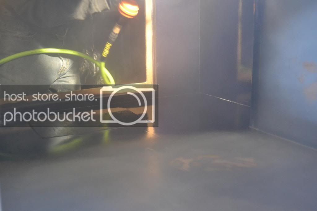

Me inside the box gettin some primer laid down
Top of the baffle primered
Second coat of primer

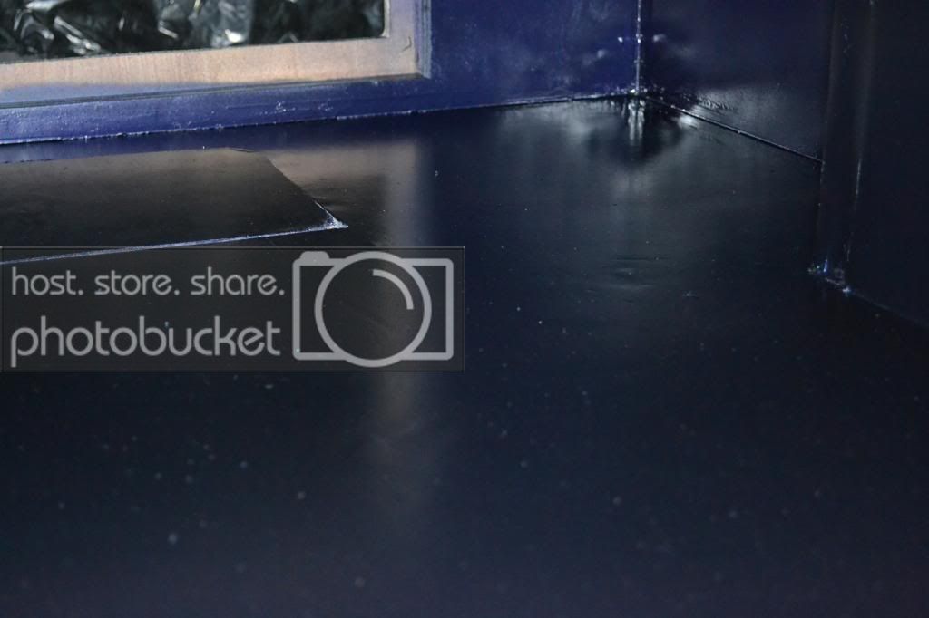

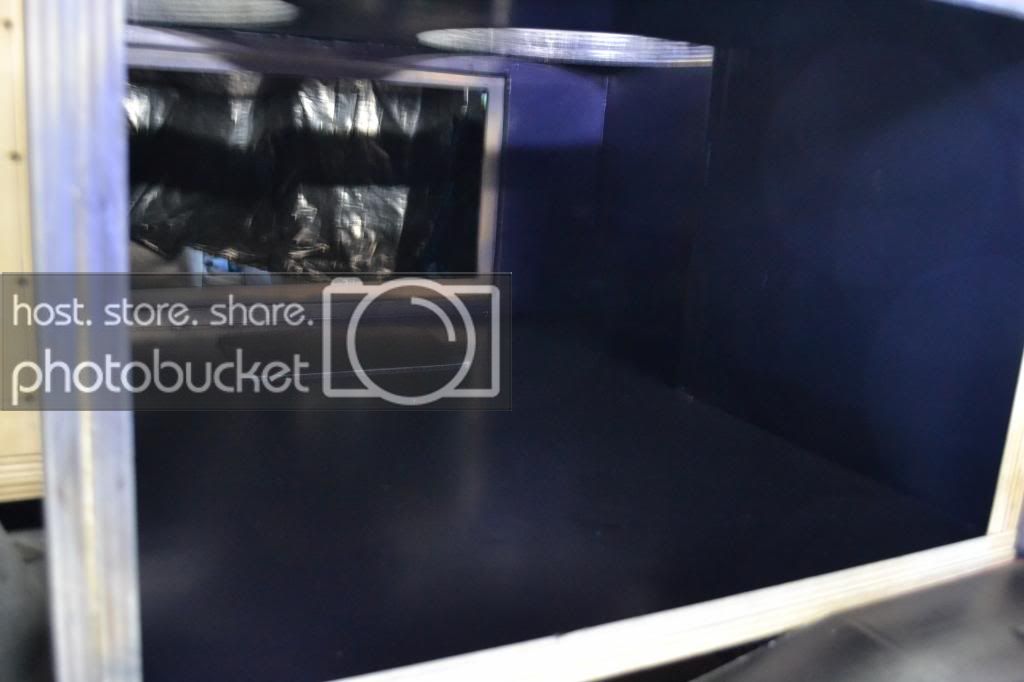

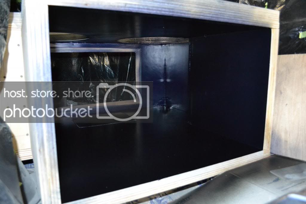

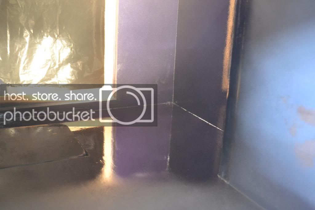

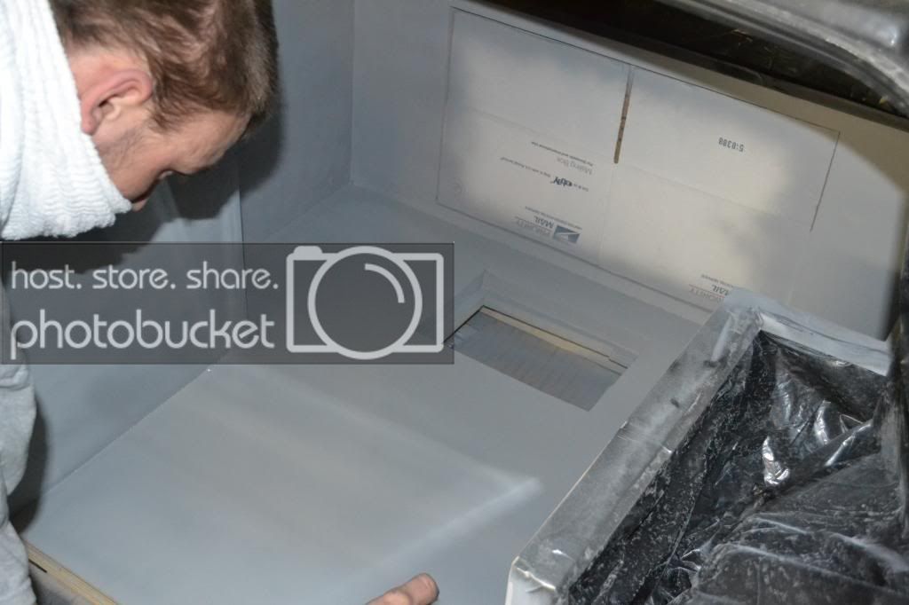

Finished off wetsanding the inside of the box with 400 and 600 grit, it was super smooth. Looking forward to paint:)

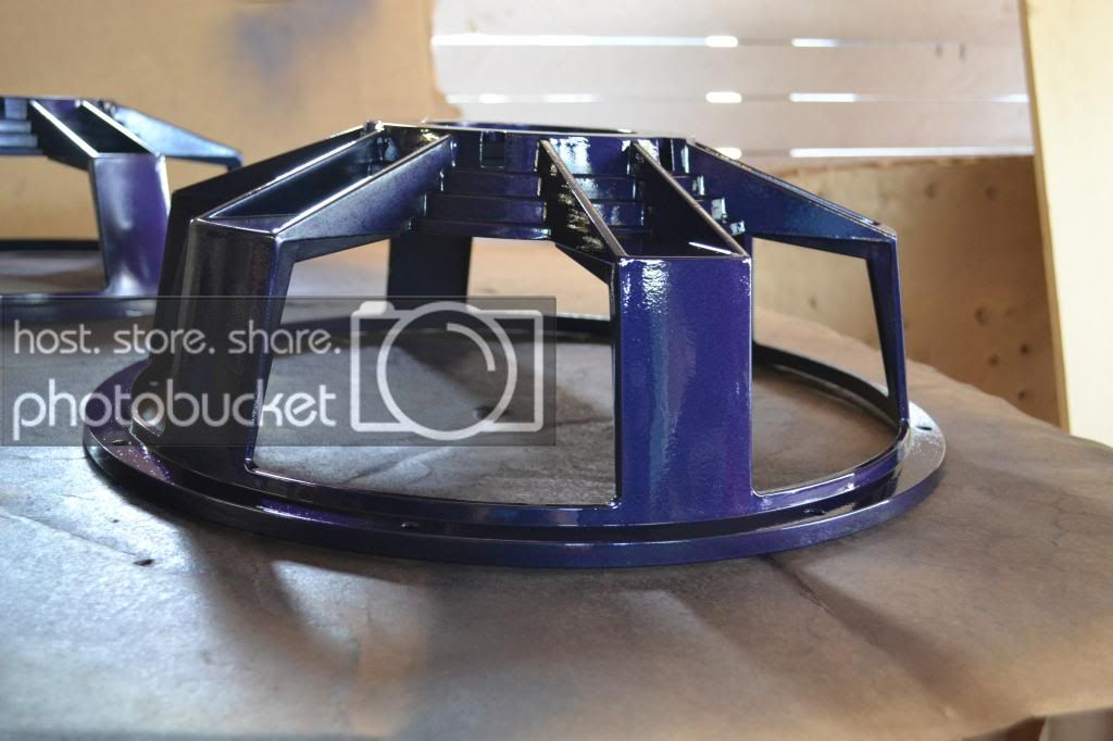

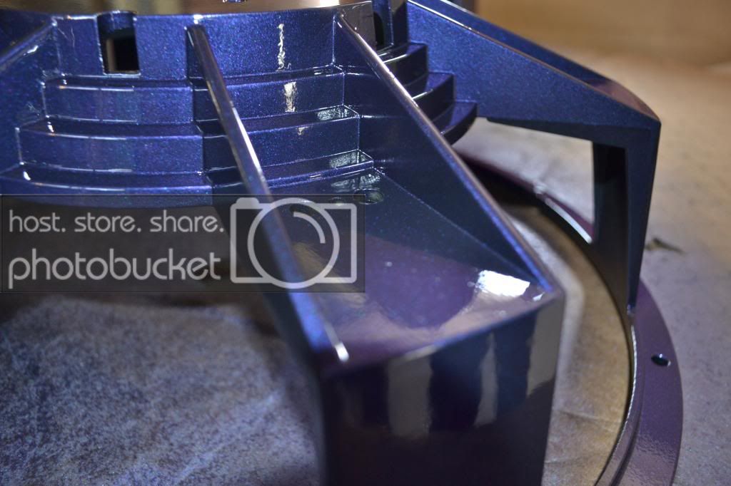

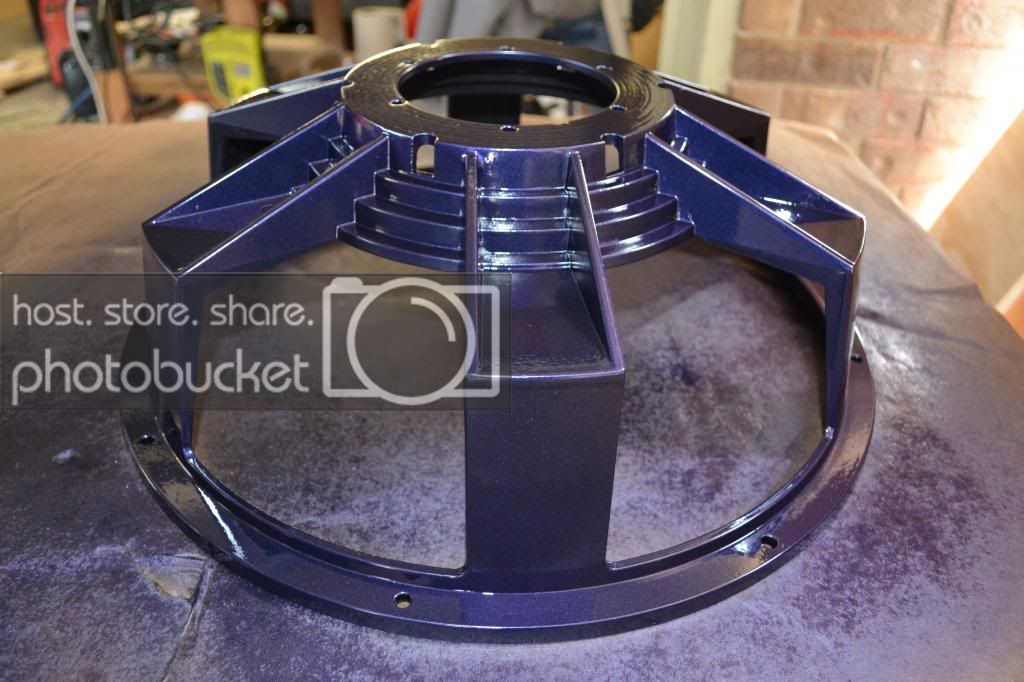

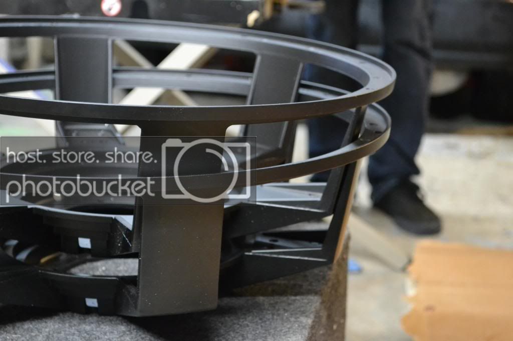

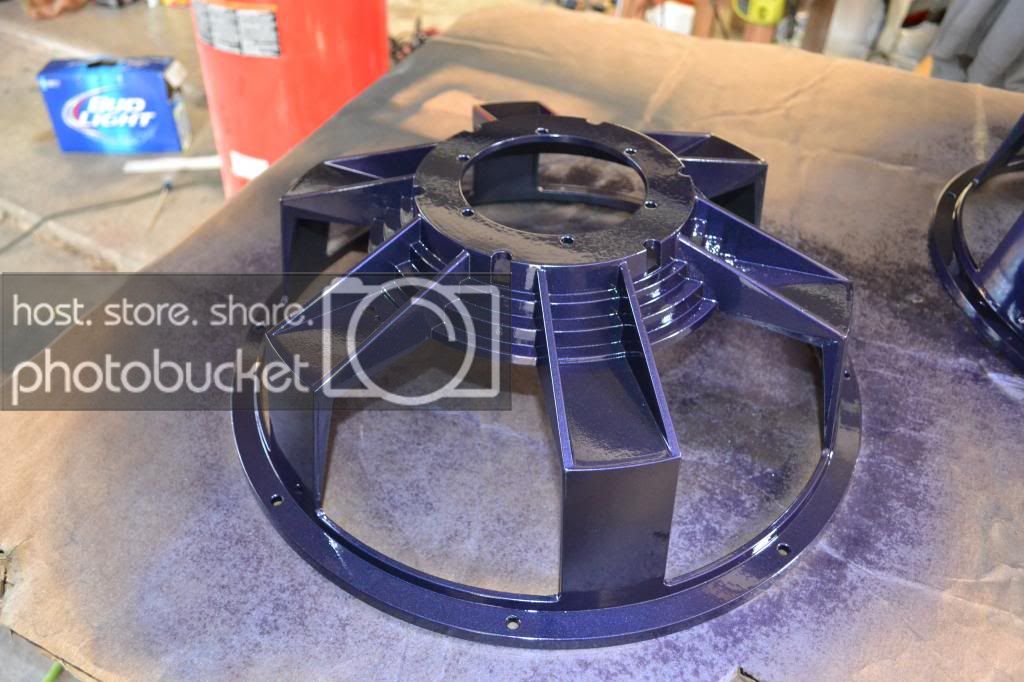

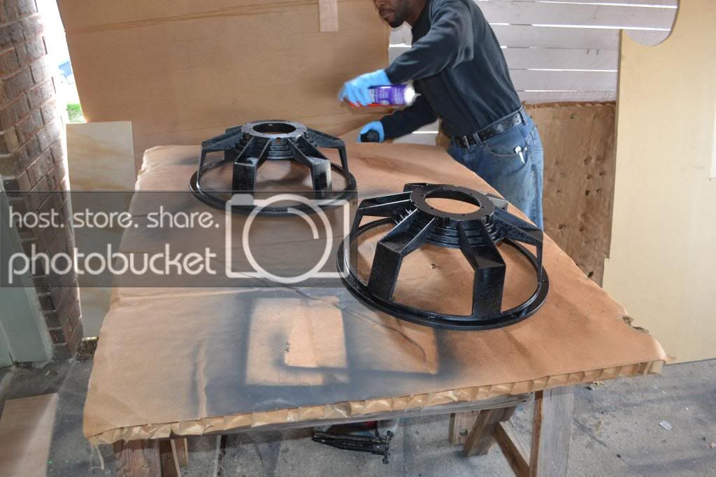

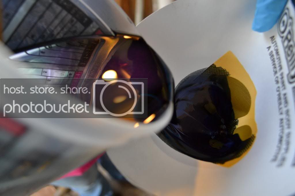

Prepping the baskets with bulldog adhesion promoter, these were sanded with 400 grit
Mixin up that purp
Good friend of mine, Cj sprayed the baskets and box for me, he did an amazing job
After the first coat
Second coat
Base color done

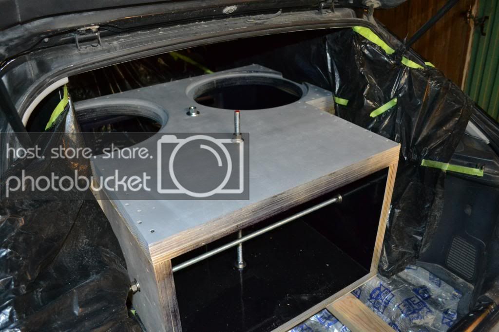

No pics of the clear at the moment, 5/8 all thread in place
Was such a pain in the *** to do this, should've done it before I started painting but didn't think about it

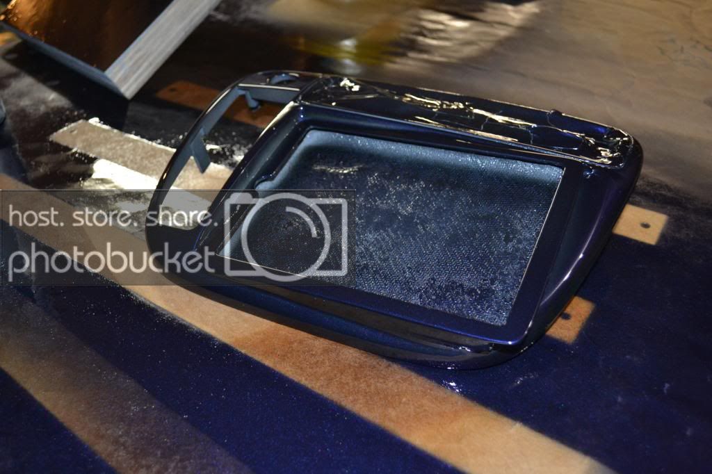

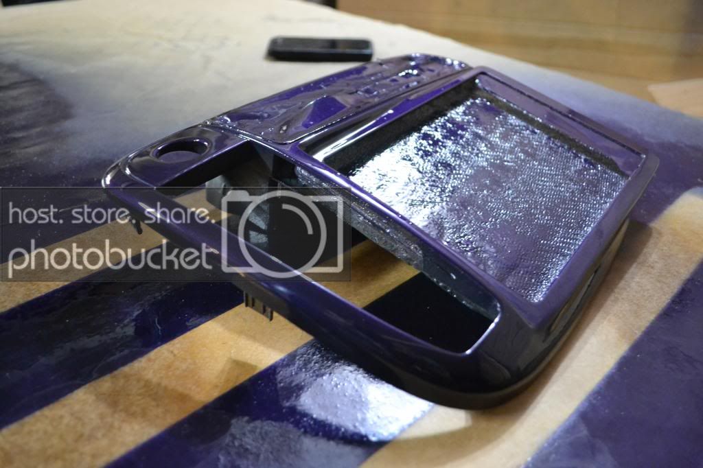

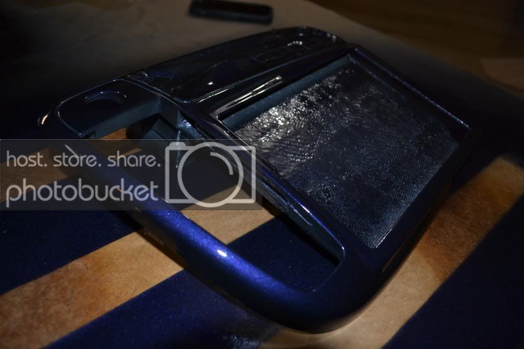

iPad dash and rear of the box getting prepped for purple

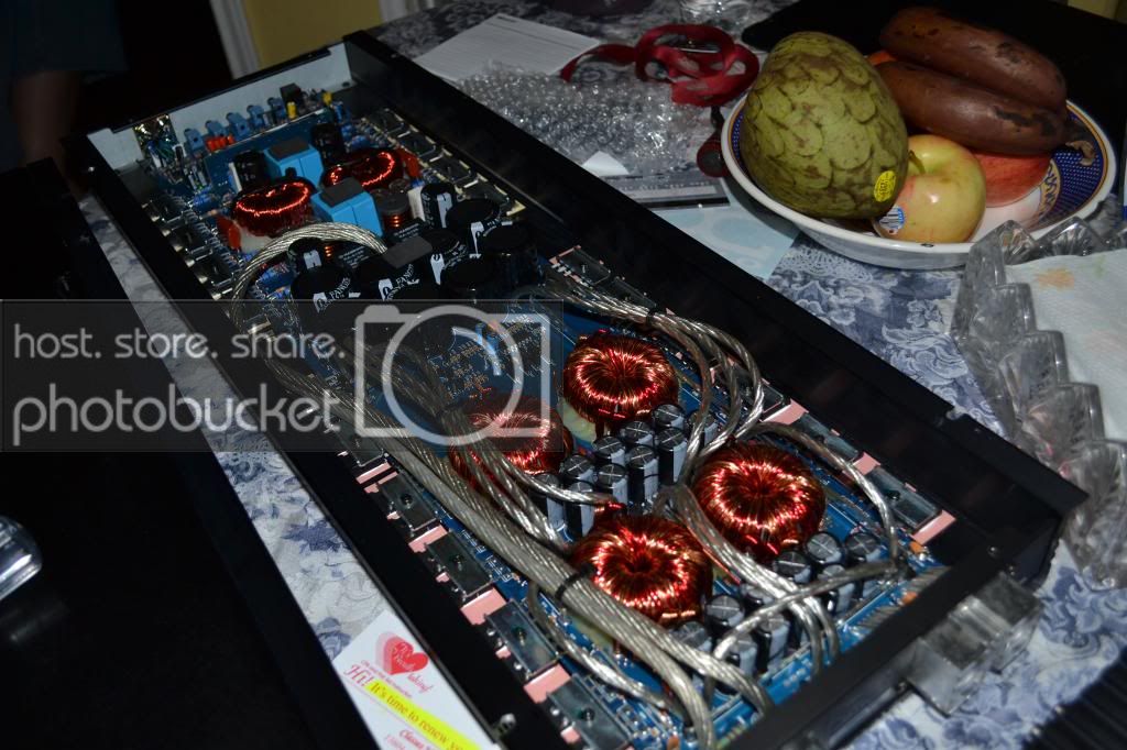

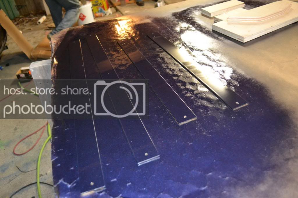

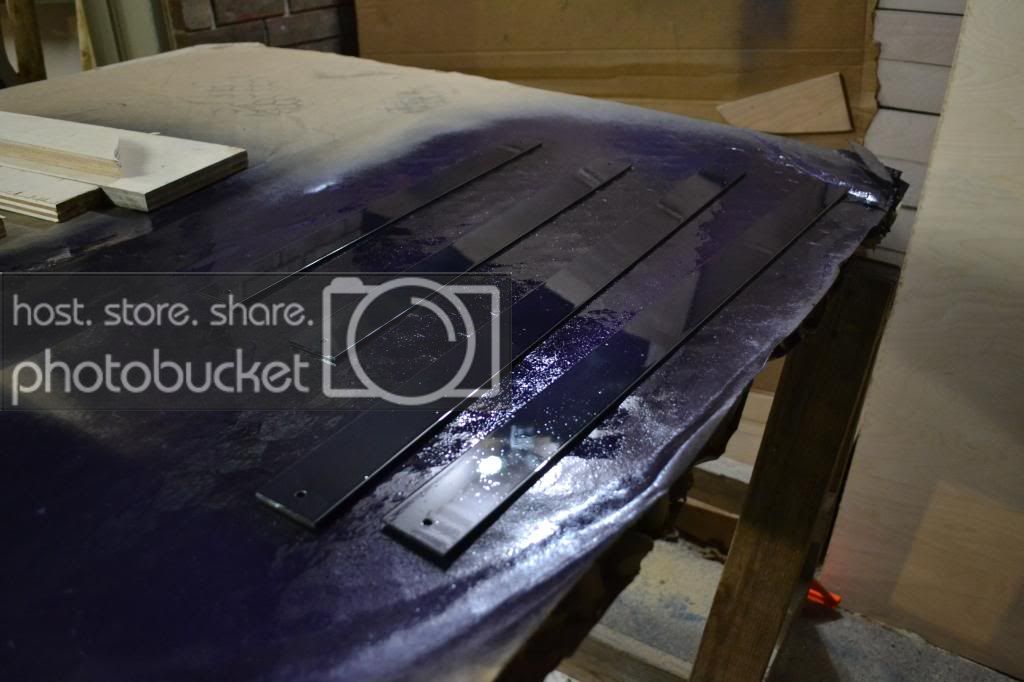

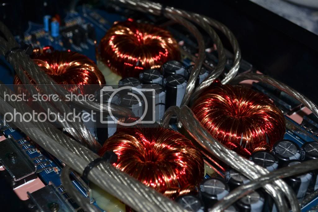

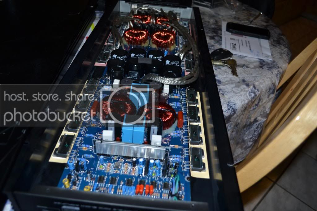

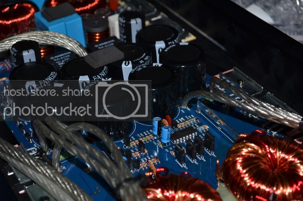

Aluminum bars on the ampere amps, I painted the under sides of them do that if I ever sell them the top will still be factory, there will be white vinyl "ampere audio" stickers on these
iPad dash

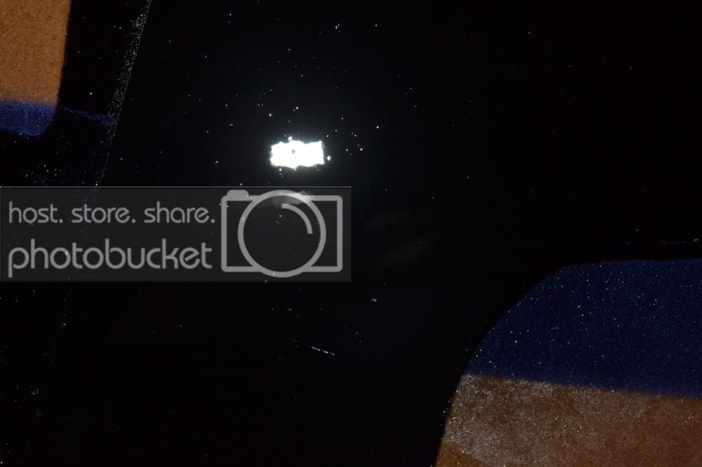

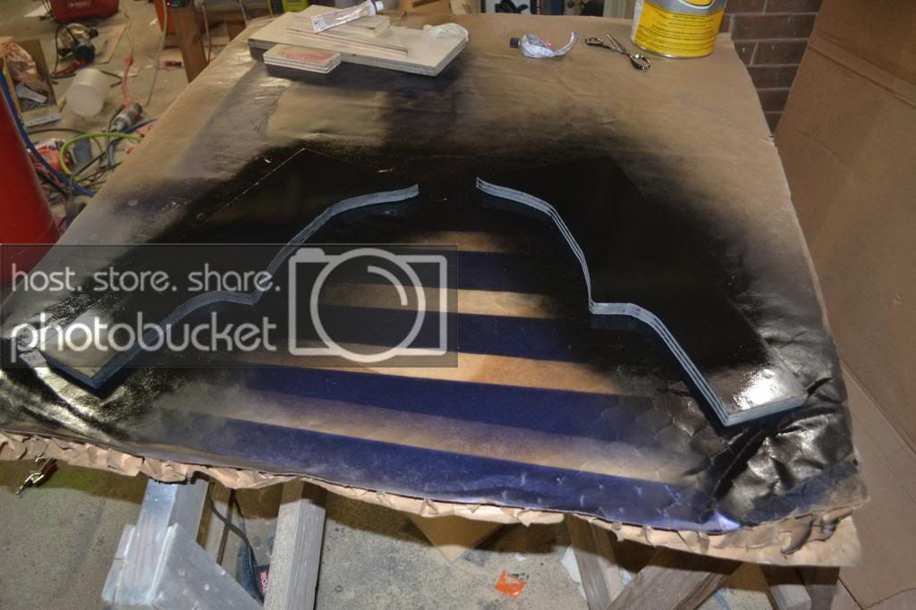

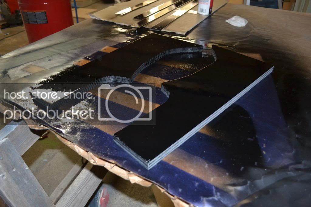

Outside of the box is all glossy black

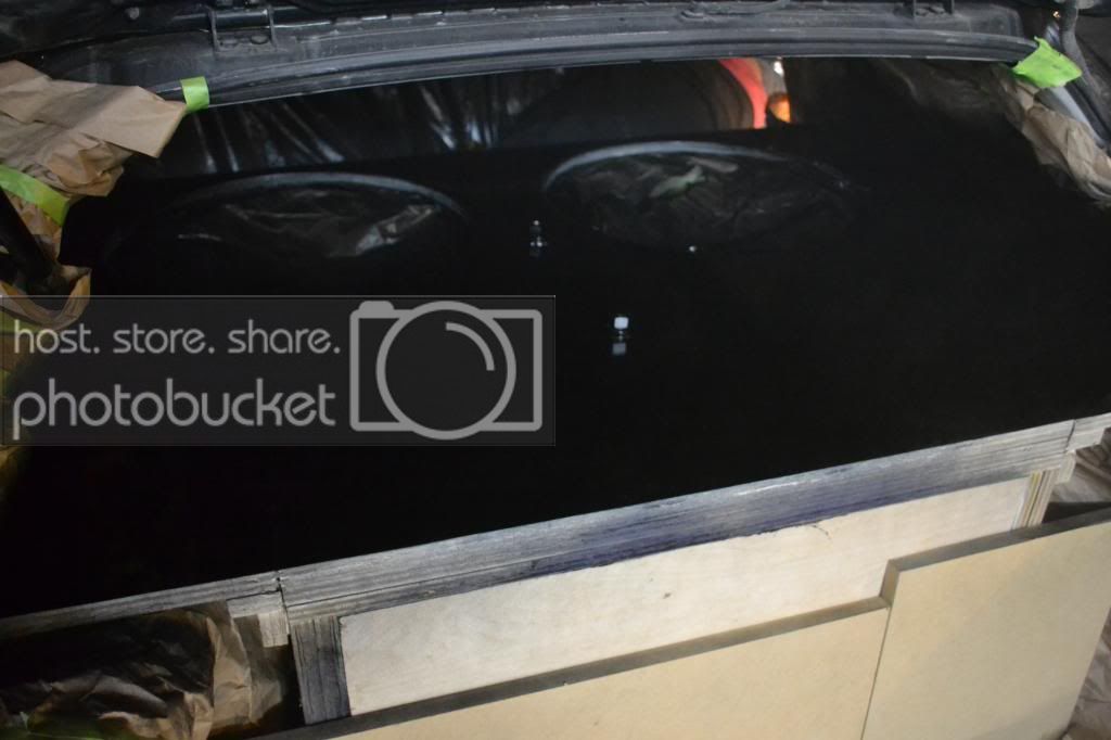

Box done
Just need to build a rear trim beauty panel, for the back and the floor, along with my 3 ports and it will be done. The floor will be carpeted, and the rear beauty panel and port will be painted to match the box
