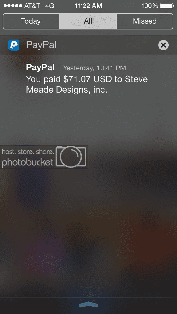

heres a pic to hold you guys over until then, Ill be starting some small parts of the build soon, stay tuned!
