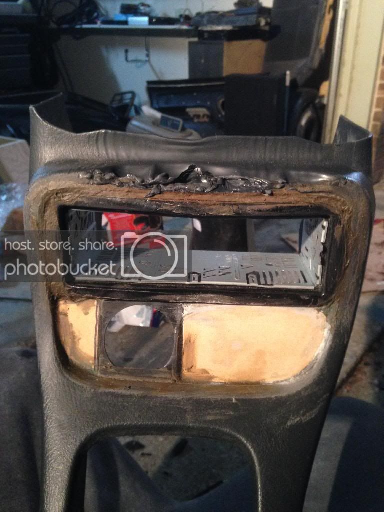

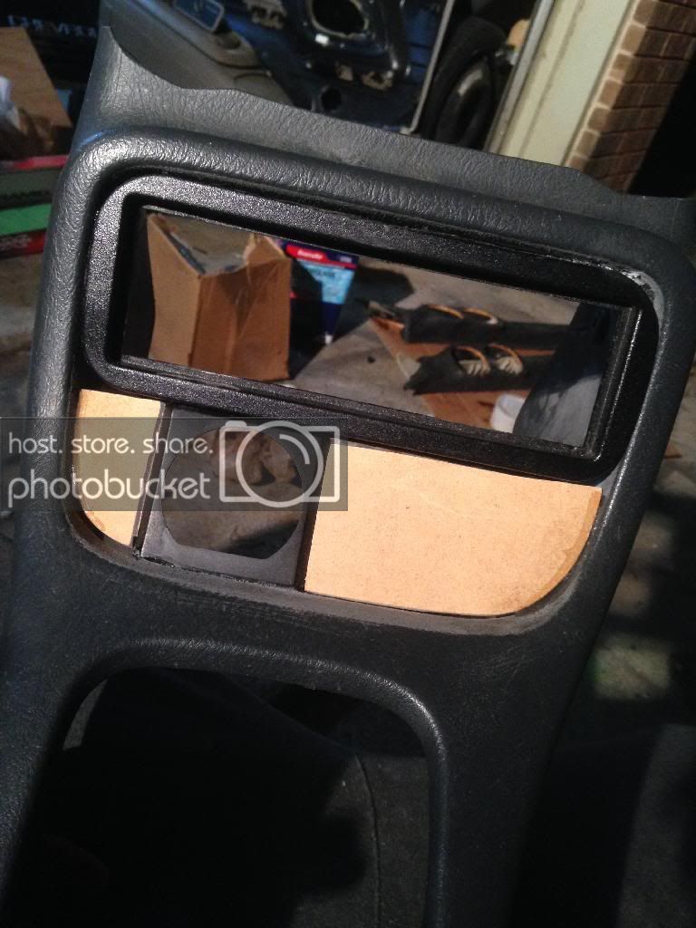

start of the console, this used to be a CD holder and BS cup holder that would hardly hold a coke can, worthless! so i modded it to house my 80 prs and smd OM-1 to make room for the ipad in the dash.
sizing it up

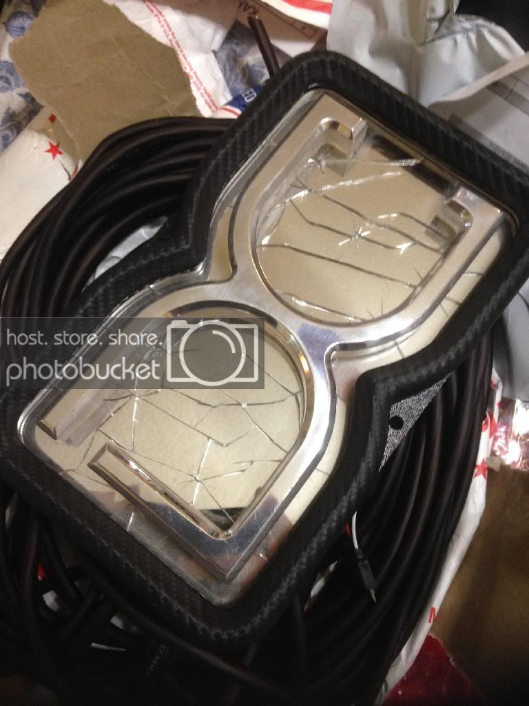

it was cold as hell so i had it close to the space heater, went inside to take a duece and when i came back outside i found this, **** near ruined the whole thing... oops
brought it back though, plastic welded some abs in there then used a lil bit of bondo to shape it back correctly, pain in the a$$.. stupid mistake on my part
getting there

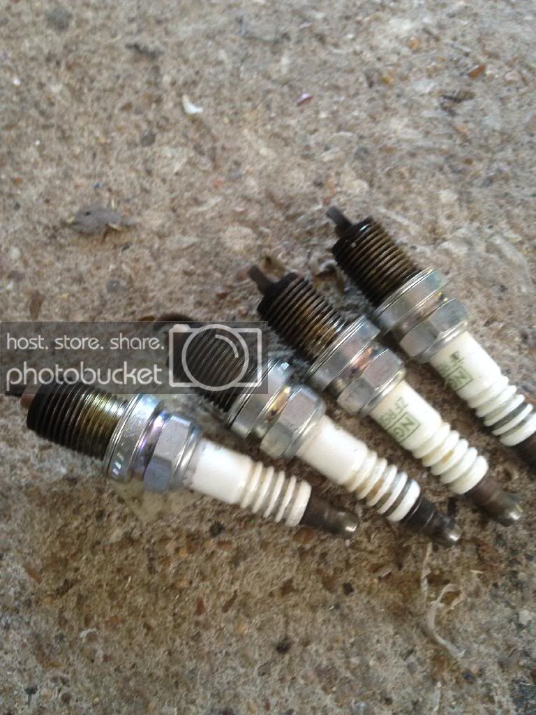

bish needed a tune up so i changed out all the plugs,dist cap, plug wires, oil, did a cold air intake, few other things..
plugs were nasty
yikes!

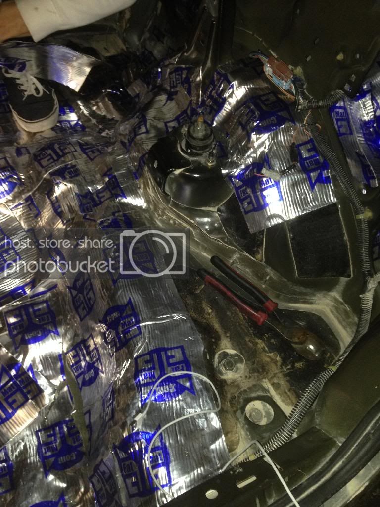

deadener
deadened the ***** out of the hatch

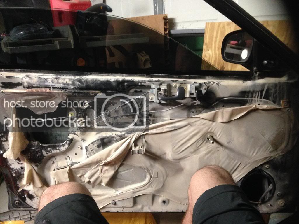

took off the door panels to begin removing the manual doors to find this... the car was swimming at some point in its life for sure there was so much dirt and sand i vacuumed out of this car.. oh well, nothing i cant fix,but i got new doors all together with better paint and all the electric components inside so i began swapping that shiz over
beginning of the door swap
door off

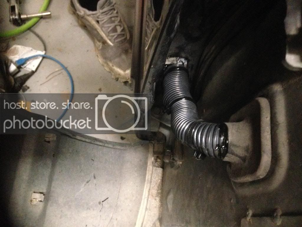

had to make my own harness, routed it through the door with loom and cust the grommet, did alot of silicone on the back side to keep moisture out, its actually looks pretty close to factory.
all tip tied and glued
buttoning everything back up

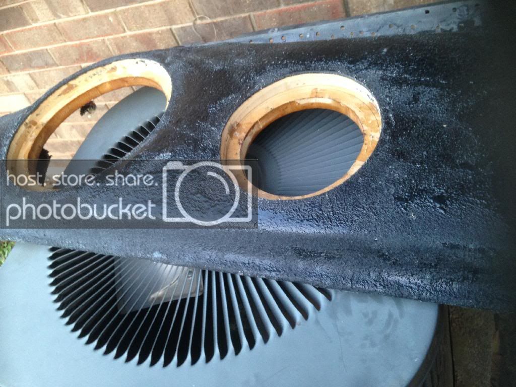

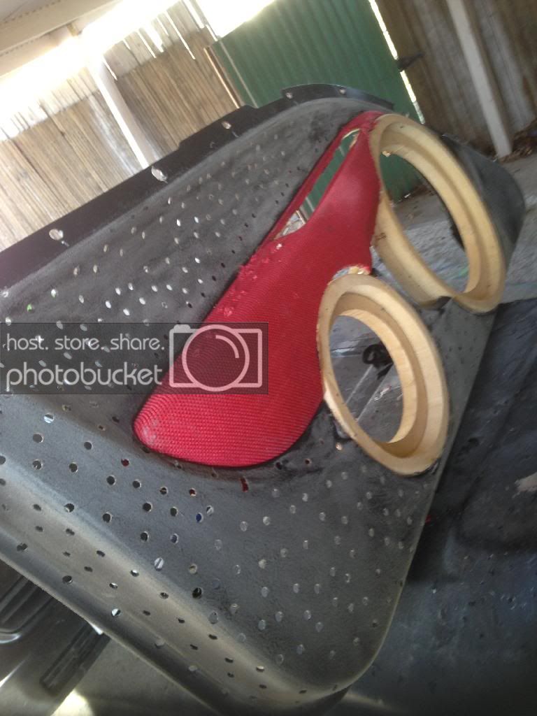

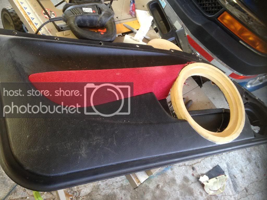

10" ring in place, i want these to be flush like the factory panels are, they will be wrapped in tweed and look **** near stock.
anarchy ring in place, both flush mounted
holes drilled so the resin will seep through and grab onto the plastic
wrapped and resined
other door
used amazing goop to secure the rings to the plastic, used two tubes of that stuff, it cures hard as a rock the rings arent going anywhere!
resined and trimmed out around the rings

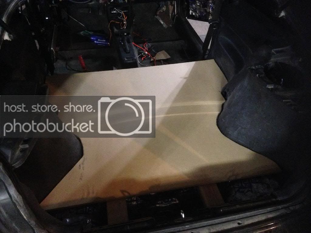

started building the floor, framed out with 2x4s
frame done

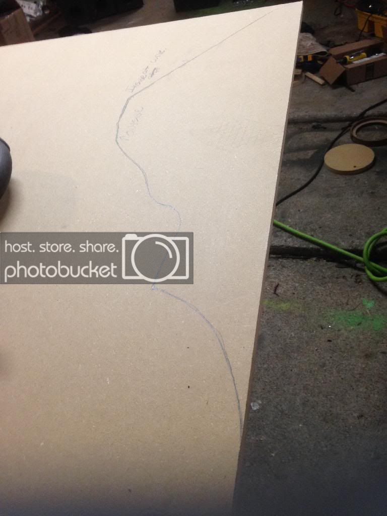

started doing a template out of cardboard to follow all of the contours
traced it over to teh mdf

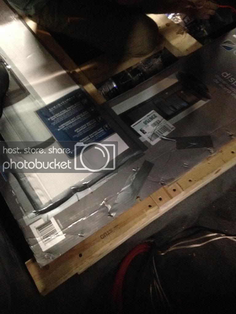

cut out
got it all in, in one piece! came in though the driver door, gonna build some of my box outside the car then slide it in and screw it all tofether, will be much better than building it all in the car

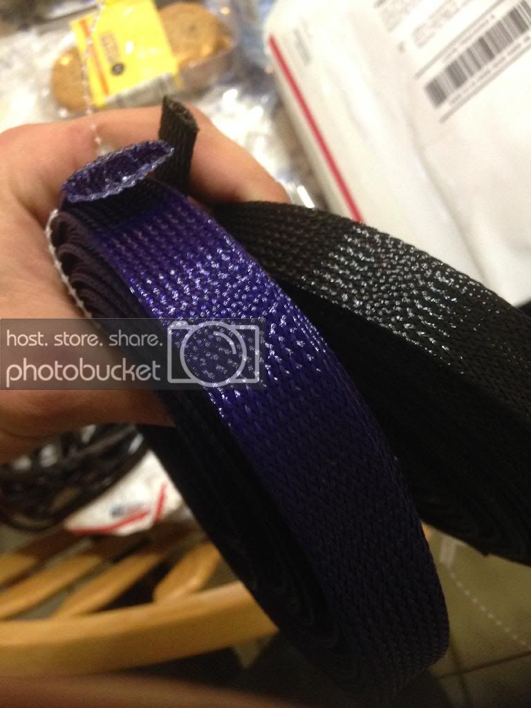

techflex for all my wire, will look really clean and nice
