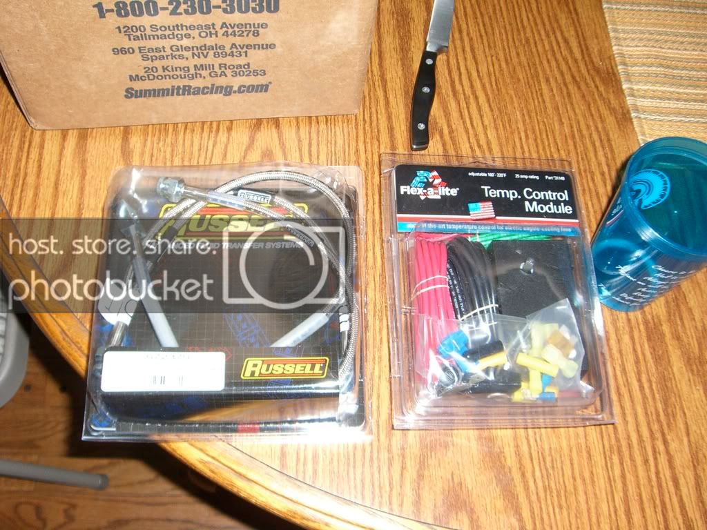

WELLL ive decided i cant stay home from work anymore. I did today for my first weekday off work all summer. I spent wayyy too much money.
I bought:
Front and rear gears 3.73 and master install kits
Truetrak for the rear with necessary HD bearings
LS1 E fans and flexalite new controller
New disc brakes up front by rotoworks w pads.
Russle ss brake lines
Line of fire led for the back
new black carpet
anddd por 15 marine clean and metal prep. Big spending day for me. Pretty much setting up to get all this done in the next month before school.
dang, thats a killer, but gonna be sweet when its done. I did a double take when I read front/back gears, totally forgot your truck was 4-wheel drive. The locker out back sure will be nice.

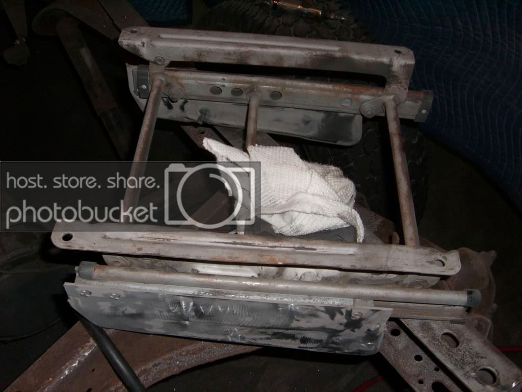

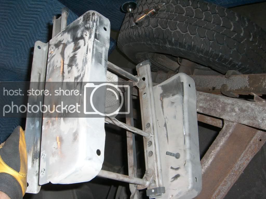

well spent 1300 today on the truck on the new parts then went out and worked for 2 hours on one seat mount. I finally took them off and am gettin them ready for final install and i drilled the holes for the other side of the seat... only had one side mounted for the day that i drove it. Tomorrow i think the rear end is comin out. well see.
First thing my dads gotten me for this build and by far one of the most needed.
And some pics of where im at on the driver side mount... this stock paint is like concrete.
