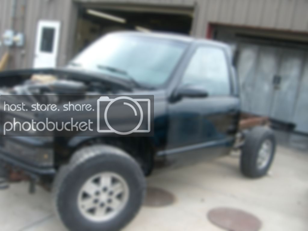

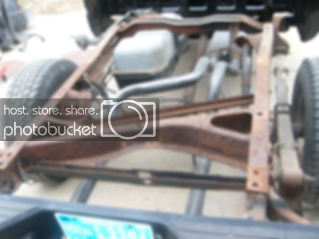

Got it up on the rack today and started stripping it down.
I got the bed, pass side fender removed.

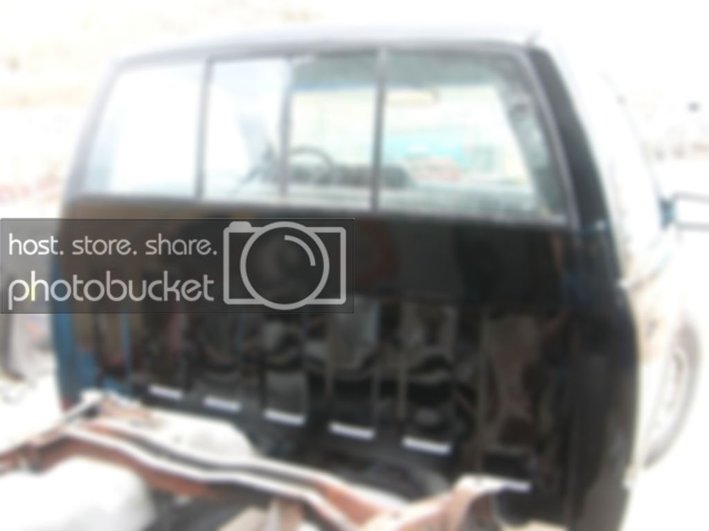

Ok Got the cab corners and rockers glued in. Had to make new backers for them also.

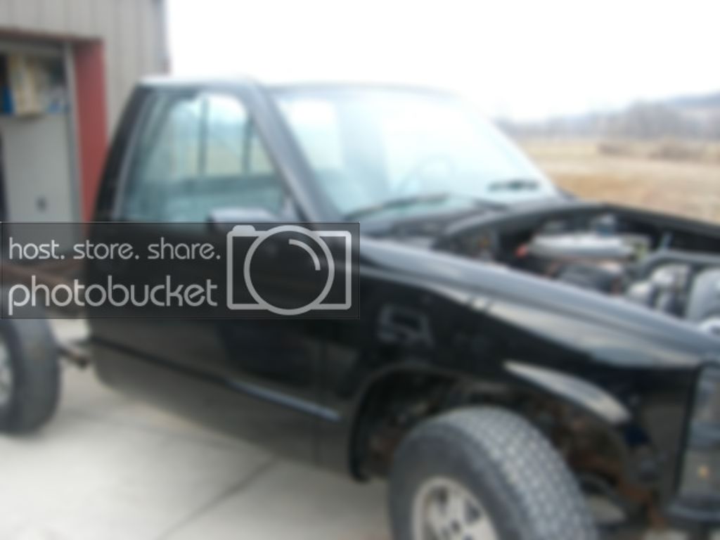

Used the stud gun and got 95% of the damage to the front of the door out. Filled it and also fixed a couple other dents while I was at it. Then sprayed some primer on it and guide coated it.
After blocking, filling, blocking, filling, blocking, filling again and again my arm fell off:luke: But the dented pass side fender was ready for primer!
After Primer dried, I blocked it again and found 2 more small dents that got filled. Another 3 coats of primer were sprayed and now it is ready to be edged in and wet sanded for paint.
Also got the driver side fender blocked and primered. I will get it blocked and primer it again maybe today so it will be ready to edge it all in at the same time.
