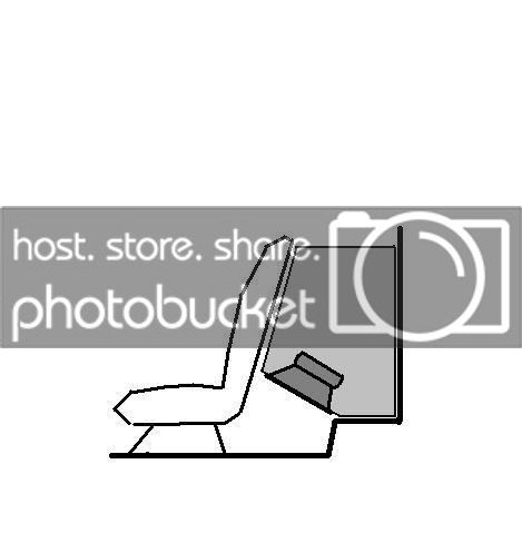

heres a quick Paint drawing I did, This would be the style box I would build if i were running 10" or 12" subs primarily sealed. Or mayb 2 or 3 12"s ported in this style.
