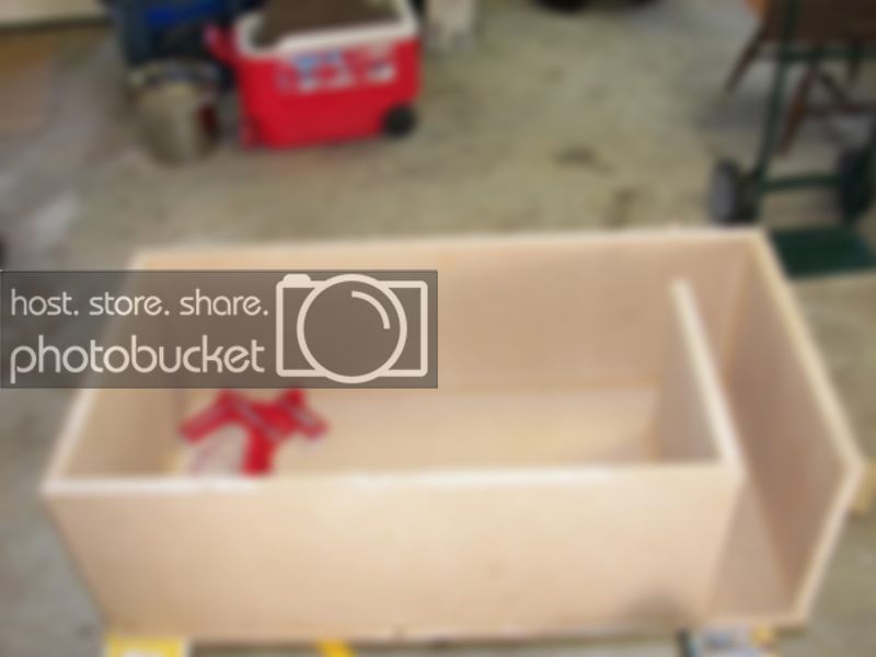

I jumped on the tc9 sale and decided to build early. I think this is my 7th? box. It's 2.3 cubes @ 30hz, but I forgot driver displacement so I'll just invert the sub. Roundover with flush mount in double baffle.

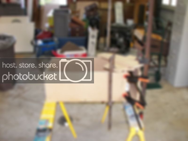

This was my first attempt at screwless construction and sofar its worked so much beter and easily than screws or brads. I can set everything perfectly before it sets.
I would like to know if 45 degree angle pieces in the corners are worth the extra work?
****. i had a feeling something was bound to be off. i kinda rushed the math beforehand. I can always double (or triple) up the port wall I suppose
Hmm... I dunno if I even have the paper anymore.... but i think its 14.5x10x25.75. I have peices to triple the outer port wall, which would make the are 25sq" a fourth would make it 17. Port length is 12". I wound up finding a few plans with 12 inch long 4" round ports, I calculated the area with dia. instead of radius, giving me about 36sq".
Well without knowing all the exact dimensions of the port and enclosure, it looks like that enclosure is tuned to over 45hz. If you made the port about 2" wide, you would have a tuning in the upper 30s. You probably just want to put this enclosure aside for a fart box and try again.

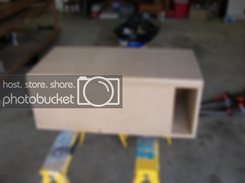

Those are the exact internal dimensions. The port as it is right now is 4x10x12. i can add as many pieces to the outer port wall as I can/need. If 2x10 would be upper thirties how would 1.75 or 1" be? Recutting's a hassle so I'm just gonna do what I can with this one and use it.
So right now I have the port tripled up. It's at 2.25" right now, a fourth would be 1.5" I'm not at my apt right now, so I don't have any of my bookmarks; could anyone calculate this tune freq or point me to a calculator that gives tuning freq off port area and volume?
Are the internal dimensions of 14.5x10x25.75 including or excluding the port? You need to be specific as it will have a huge effect on the actual volume of the enclosure. If that is NOT including the port, you're looking at 2.16 cubic feet. That puts your tuning at a little over 50hz. A 1.75" wide port that is 10" tall and 12" long will bring the tuning to 36hz and I would not make it any smaller than that.

Well, I screwed around in sketchup and this might work for you:
You need to add three panels to the port. Do NOT put them on the outside wall of the enclosure because that will not get you the length you need. With the panels there, you will have about 19" of port length and 1.75" width. 17 square inches of port is not ideal but it might be fine. It's really your only option to get the tuning frequency you desire. If you do what I say, it should be tuned around 30hz.
Next time, you might want somebody else to design an enclosure for you.
How did you do this? Be more specific about your dimensions; stop trying to do this on your own because you're failing.
If your port is 4" wide like you have said and your internal depth is 14.5" like you said, the above picture is about the only thing I would do. I hope you didn't just start gluing shit together. This is NOT the way to build an enclosure. Think before you start throwing things together.
