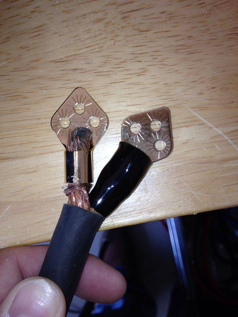

Decided to double up the A4's on some 2/0 so you guys can see what it looks like. I may do this way anyway when I get some A1's.

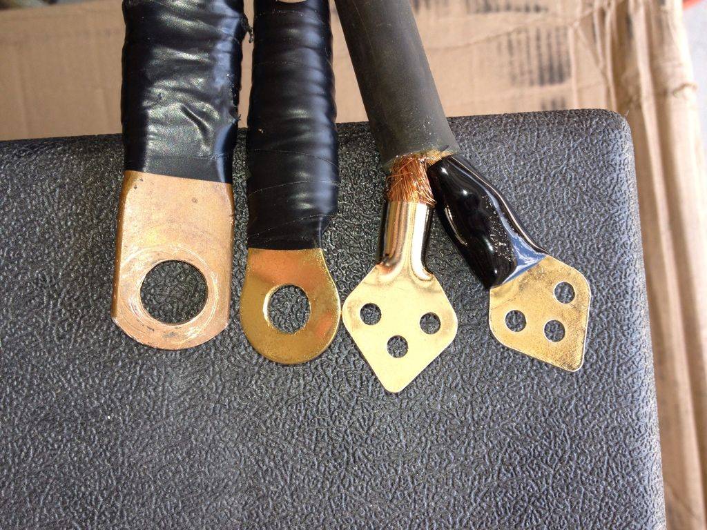

Next to a standard 1/0 ring terminal and a 2/0 copper welding lug. Surface area ftw.
Lol. I knew I shold have gotten a pic of the carnage the other bolt left in my trunk. I'll take 3 small, secure ones over one big ugly one any day.

Lol its a gimmick bro, I don't care how many tenths you think you gained, a proper lug secured PROPERLY would be just as good of a connection.
I'm not going to argue with you, man. But the fact is, you have absolutely ZERO evidence to back that claim up. Whereas I have real world testing.
In my CA world, everything is measured, tested, poked and prodded. That's why I have good meters, O-Scopes, a TermLab, an RTA and clamps. So I don't have to guess or wonder about anything.
Bottom line is, you have your opinion. I have my results. If you don't like the product, don't use it. And I suspect you won't. I mean, I giving the things away. Lol.
all single hole lugs can and will rotate if you want them to. all metals expand and contract with temperature. all DIY grounds will eventually loosen.
if you review NEC, conductor ampacity is rated based on wire terminal surface area. we recognize that connections ARE the source of heat, resistance, and failure.
the best part of the design is more than one mounting hole. using self-tapping screws saves time but we all know those screws are easily stripped if too much force is applied.
i personally prefer bolts that can be tightened substantially.
it is still a great idea. i have seen people use two self tapping screws on single lug terminals for decades. i don't, but many do.
the resistance in a large hunk of continuous floor metal is as negligible as a run of 1/0 to the front. the only thing you gain with a run of 1/0 is halving the number of connections. the specific vehicle chosen should be evaluated for the placement of welds.
i think these ground rings will improve installations for most of the installers out there.

And you think the difference in surface area between these and a standard lug is going to be that drastic? I don't normally disagree with you but I have to here. The only benefit I see is like you said, the fact that the terminal can't rotate but I've never had any of my single screw ground's come loose so that's never been a factor for me.
The benefit of a direct run of 1/0 is exactly as you said fewer connections which in turn means fewer weak links and fewer points where the circuit can be corroded and deteriorated.
