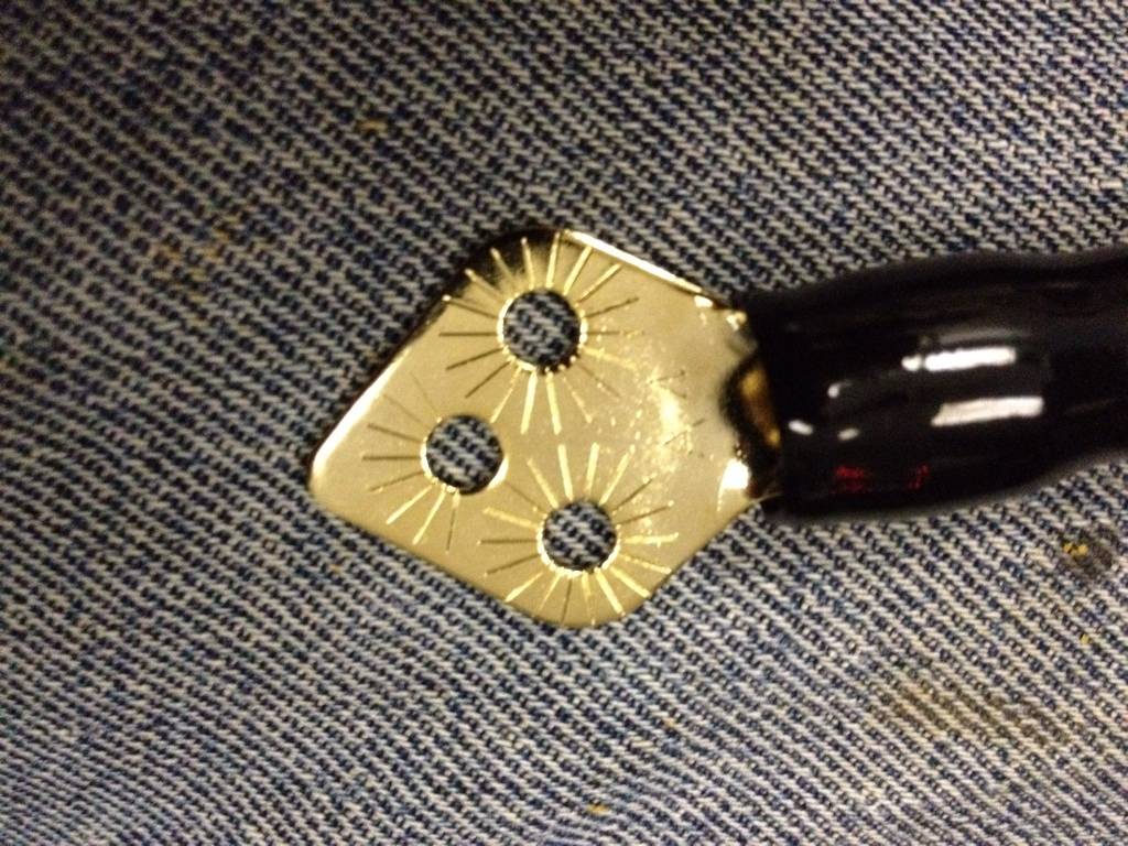

(3) small self tappers and you're done. The small lines you see around the holes are for overlocking the screws to prevent them from backing out without the need for star or lock washers.

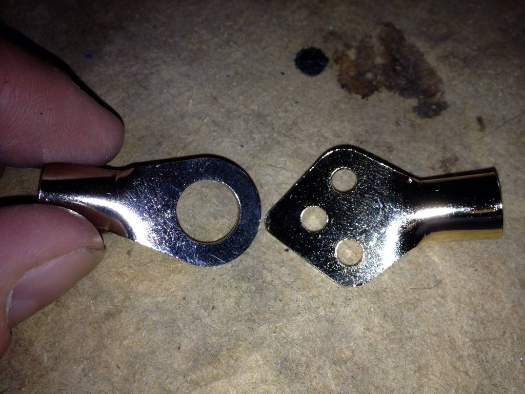

What's the big deal, you say? Surface area is everything. Here is one next to a regualr ol' ring terminal.

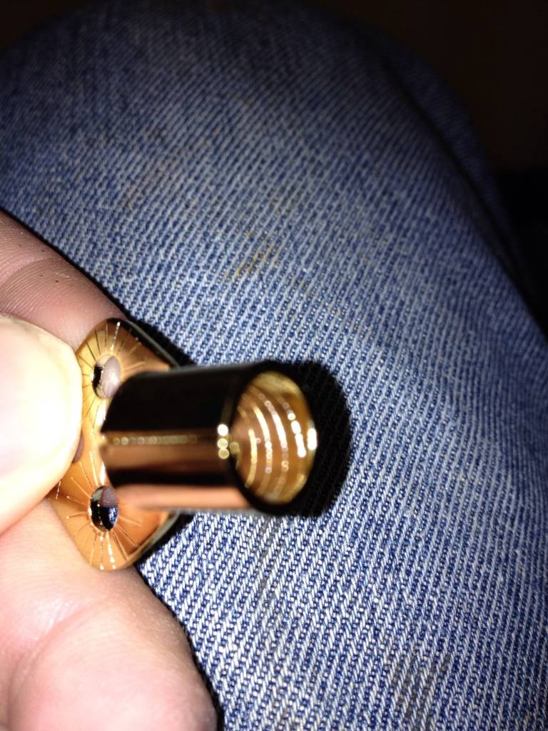

Another neat feature is that the barrel is scored to help prevent the wire itself from pulling out. These aren't just some crap that was thrown together. These actually have some thought and engineering into them.

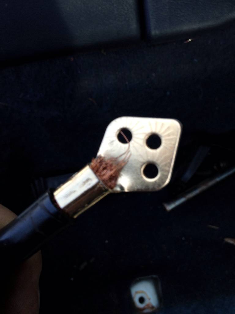

Crimped on a piece of 2awg.

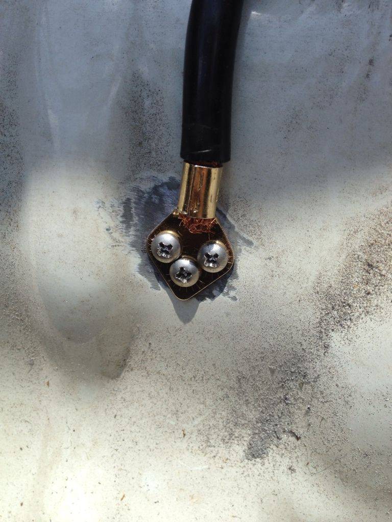

In the CRX.

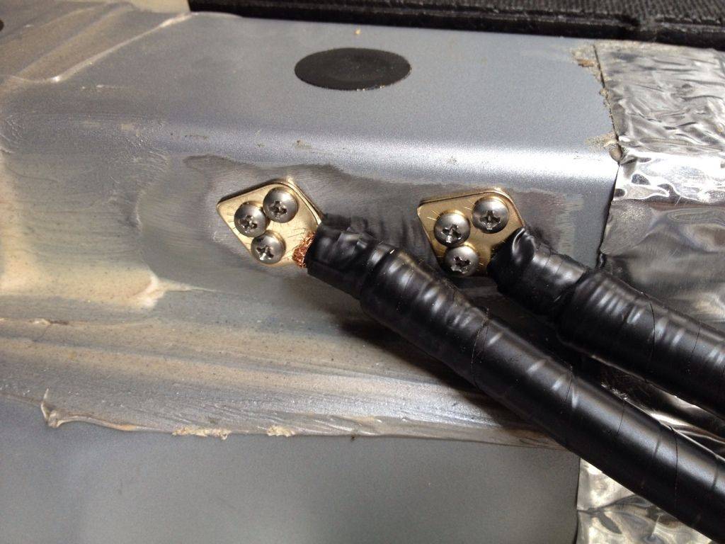

Doubled up in the daily.

Interesting. But, you were complaining about leaving a large hole in your trunk.. how is 3 smaller holes any better? Lol
Really though, nice product. Should help a lot of people make nice, secure grounds.

Yeah exactly..."Regular self tapping screws leave a hole in your trunk, so here, drill three holes instead!" lulz

Lol. I knew I shold have gotten a pic of the carnage the other bolt left in my trunk. I'll take 3 small, secure ones over one big ugly one any day.
