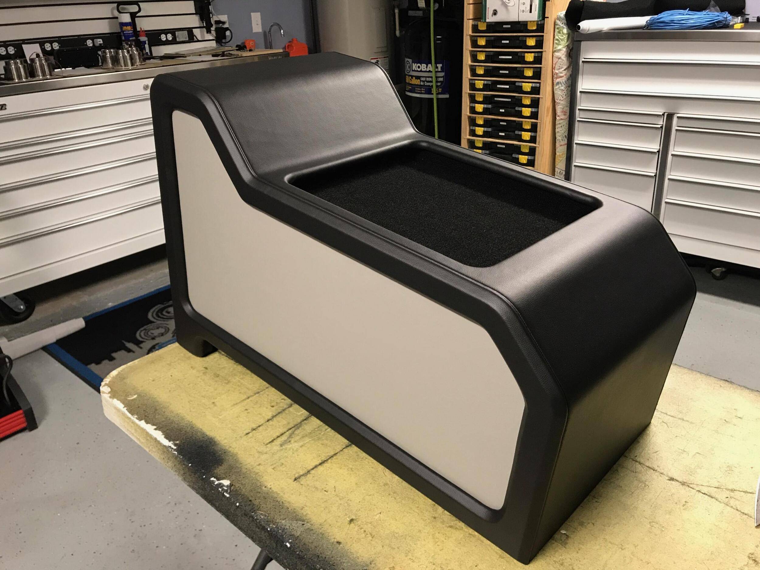

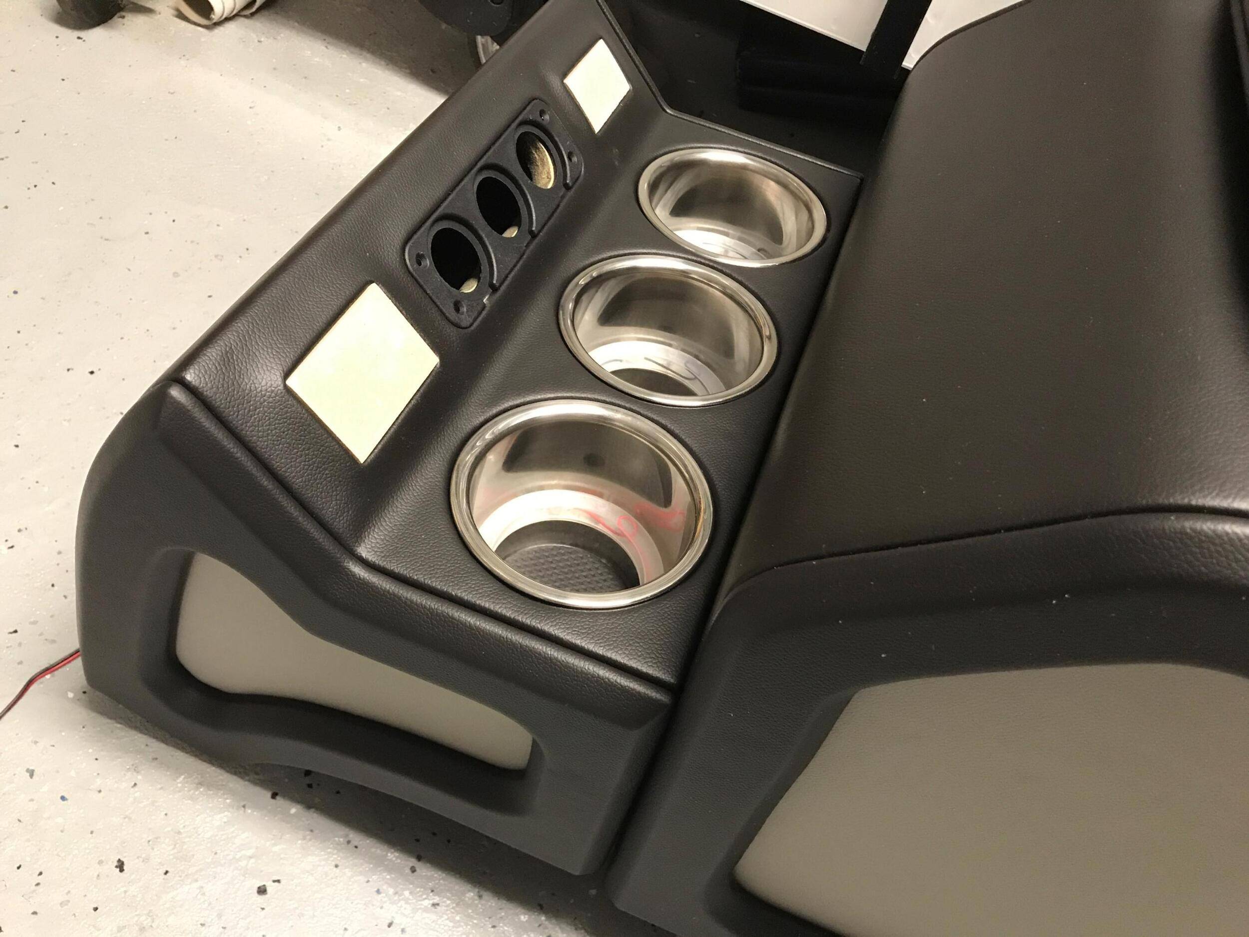

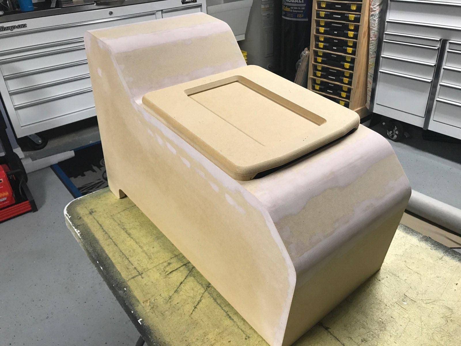

Here are some pics of my new enclosure. I currently have an SSA Icon 12" in a rear middle seat enclosure in my 2018 Silverado Double Cab... I got a new Resilient Sounds Platinum 12" & had to change the enclosure.

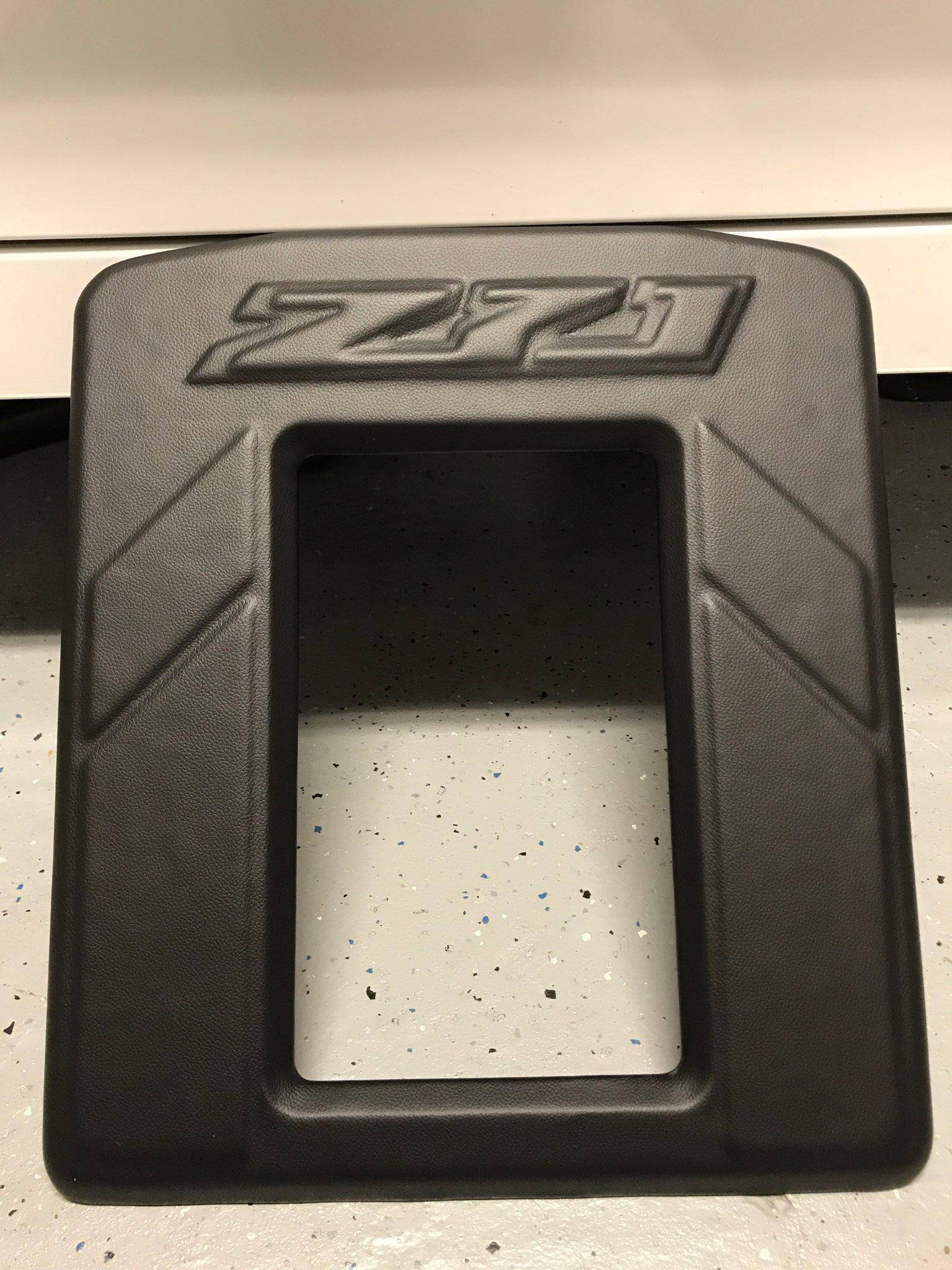

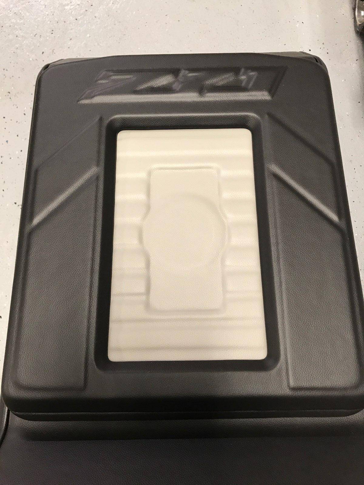

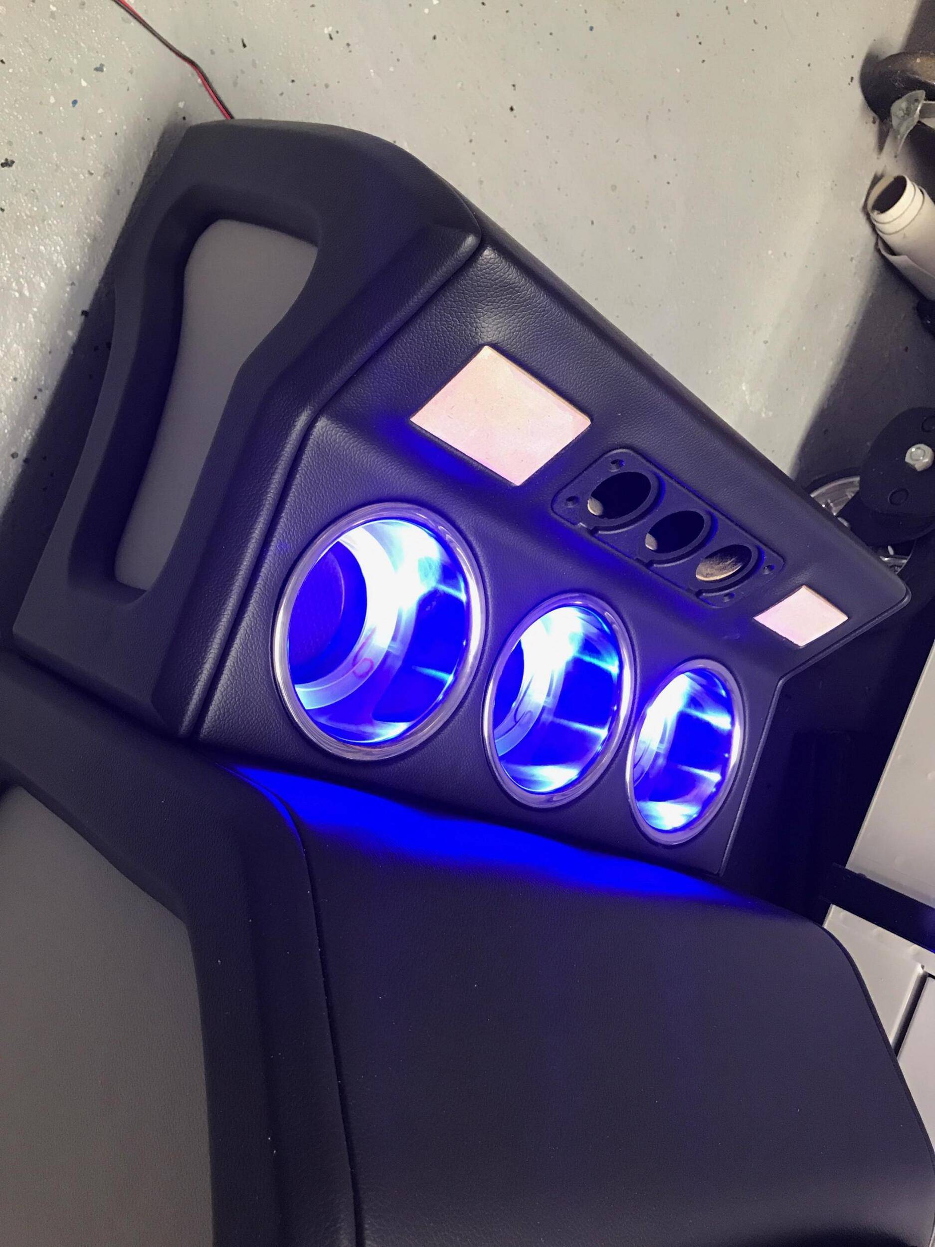

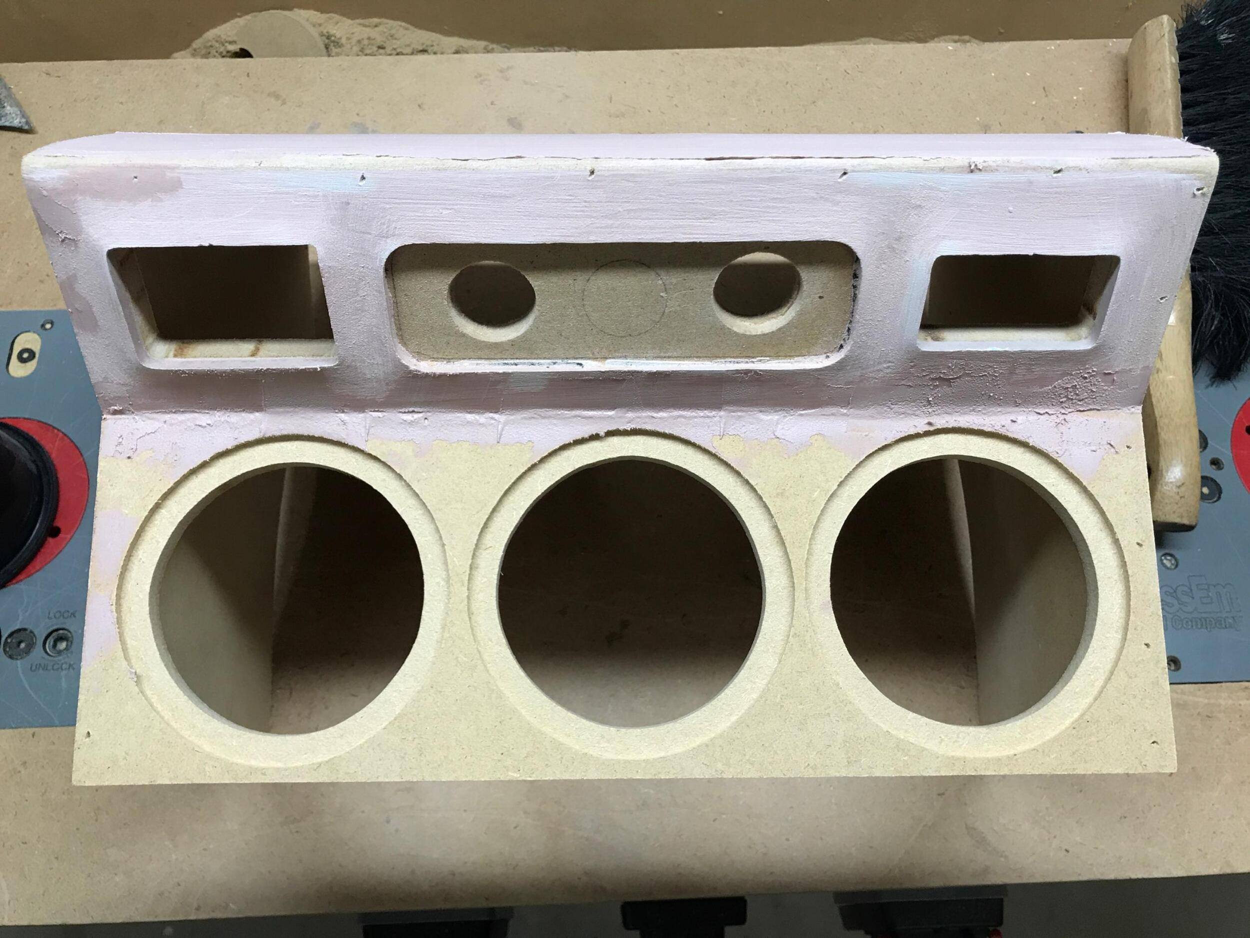

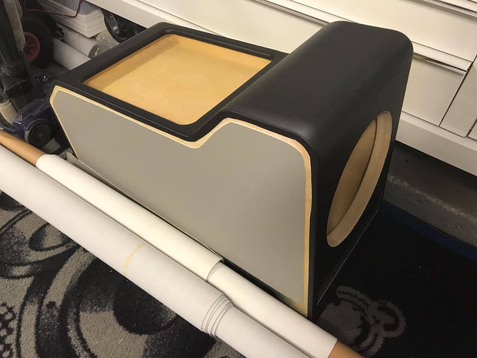

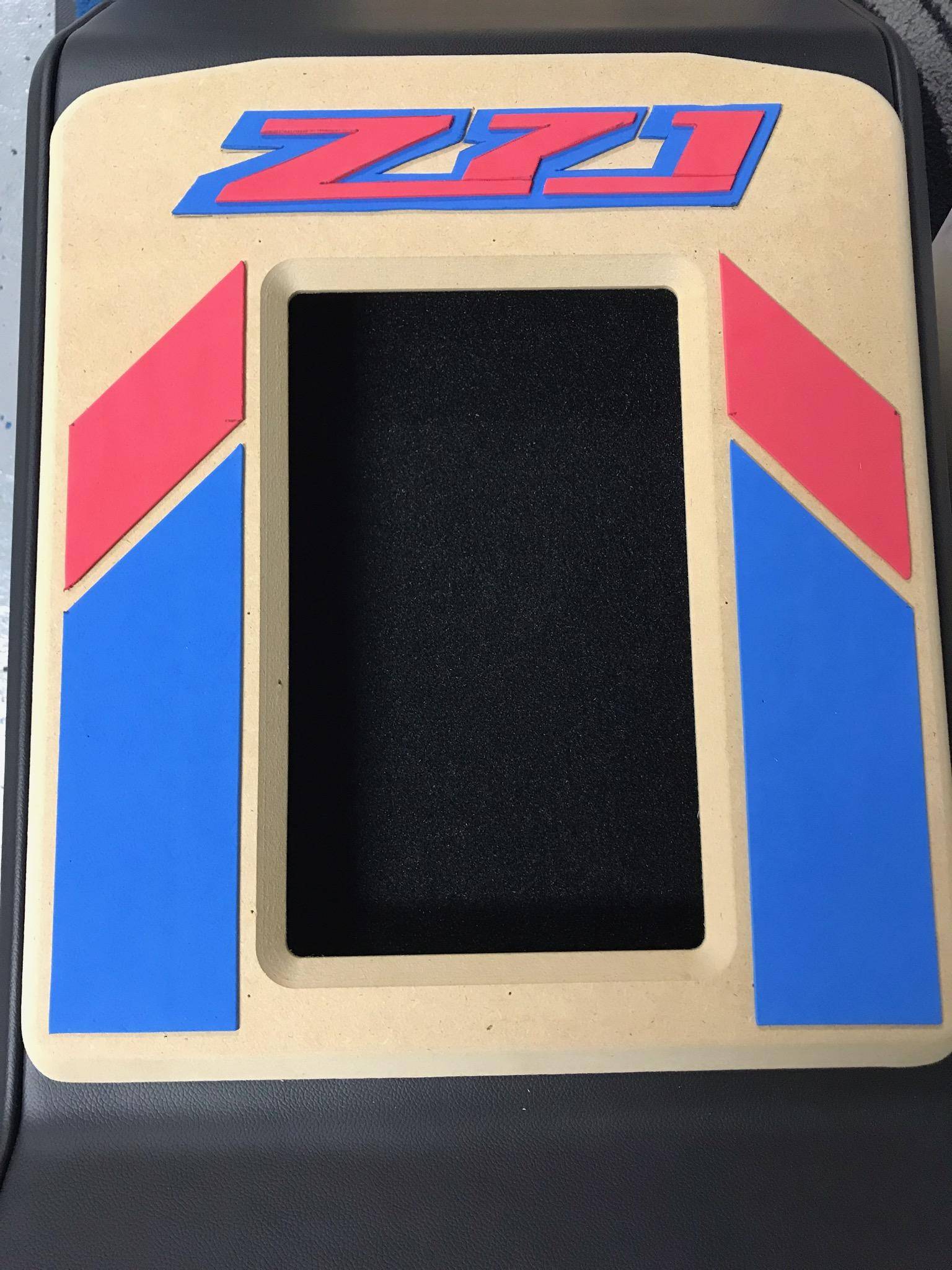

So I decided on a new center console, but it had to be a beast as the Platinum weighs in @ 70lbs!! I also needed it to still work like a console, cup holders, compartment, USB ports, etc... I also wanted it to look OEM when you see it, but when you really look at it know it's something custom. I think everything was achieved. Box is built to specs straight from Resilient Sounds, I have cup holders, compartment, USB ports, even a wireless charger custom fit to my Galaxy Note! Theres also spots for my DSP remote, a trim ring for my Halo power switches and a volt meter!
But enough talk...
Looks like good airspace, port area and... wow... fabrication.
Tour de force...
Great job!

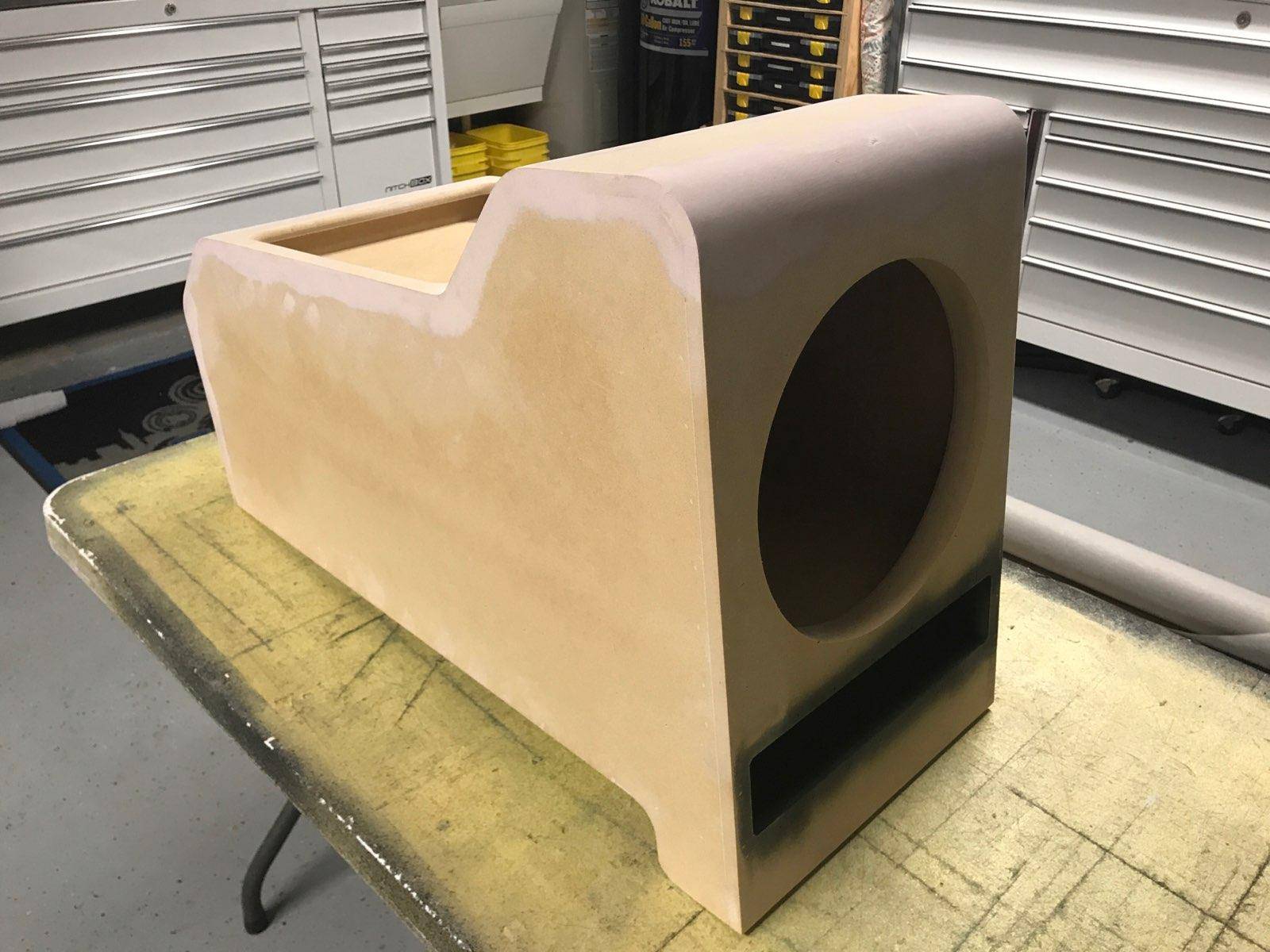

Shredder, thanks & got my specs straight from the owner of Resilient Sounds who got them from his head builder so I hope they're good, lol!
2.25ft^3 before displacement tuned to 33hz... shes pretty big, but doesnt look ridiculously big for a console, which is what I wanted, gain back some space and keep a somewhat OEM look. But when u look closer be like that's not stock OEM!!
