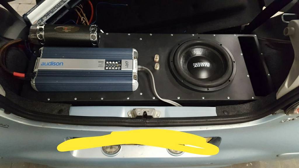

Since a while I've been rocking my Audison LRX 1.1k and an SRX 4.4. They did alright so far, I had to hook up a cap but no major issues. Been noticing my windows moving slower and light flickering just a little though.
After upgrading my Sundown EV3 12" to an SA series I've been having some more trouble. The voltage isn't ever stable.
I own a 2007 Toyota Aygo, don't know a whole lot about car batteries. All I know is that I'm running an LRX 1.1K and an SRX 4.4 and it's too much for my battery. What would be your advice on upgrading, what to look for? There's so much different, perhaps misleading info on the web, I just don't know who to listen to.
Picture of my setup, just before hooking up my terminals and completing it all.
Thanks guys!
