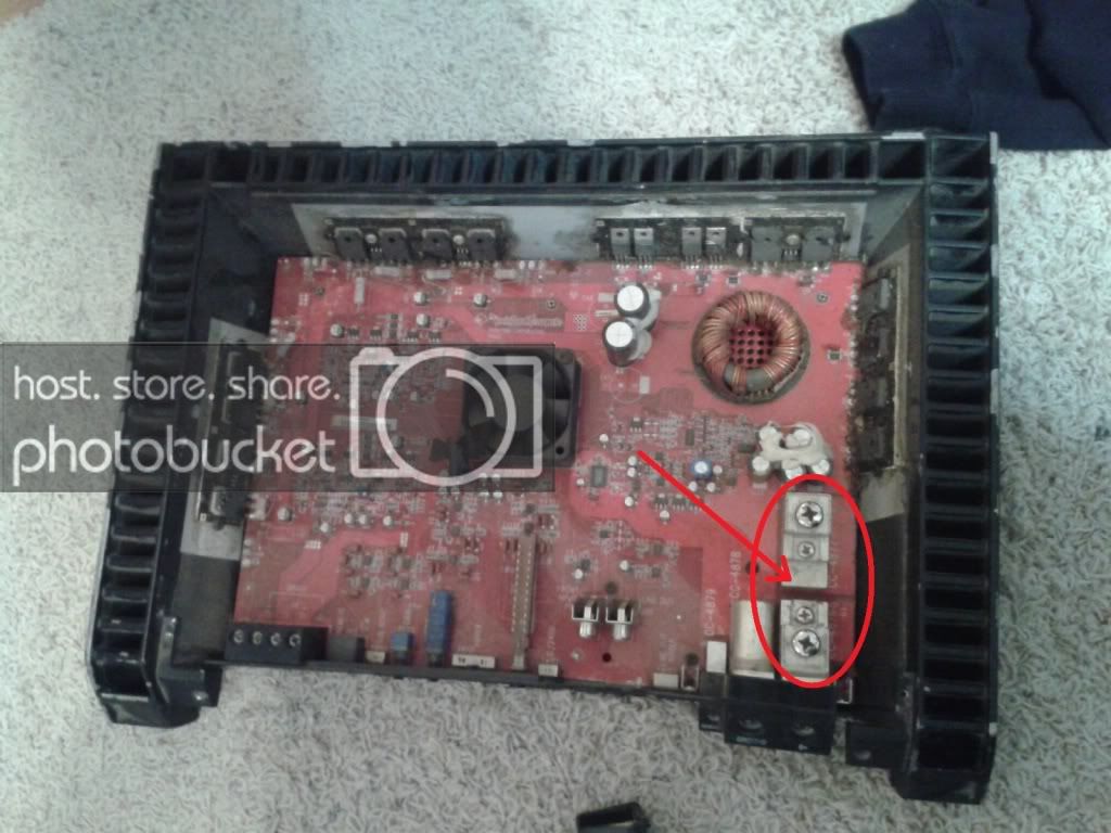

I got a Rockford Fosgate T5002 off a guy on craigslist and I tried to hook it up today and I did not succeed.
So then I texted him and he told me it needs a new fuse, and that he is sure it works.
So I opened up the amp, and I can not find a fuse anywhere. I am pretty sure it takes a 100 amp fuse but I can't find it. On the B+ terminal it says fused, so I am not sure where it is...
Here is a couple pictures that might help.
you got it. not sure if there full sized anl or midi fusing so you have to check up on that might be either or cuz there are 2 size screw spots there

there full sized. i have had a few of these, should have never sold my 40001 //content.invisioncic.com/y282845/emoticons/frown.gif.a3531fa0534503350665a1e957861287.gif
