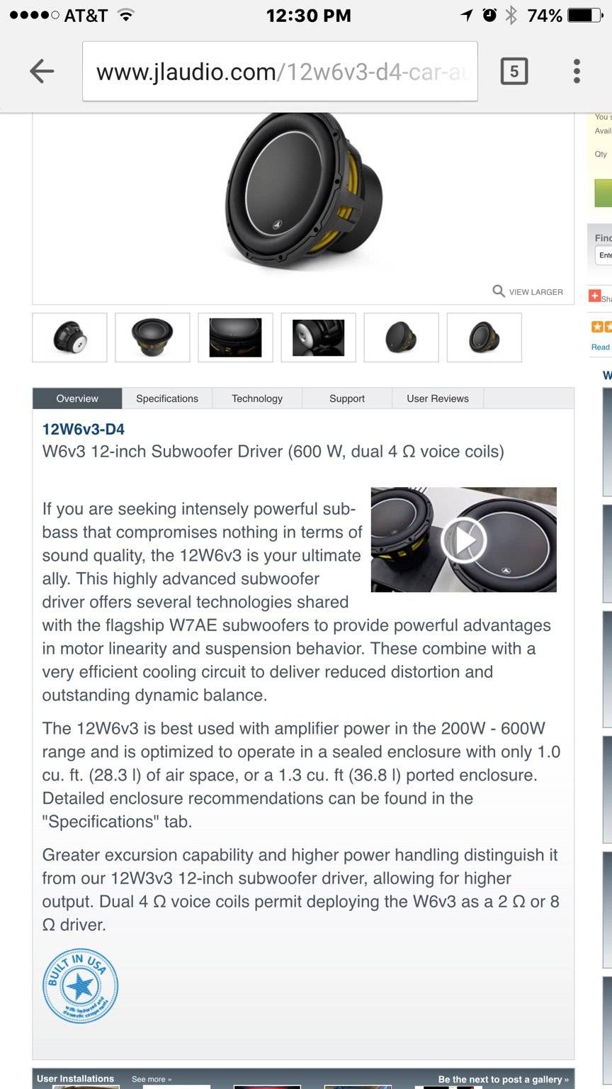

On the JL website it states that the w6v3 can run at 8 , 4 or 2 ohms. I have 2 subs and would like to wife them at 1 ohm, would this be rough on the sub? Can they handle it ? The amp is 1 ohm stable ...

If the amp is 1 ohm stable and you have good electrical, you can run it at 1 ohm. If you're not vastly overpowering the subs or clipping terribly, it's not harder on the subs to run them at a lower impedance....

I wired them to 1 ohm , I know how to wire to impedance , just wonder if it's ok for sub since it doesn't state 1 ohm on JL website
After a lot of googling I wired them to 1 ohm, apparently 2 can be wired to 1 ohm safely, thank fellas

As long as your amp is 1 ohm stable, you have nothing to worry about.

They only come in dual 4. JL makes it where you are pressured to use their amps.
How does that make one use their amps? Dual 4 is something any amp can handle. Now if you meant dual 3s or 1.5s you might have a case there. But their amps are designed to take any load 1.5 to 4 to put out the amps rated power.
