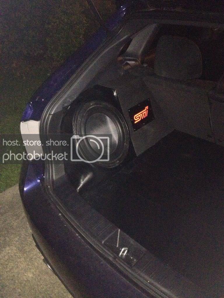

The enclosure was tucked into the side panel of the hatch of a 2008-2014 WRX/STi and would require a vehicle to make the mold, time to lay the fiberglass and to build the enclosure itself, and then would require additional time for the aesthetics portion (sanding, painting, or carpeting, in this case). I don't kno wthat I have seen custom enclosures such as this for under $300.
Here is the enclosure in the previous owner's vehicle:
