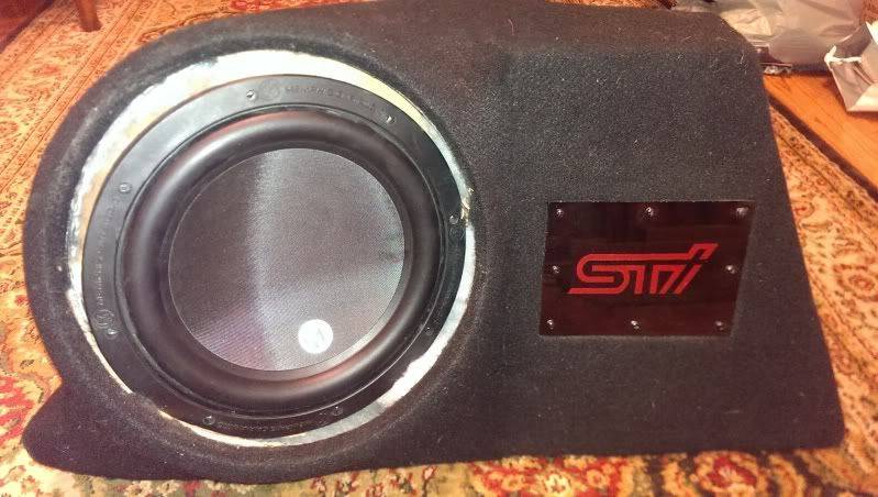

So the enclosure in the pictures below was purchased for my WRX and arrived today. As you can see, it did not arrive intact. Here are the facts:
  • Enclosure was purchased from a fellow member of one of my Subaru forums.
  • I paid about 2.5-3 weeks ago but due to issues finding a box it just shipped out yesterday and arrived today.
  • Cardboard box looked to be 95% intact. The enclosure was held in place with a series of pillows.

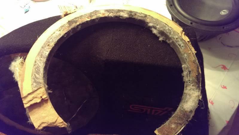

  • I opened the box to find the driver had collapsed into the enclosure. The mounting ring had almost completely detached from the front of the enclosure and was still attached to the driver.

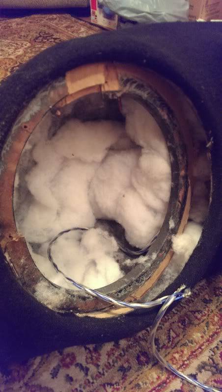

  • I took the photos as I progressed toward removing the sub, which had fallen into the enclosure and was stubborn about coming back out the front of the enclosure.

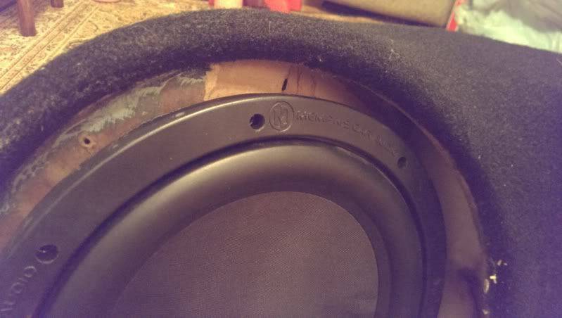

  • From the looks of things, the inner mounting ring was not attached all that well to the front of the enclosure. One ring of hot glue around the edge joint and a single skim of resin on some parts- no fiberglass, no wood glue between the face of the ring and the back of the enclosure face, no brads or nails.
  • There were a couple of thin "struts" holding the ring to the back of the face, but those struts all broke or have become loose. There were 3 of them and only 1 of them was braced to the back of the enclosure.

But it could be fixed. Just need to make a new ring, may have to cut it in half to get it inside the box. But then just center it best you can and fiberglass in place. Not the easiest to fix, but definitely possible!

If you bought it and received it like that i would send the same pictures you posted and explain. I think that the box was poorly made from the start. there is no reason for that ring to break off like that.
if your going to pay 450, you should have just have an audio shop do it... Thats a sorry excuse for a baffle on a box, makes us question the quality of the overall design of the box in the first place. Get the guy to refund you the box and have a professional do it.
Would I want to glue and brad nail it in place? How about replacing the "struts" that held the ring in place while it was built the first time? Do I need to re-create those?
I have a fair amount of fabrication experience but my only experience with fiberglass is in conjunction with POR15 as a floor patch or reinforcement in floorpans.
I guess I made the mistake of going through a vehicle-oriented website and not an audio website. The seller was NOT the builder- he re-sold an enclosure that he paid to have made and used in his own car. I have no idea what he paid.
Now that I have it all apart I see that the back is fairly thin. If I end up keeping this I may have to add additional layers to the inside.
