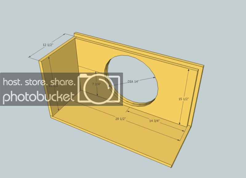

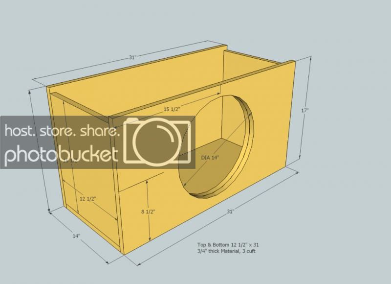

Can someone tell me if this box is 3cf after displacement
So this box here is not 3cf sealed
I got 2.86 cubes after sub displacement.
11.75 x 15.5 x 29.5 = 5372 cubic inches = 3.11 cubic feet - .25 = 2.86 cubic feet
all the air space you will be gaining is an extra sub hole cut out's volume, added to the entire interior volume.
So you will be adding ~~.067 cubic feet to the interior of the box.
~2.9 cubes total.
