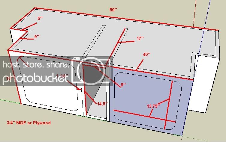

can someone port this box for me....?
Max height? Don't get your hopes up on me making the design though... that's a lot of work to do for nothing.
oh sorry I forgot to post the height. But anyways it is 16 inches. //content.invisioncic.com/y282845/emoticons/smile.gif.1ebc41e1811405b213edfc4622c41e27.gif
dang. relax was designing me a box last night but i guess he fell asleep. I got the wood and supplies all ready and im ready to start building but I dont have a design.
I think im just going to tune it to around 35 because it seems like it will be kinda difficult to have a double tuned one.
Can anyone help me out? I want to get started.
i'm assuming you wanted to use as much space as possible
if thats the design you want i can do a cutsheet for you and all that
Port for 35hz = 5x13x11.5 7.3f^3 internal after port displacement
Port for 50hz = 5x13x2.3
