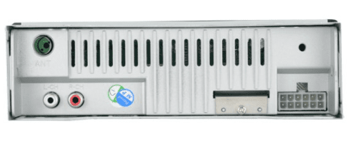

I'm very new to car audio and I have a question, most likely a stupid one but I believe you should learn directly from those who know. So I'm adding a 1 sub plus 4 speakers to my ride. My head unit has 4 speaker outputs and 2 individual RCA Outputs. The amp I want has 5 channels but also comes in a 4 channel variant if that would be better. I would prefer to have all 4 speakers amped because I'm getting a fairly beefy amp that will have plenty of power left over for the speakers. I've included a picture of both the AMP I want to buy and my current head unit/stereo.
Now knowing the head unit has 2 RCA outputs while the AMP has 6 RCA Inputs. I'm wondering how exactly that works. Would only 2 of the 5 channels on the amp work If I hook it up like this.? Would the other speaker outputs simply not work? Is there a way that this will work at all? I don't want to buy a new head unit but will If I have to, but even still I can't find a head unit that is even decently priced with 6 RCA Outputs. I just need help, please.

You may be correct. It looks like you will need RCAs going into each input. The easiest solution is to find a head unit that has the outputs to match your amplifier. Another option is to find an head unit with 4 RCA output. Use a splitter/or Y-adapter to split the signal from one set of RCAs to get ther signal for the sub channel.
Good luck.
Some 4 and 5 channel amplifiers have a switch that allows you to put signal to all channels with only one pair of inputs.
Try downloading the manual for the amplifier you are looking at, and see if that is a option.

Do you know if splitting that dual RCA signal twice each to make 6 outputs reduces the sound quality or provides the correct voltage to all 6 inputs on the AMP? In general, is splitting and RCA signal bad?
Place the Input Mode switch to channels 1&2. Placing it in 1&2 will supply signal to all channels using only those two rca inputs. I assume when that switch is on the 3&4, it means that you also want to use those inputs in conjunction with 1&2 for fade control.
