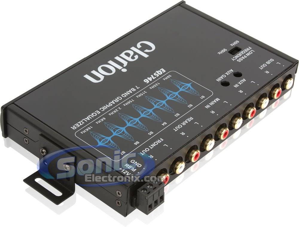

This. You get a parametric eq, external volume, x-over, line driver, all in one little 1/2 din cheap unit. 1 set in, 3 sets out on some. You can get a decent one for less than $100.
meh, not quite parametric, and only $50, but you see the point:

you want gain as soon as you can get it. so a EQ like the EQS746 (i've owned one) gives you some fading and level control at the dash, while boosting the signal before transmitting it (and adding some tone control). i prefer this option - but it also adds cost (plus the cost of RCA's) and it adds another source of noise in the signal chain.
a low output voltage head unit is fine when the amp has a gain range capable of handling it. course, this means you operate with more amp gain so you end up with more noise.
best to get gain as soon as you can. #1 rule in audio.
