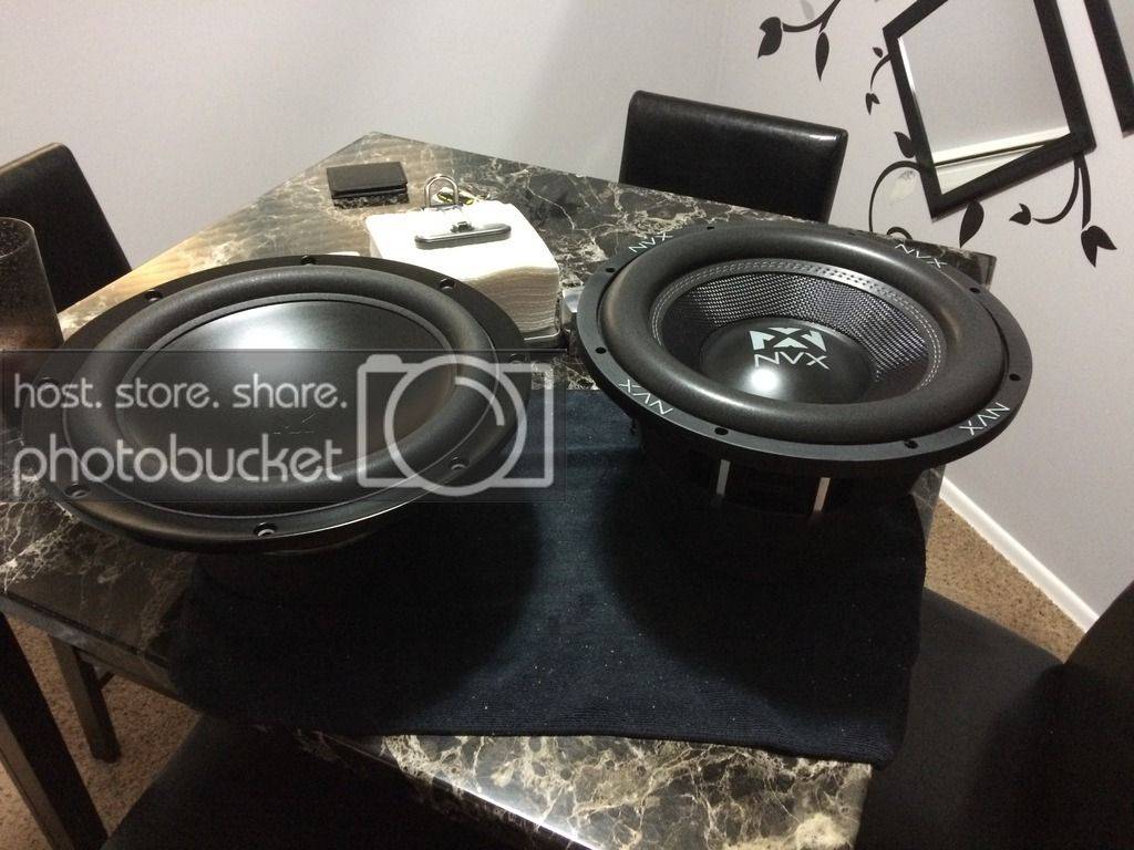

I think I emailed him. Btw I want your avatar speakers what are those? where can i get them lol also thanks for pictures awesome!!! here is a pic of it next to a vcw. The picture doesn't do the best job showcasing how much more cone area there is but...............
if you want more cone area get a bigger sub, there's a reason why enclosure size and port size can vary greatly between two similar subs though. cone area is only one part of the picture, excursion is a huge factor to consider
