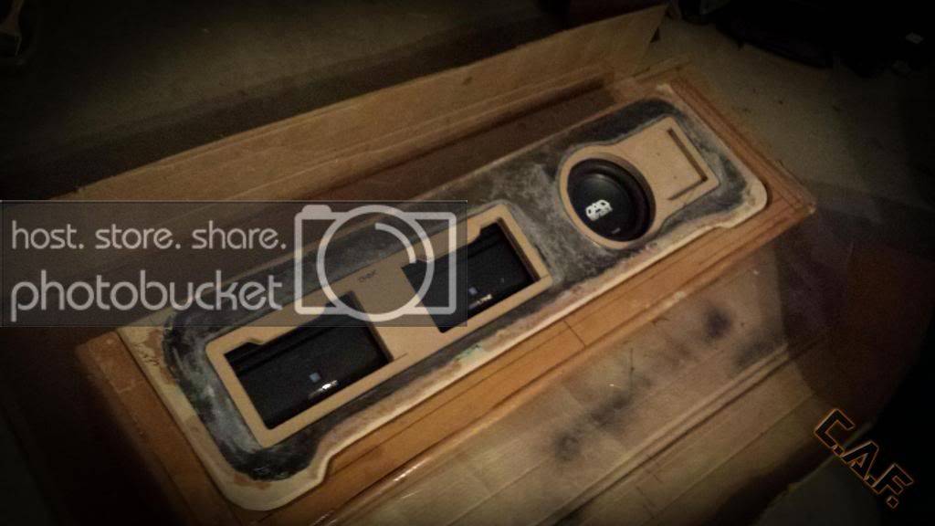

Started with a circle around the sub, didnt really like it so you will see but I do something a little different:
Finally got a new dust mask! i love this thing!
Like the new shape around the sub better?
Amplifier cover templates:
Messed around a little with this mesh, do you think I should use it?

So I know have got the amp rack fibeglassed, smoothed and all ready for vinyl. Lets take a look at the steps:
Started with some fiberglass:
Started smoothing thins out with filler:
Heres how the mesh looks over the amps, still not sure if I will use it, or paint it. I need to see what it looks like after everything is wrapped.
Everything is smooth now!
