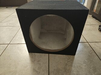

This is what I have, I'm looking for a amp idk what to be looking for maybe a link to something that would be good.

I'd stick to lower power levels, especially utilizing a sealed enclosure. 4ga and 1000w or less is ez depending on the vehicle. If you have any experience just run ofc wire and be sure of your connections. Solid crimps and properly sized wire goes a long way. Set your levels carefully and don't clip... sealed enclosures
The Stinger Audio MT-1000.1 is easy on the wallet and the mt series are solid amps. It'll do about 400w @ 4 ohm which is about right for that sub.

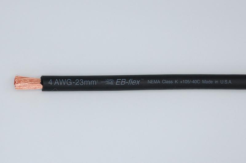

This good wire for your power and ground runs. Pure copper and again easy on the wallet 😂
For wiring the sub itself...any true copper wire in 10g or 12g will work just fine.
