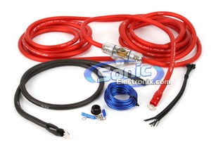

Not wiring this for awhile, but I need help. They're both 400 rms, so 800 rms total. The amp will be either a sa sfb 1000 or a soundqubed s1 850.
Do I need 8 awg or larger?
What size should the actual sub wire from the amp to subs be?
Who sells cheap, but good wiring kits?
Do a 4 gauge kit for future upgrades in ofc if you can. Lots of kits out there...Sky High, Knu Knoceptz, soundqubed and so on. Out of those two amplifiers I would go SFB 1000 any day of the week. Apex has them for 189.99
Most people go OFC and 1/0 to wire for the future in case they want to upgrade. At very least go 4 gauge OFC if you can but if you do NOT plan on upgrading them 1/0 CCA or 4 gauge CCA in a good kit is all you need.
Also if you can afford the extra $ for the SFB 1500 in case you ever want to upgrade it is 239.99. So 50 bucks difference either way you can't go wrong with the SFB 1000 or 1500.
Heck for the price it is hard to beat this right now for wiring for a future upgrade other then the fact it isn't OFC
Stinger OFC kit for 55 bucks is a good deal as well and Stinger makes nice stuff all around for installation accessories.
Install bay CCA for 40 bucks for a 1/0
I'm sure others will pop in with some recommendations. Personally I would wire for 1/0 OFC and be done with it so in case you want to upgrade to a 4 channel dual amplifier setup for your other speakers you are set to go, 4 gauge OFC can do that as well with a 1K amplifier and a smaller 4 channel I did it that way with a Memphis kit and no issues for awhile.
I agree
Run the bigger wire now and then just put a distribution block in the back and spit it if you want to add on in the future
Better to only have to tear the car apart once
[/URL]
I think I'll get the stinger. Thank you for the recommendations.
That has nothing to do with wiring for the future. Always run for the future, you can always add an alternator down the road if you plan on keeping the vehicle. So wire with the 4 gauge or 1/0 so you are set no matter what. You want a 4 gauge at least for that amplifier anyways to get the power out of it.
Always have a set of back up fuses as well. I would do a fuse holder before the amplifier as well just for piece of mind. I did that always when running even just the one amplifier for subwoofers.
That Stinger is a nice kit for 55 bucks. I would look around and see if the price is cheaper elsewhere before buying just to see.
