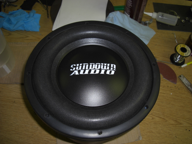

This is the second one I've made. They are a pain in the butt to do... so I never offered them openly.

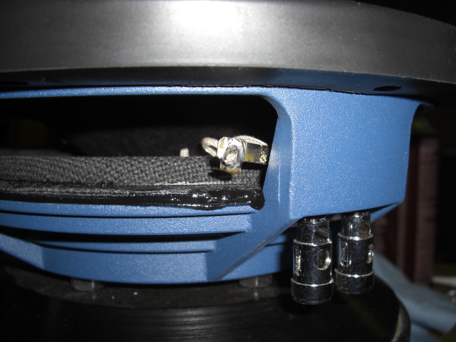

Everything is so tight even the tied down leads smack the cone -- so I will likely go in and glue on some felt pads behind the cone.
In any event... here she is :
* Yes, the dust cap JUST fits inside the surround... actually have to pry it out with a screw driver even without glue.

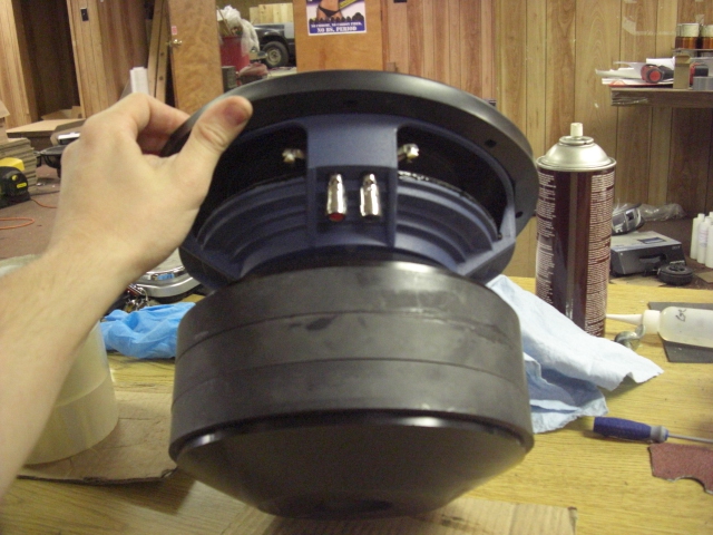

* Terminals come out to the side so I can solder the leads after assembly.
* Big motor on small frame !
I built it for one of my dealers -- so I'm not trying to sell it //content.invisioncic.com/y282845/emoticons/smile.gif.1ebc41e1811405b213edfc4622c41e27.gif Just sharing pics of a big ol' 10 -- I know everyone loves them !
Indeed... if I do production on any 10s they will use 12-spokes. These are frames I had from our old SD-1 v.2 line... actually had to cut out the hole in the bottom of the frame bigger too.
