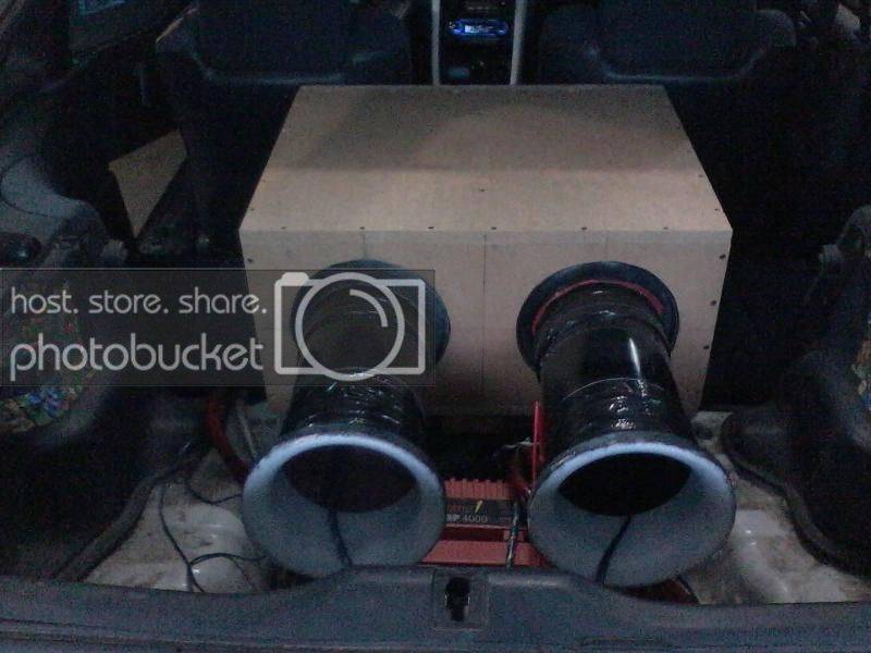

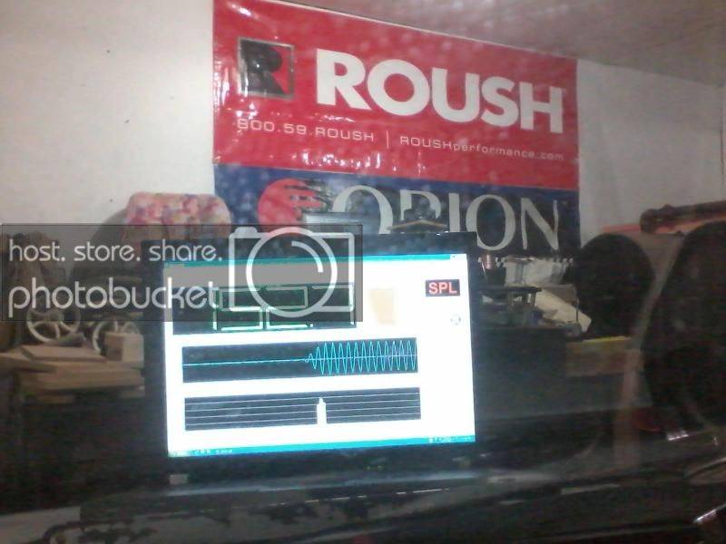

built a new box, got metered. two 10s and sundown power.
CRXBMPN
Moe Bass
Not bad for two 10's - lol @ my buddy Mike who is filming.

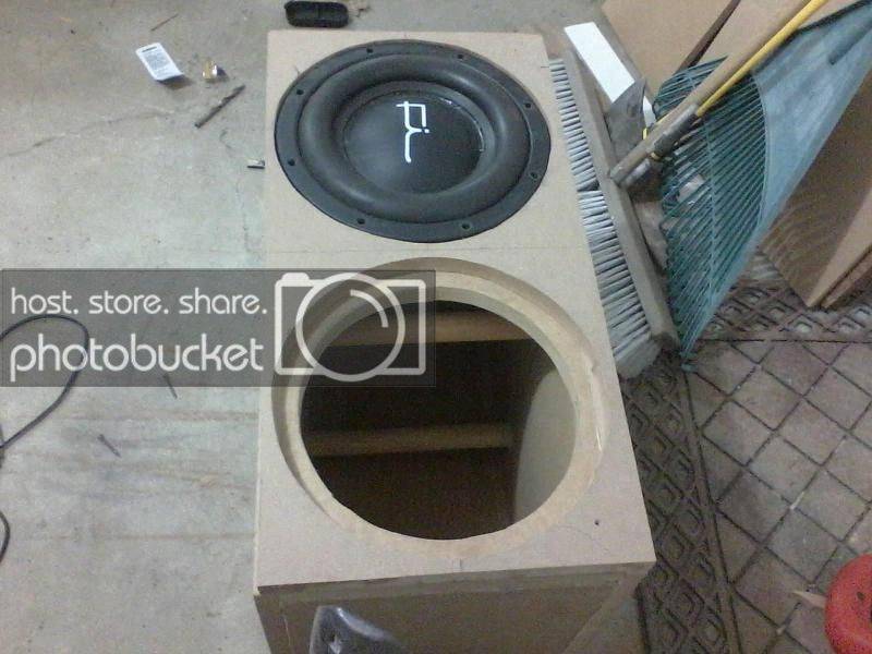

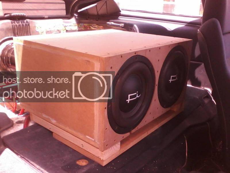

Finished the box and installed it at my job the day before and had no test time what-so-ever.
Have a dash run as well if I can find it.
Real glad I did not sell these off to fund some other projects!!
Some pix

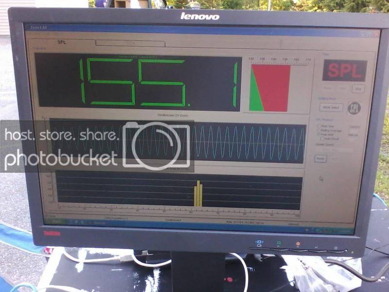

I actually put this on as a side show to a car show, and a large amount of the vehicles that came through the lanes were peaking at 55+hz on my tone sweep... I was pretty shocked. These people need a properly built and tuned box to get out of the 130s like I was seeing.

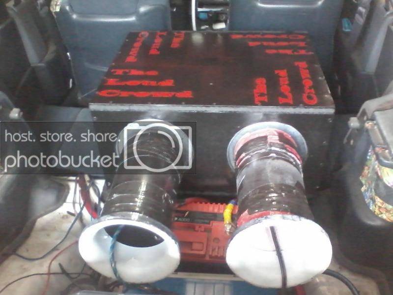

Thx. Going to try shortening the ports and see if that helps any. Also going to try and put both amps on a single 10 and see if I can manage a 150 with one 10.

shortened the ports, hope to see a small gain doing that. getting another 100ah battery to throw in as well, may try to burp @ .25 if my cohones are large enough
shortened the ports, went down to a 151.6 at the glass. made the ports quite a bit longer and went waaaaaaaaaay down to a 149.9. put ports back to standard size that I started with and right back to a 152.3...
tried burping @ .25 but the amps went craycray on me so that wont be happening.
didnt gain anything by adding the other battery as far as # on the meter, but seem to have another .4-.5v compared to just the batcap.

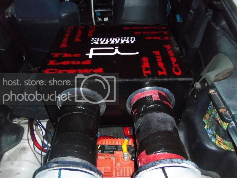

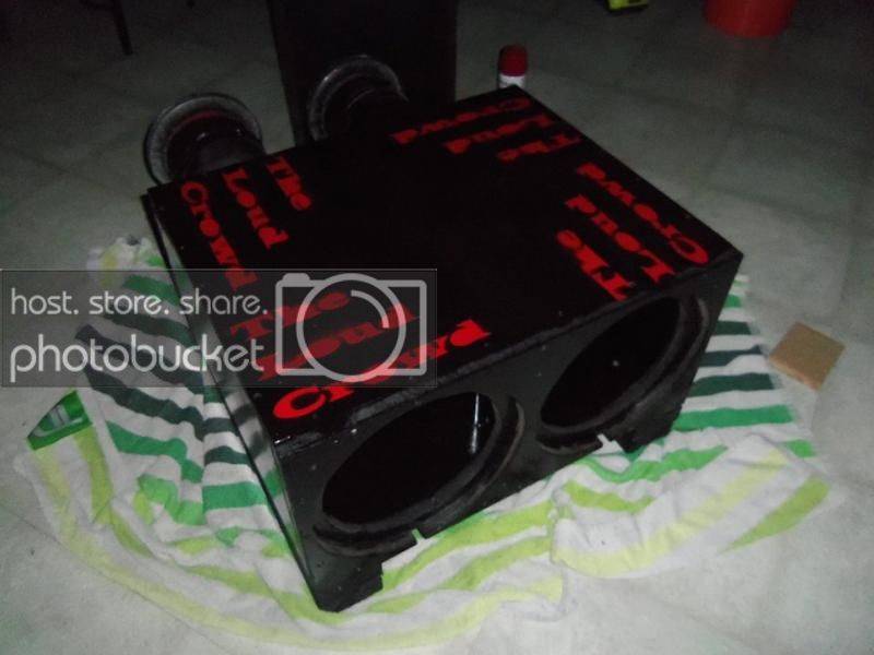

I've polished this turd as much as I can, time to do a few last minute tests and then it's the big Sanford Sound Bikini Car Wash/SPL show on Sunday....
The white really pops b/c it was a bit wet still, but I think it came out ok

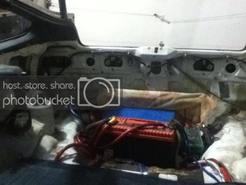

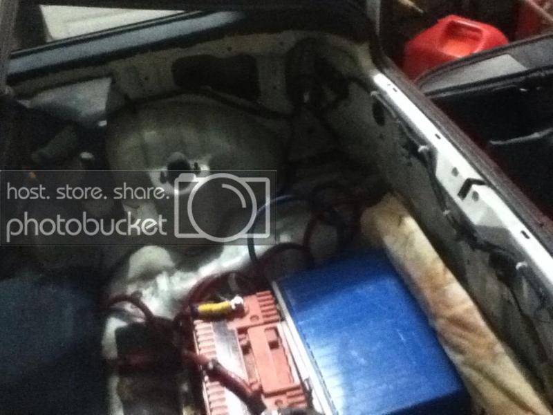

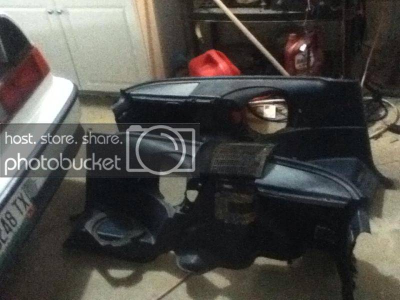

I've heard of a theoretical good gain just by removing the rear panels and perhaps including some dynamat to cover the gaping access holes, so the gut job begins.
