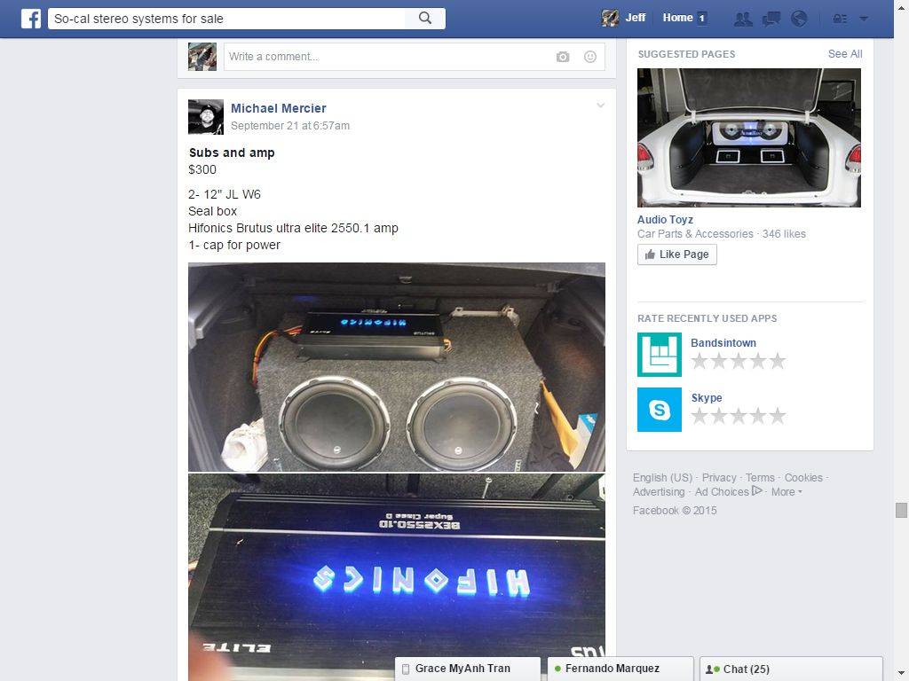

Yup Did a box for two 18s. Been through a lot of abuse with 110 lbs worth of subs (and now 180lbs with new subs) and its holding up real strong. If you are ever in the OC area, hit me up for a demo.
BTW, you kinda missed out on an amazing deal last week Join that FB group for local deals.
This was for both 12W6v3 subs and an amp
DUDE..... that is a ridiculous deal!. My subs were use for 260 total with no box, and my pdx m12 amp is brand new and i got it for free so luckily i didnt go stupidly over budget with that amp! Im definitely down to hear that sound system if im ever around there! hopefully he can build me a nice ported box for my subs, maybe even make it flush. well see!
