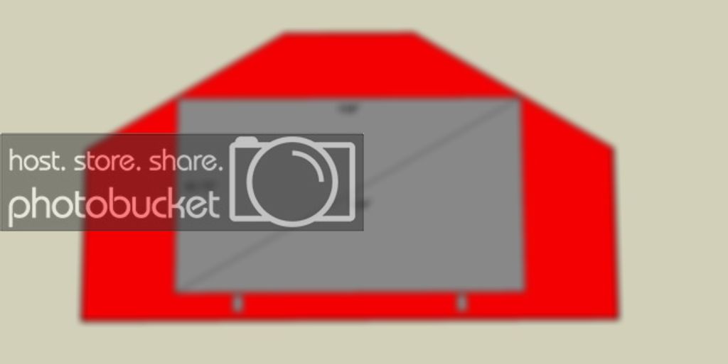

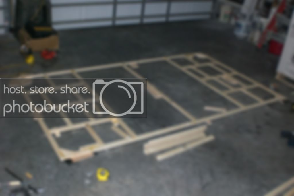

heres what i started today. 124" widescreen. i decided to build it rather than buy one, because the wall its going on was hard to get the biggest premade screen on...

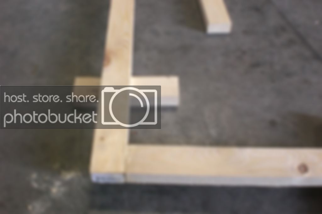

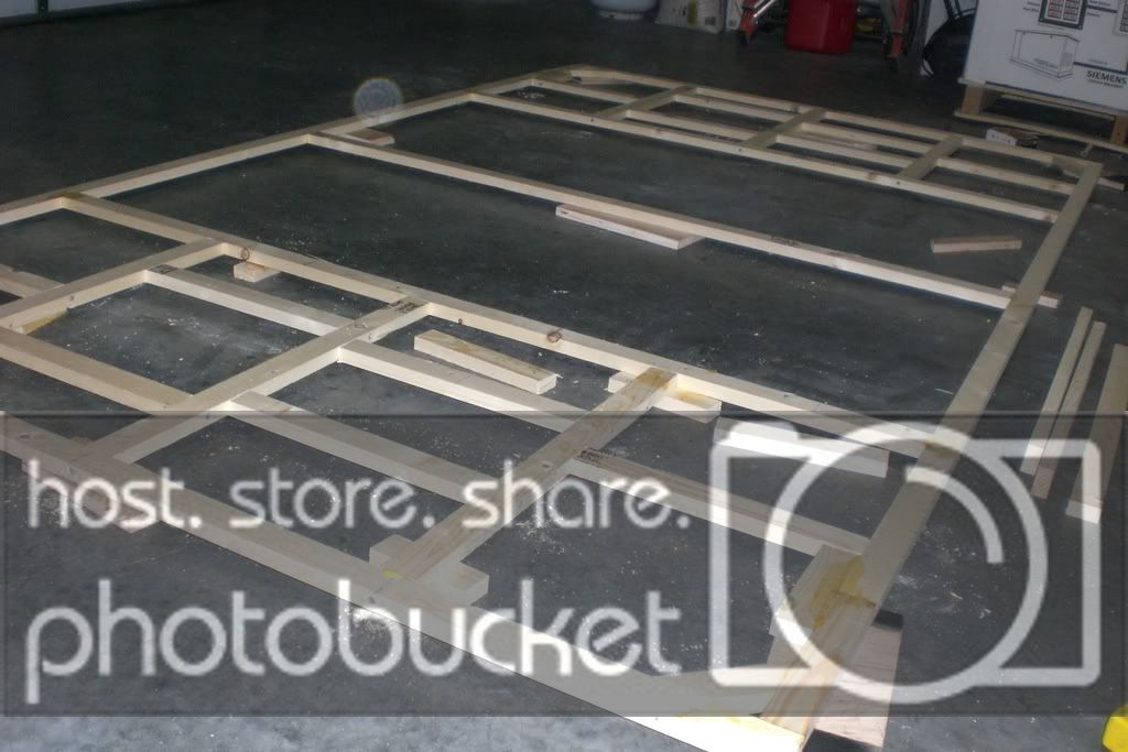

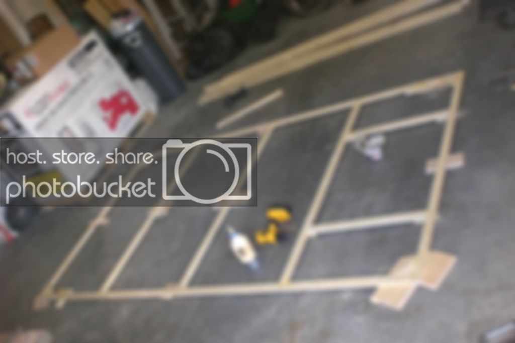

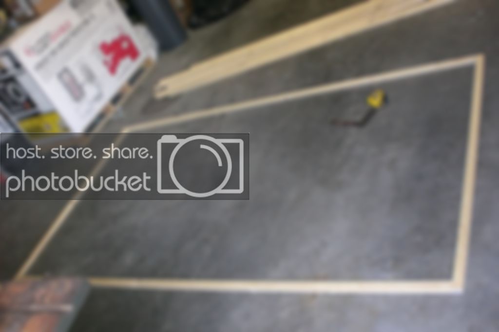

what i got done in about 30 minutes.
still have a lottttttttttt of bracing to do.
i cant find the material i need locally that is wide enough. its all 54" wide (i knew i wouldnt find anything locally) so im going to have to order it in 72" width online i guess. my width is 60.75".......

I would have used 1x3's or bigger and avoided all of the bracing. Gotta be plenty of fabric places online that have blackout cloth in a bigger bolt then 54".
Also hit up avsforum as they have a DIY screen section. Different cloth will offer a different gain and work better/worse depending upon the projector you end up with.

i was going to get 1x3s but they were like $2.37, these were .97 cents. im going to put 1/4" birch over the top once im done building and bracing the frame, before i wrap it.
