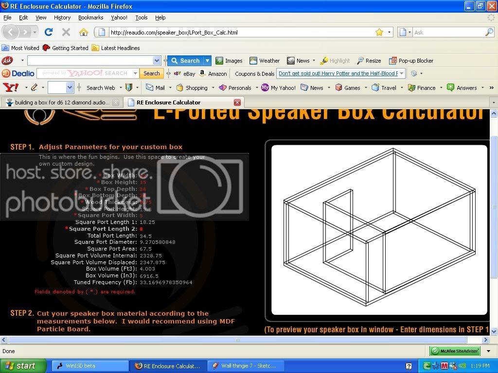

Something like this might work.
I'll get cut sheet in a sec...

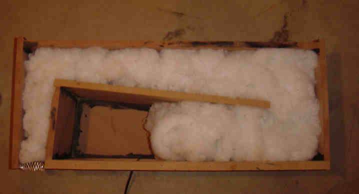

I have a single 12" D6 in a folded transmission line enclosure. It has some amazing low-end and great sound quality. Not an output monster but is great for what I was looking for.
