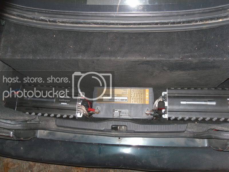

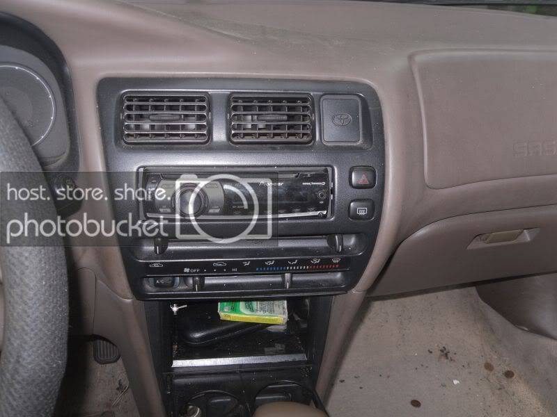

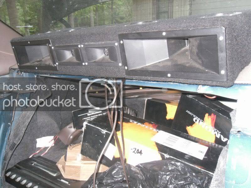

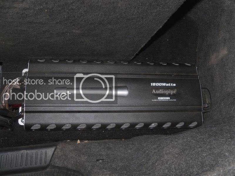

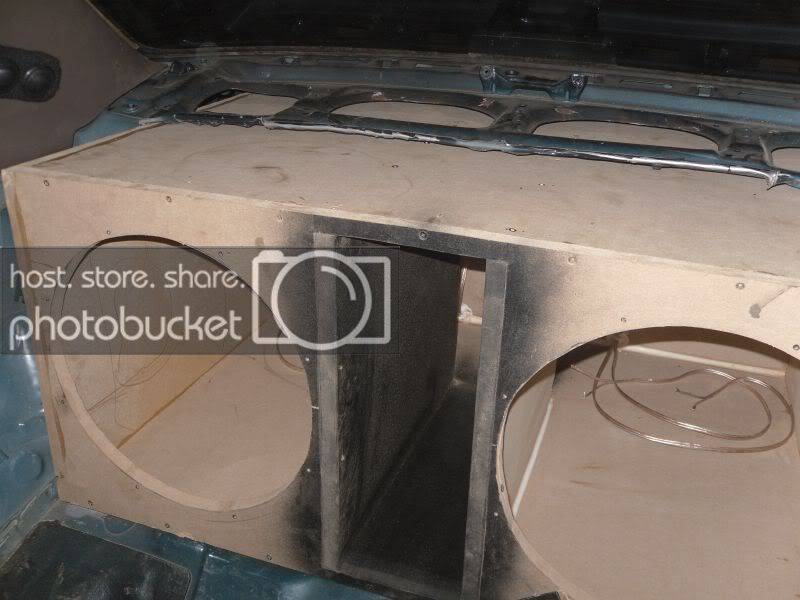

Heres an install ive been working on lately in my spare time. Heres the equipment lineup:
AP18001D On Subs
2 TXXAPX 15s

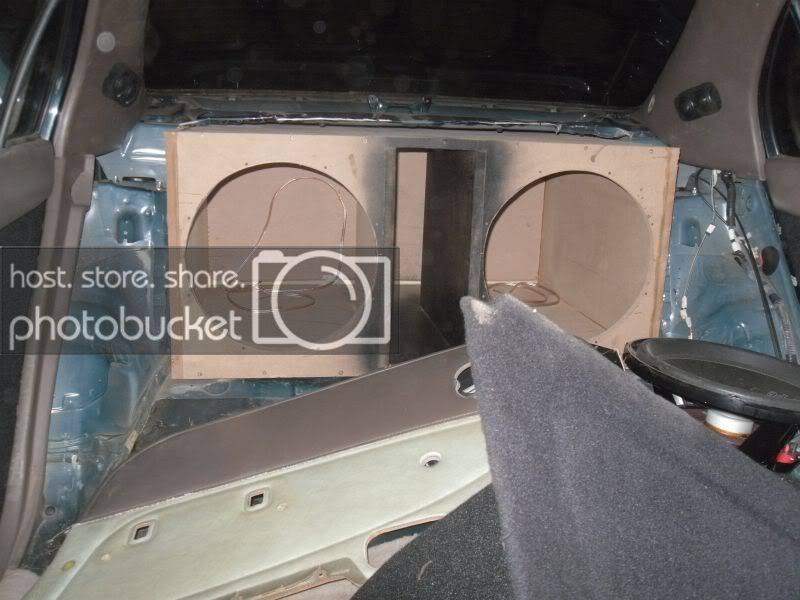

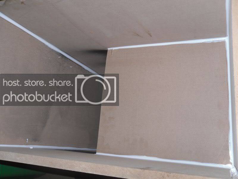

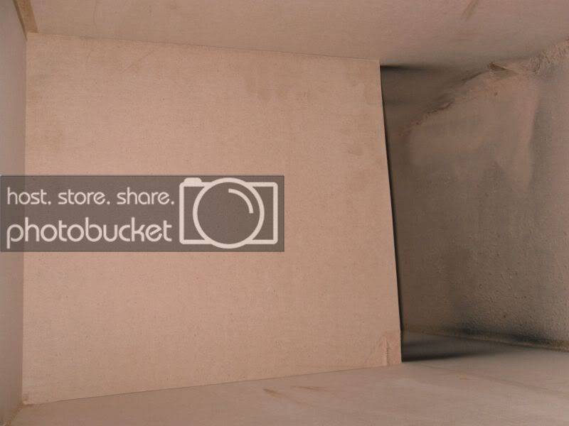

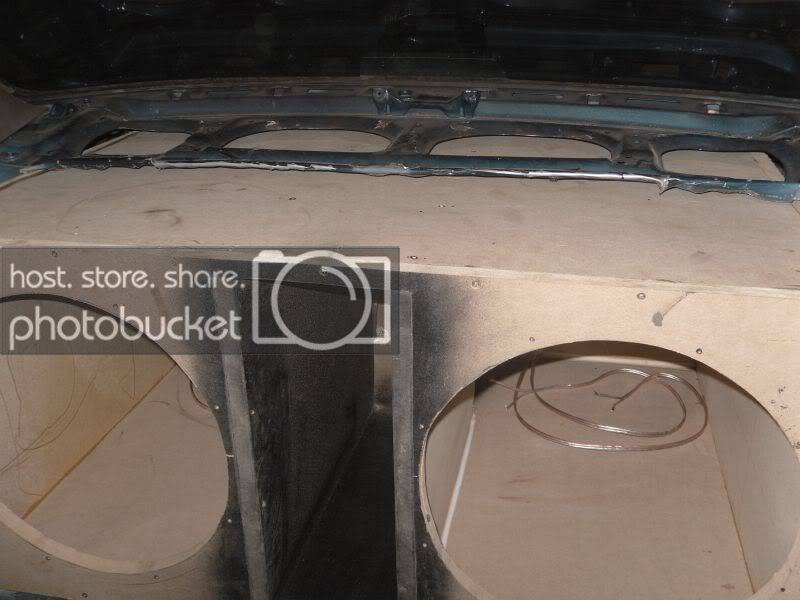

8 CF net @ 32 hz, 110" of port //content.invisioncic.com/y282845/emoticons/up2something.gif.dd110ecf3ae4b76050d87598f2f8de7c.gif

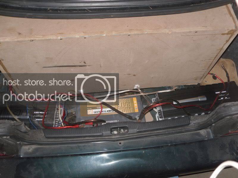

AP4004 On Mids/Highs

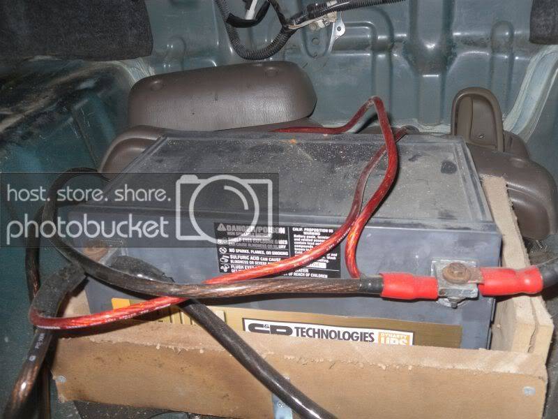

Yellowtop up front
C&D in trunk
Big 3
4 Diamond D3 Comp Sets ( 50wrms per mid/tweeter)

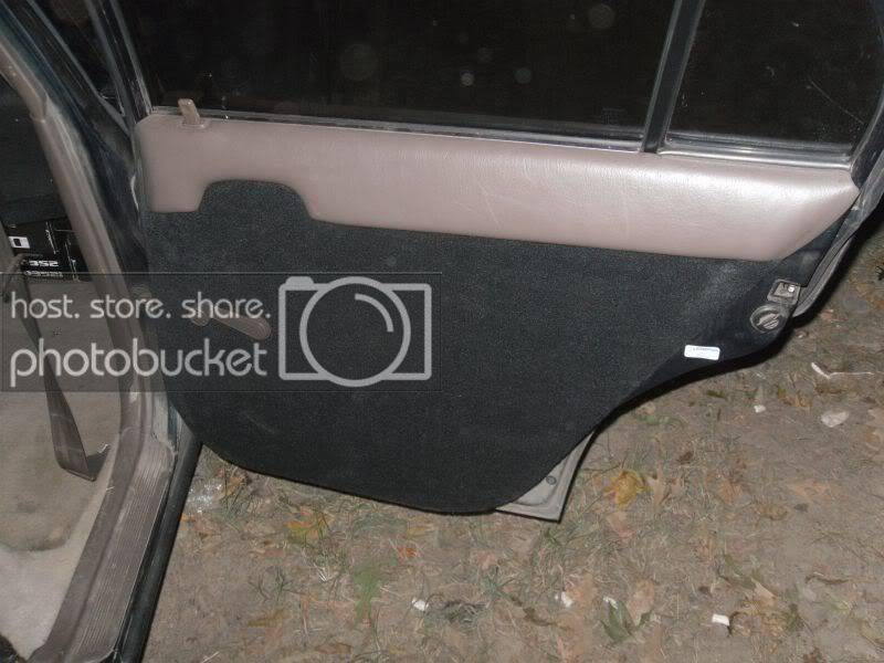

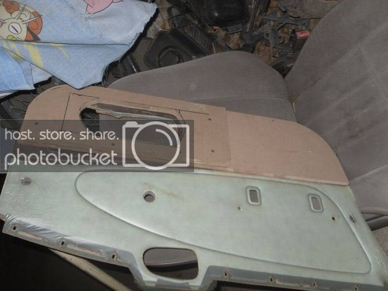

Wall / Redone Door Panels / Rear Deck / Etc
New seats from some junkyard lexus //content.invisioncic.com/y282845/emoticons/fro.gif.c695f1f814b01c4ad99fe7f8cccadd29.gif

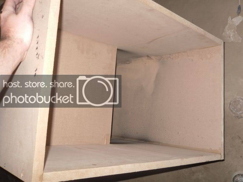

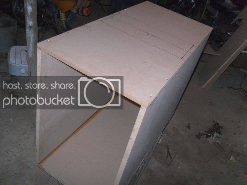

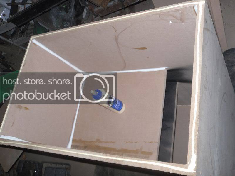

All MDF inside no fiberglass //content.invisioncic.com/y282845/emoticons/*******.gif.a649d21efc0d1fd4890a6428166586c1.gif

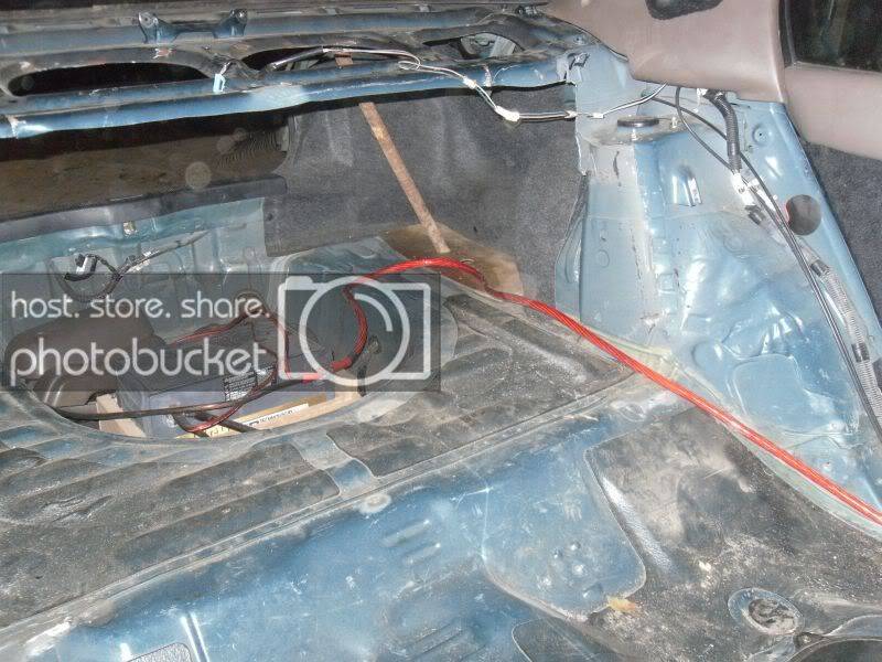

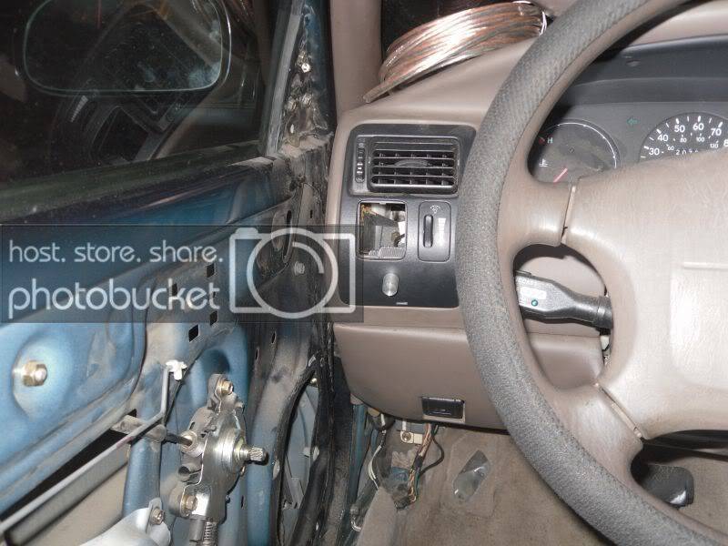

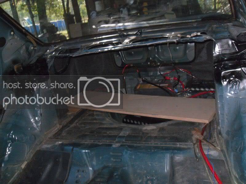

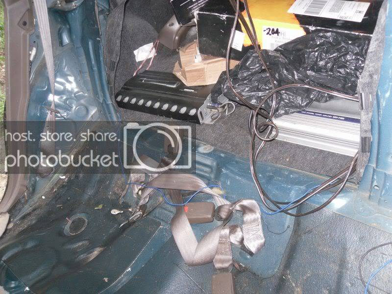

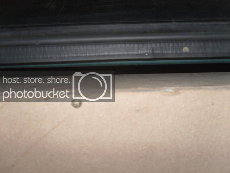

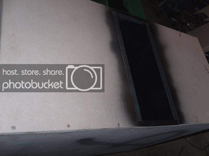

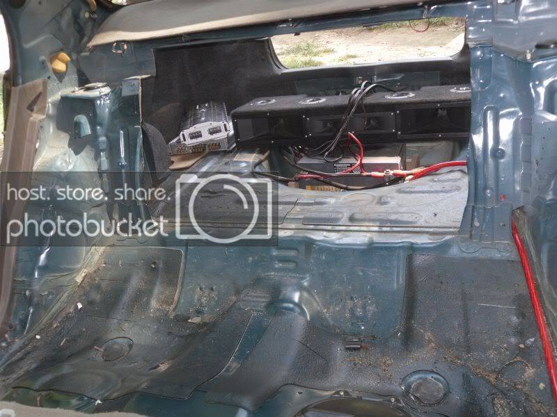

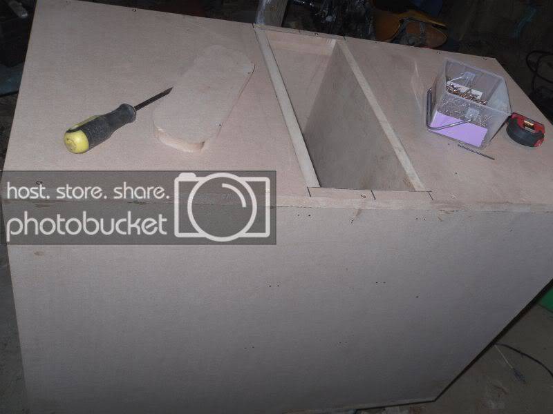

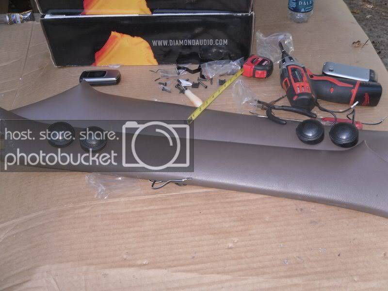

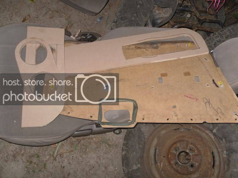

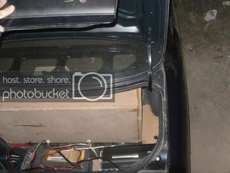

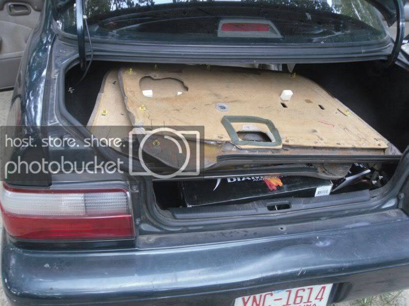

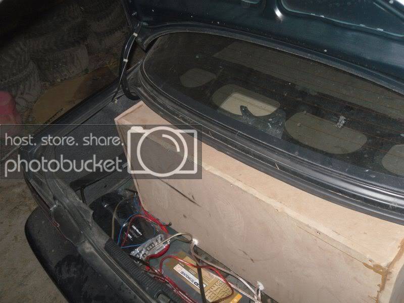

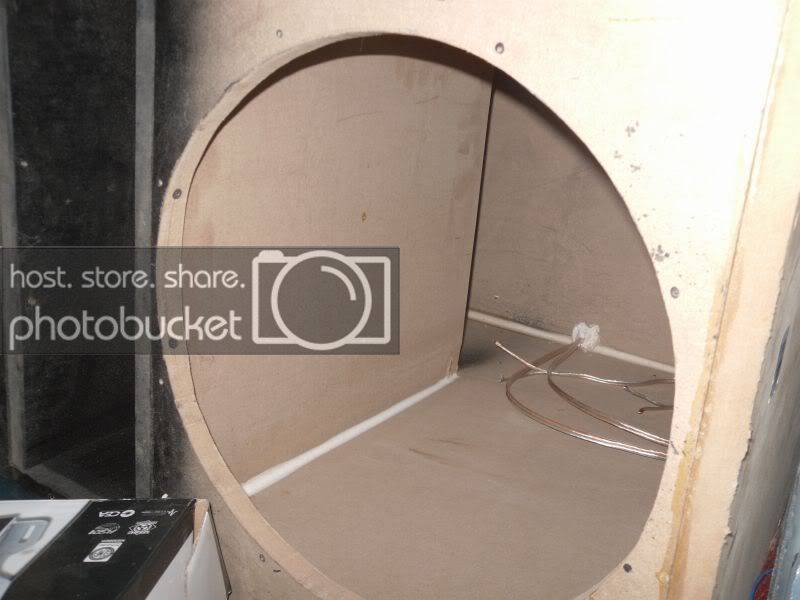

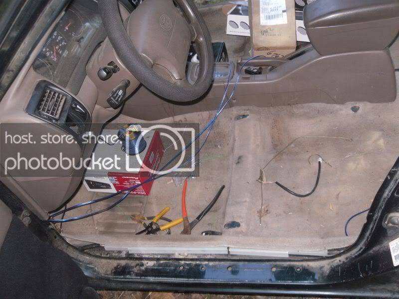

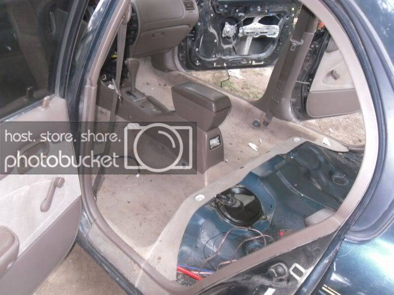

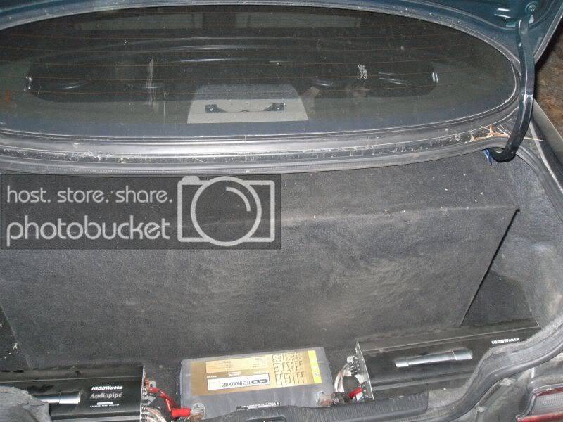

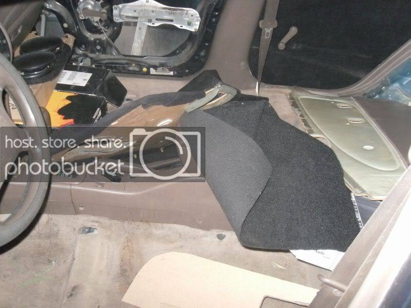

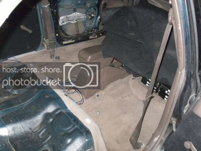

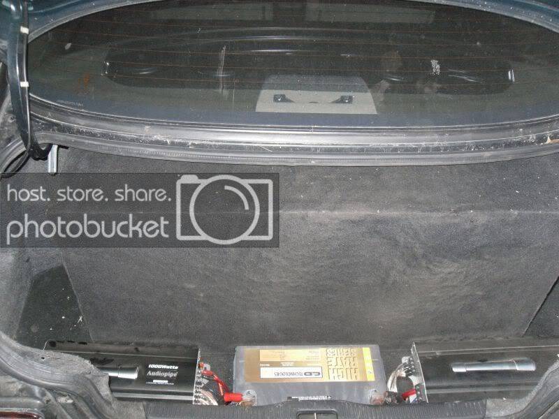

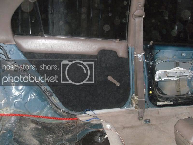

Posting the pics from when i started to most recent, about 15-20 hours in so far. Will be updated with my progress daily. Didnt get many pics of the car before the install, but you get the idea.

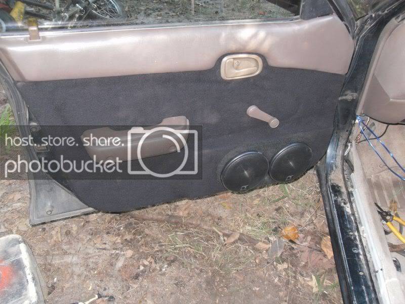

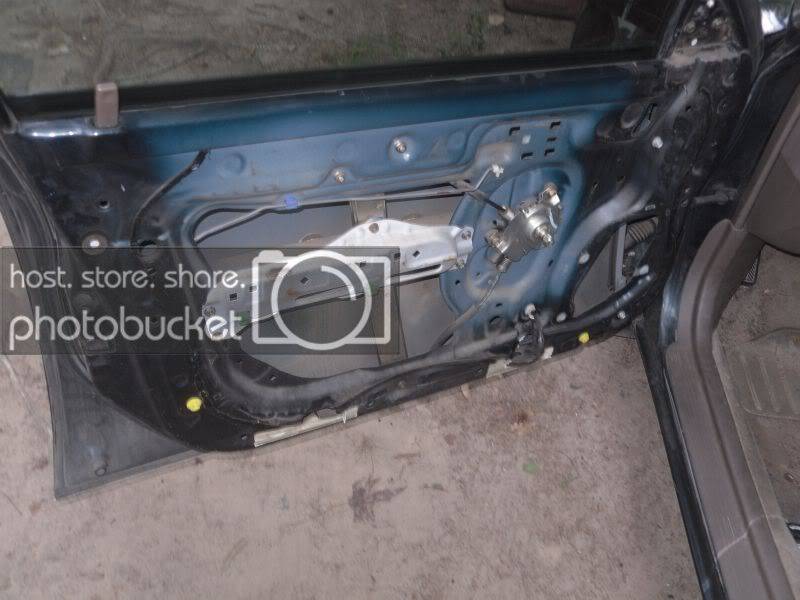

So far i got the box done, RCAs and power wire ran, grounds done, 3 of 4 door panels covered, 3rd one ready to be covered. RCAs and power wire are on same side of car but there are no noise issues, has been like that since the first install 2 years ago.
Thanks //content.invisioncic.com/y282845/emoticons/smile.gif.1ebc41e1811405b213edfc4622c41e27.gif Tommorow ill be finishing up the other front door and running some wiring to possibly get the front speakers playing. I have to take the box back out and carpet it, move the speaker wires up some, carpet some of the interior, the metal beside the box, and install the rear speakers on the rear deck.
Ill be installing 2 crossovers under each front seat for the front doors, and the 4 rear crossovers will be on top of the box. Also have to mount the front tweeters on the a pillars and run wire to each front speaker. Fun fun. Shits gonna be nasty when its done though. Eventually ill be installing a second AP1800 and running something like 2 Nightshade 15s @ .5 ohm on each amp.
Im gonna talk to jacob and see if i cant get this thing on the meter when I go pick up the 2 18s i bought a while back. Should be interesting to see what it does on the meter. Should peak around 38-40hz.
