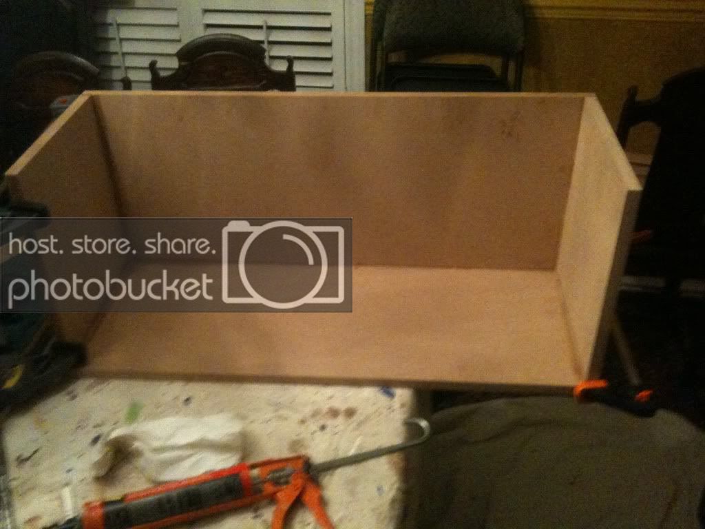

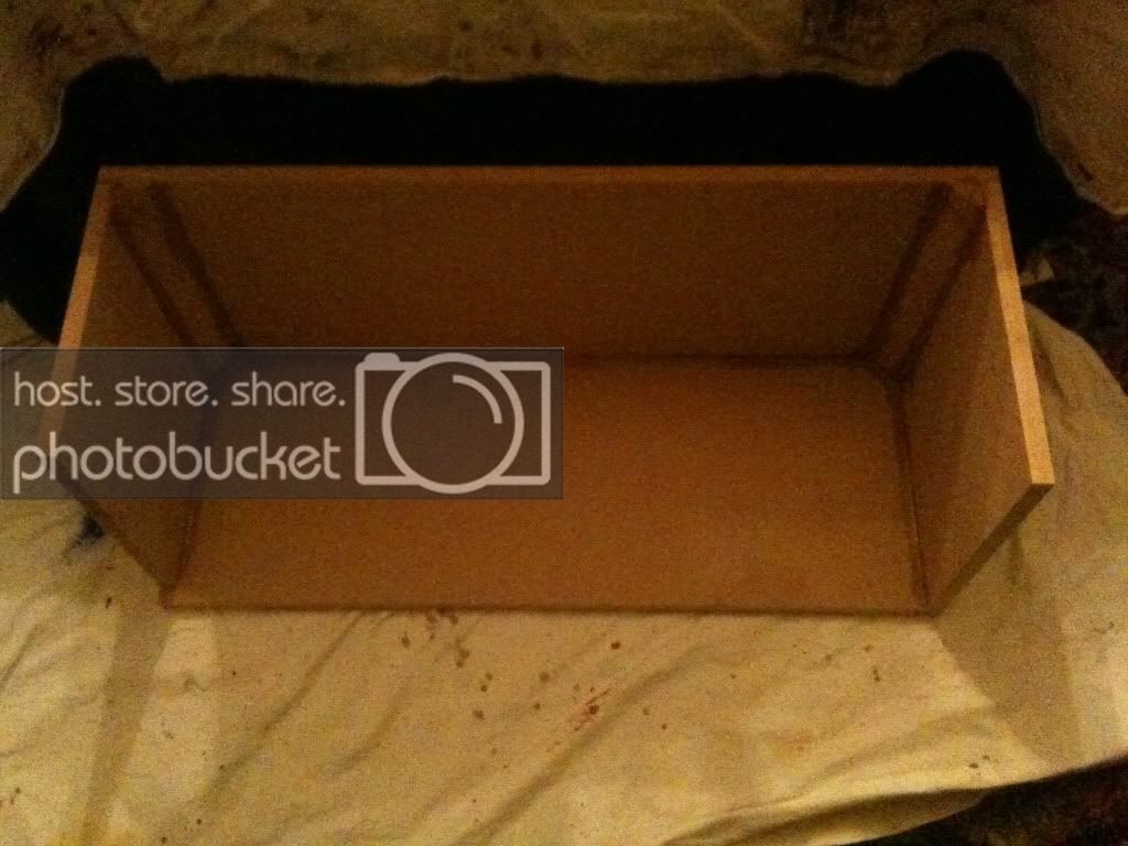

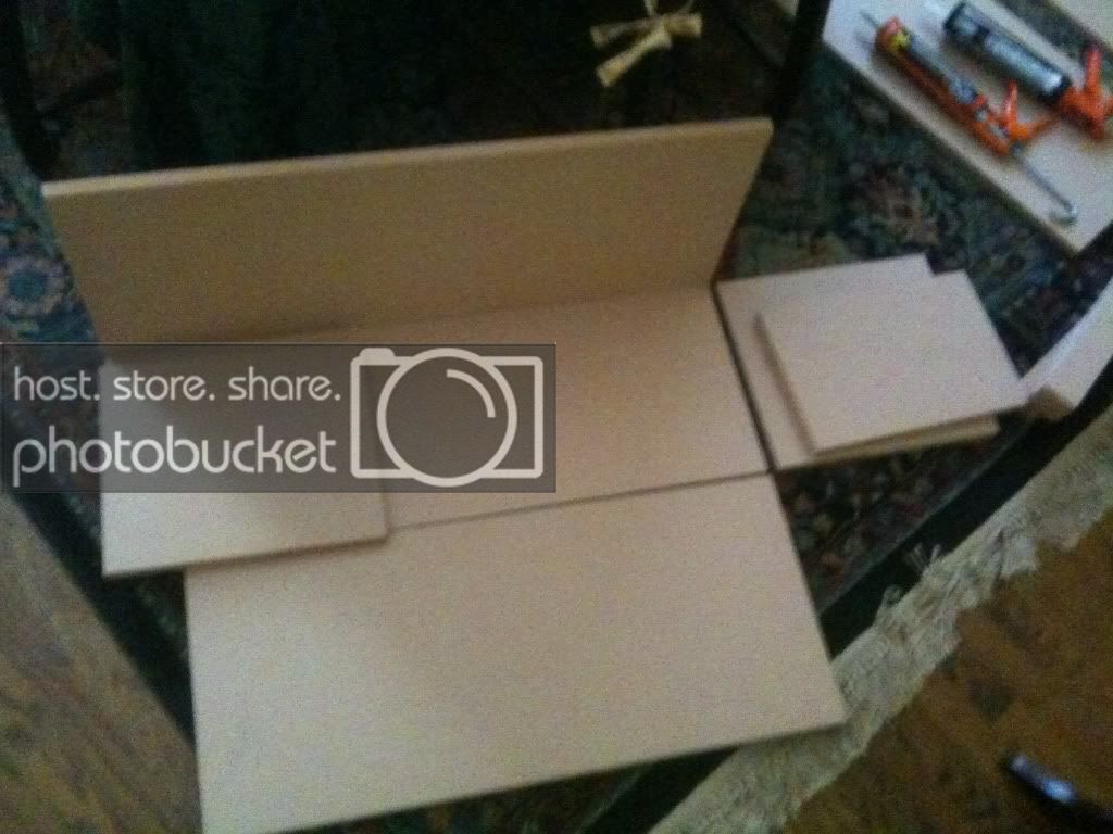

wood all cut and doing some pre test fitting

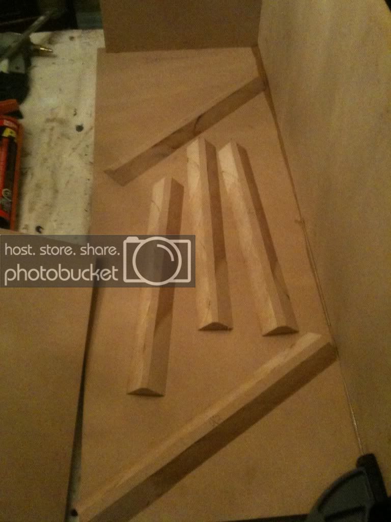

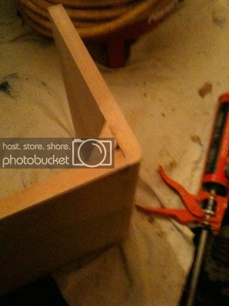

45's cut for corners and back cured

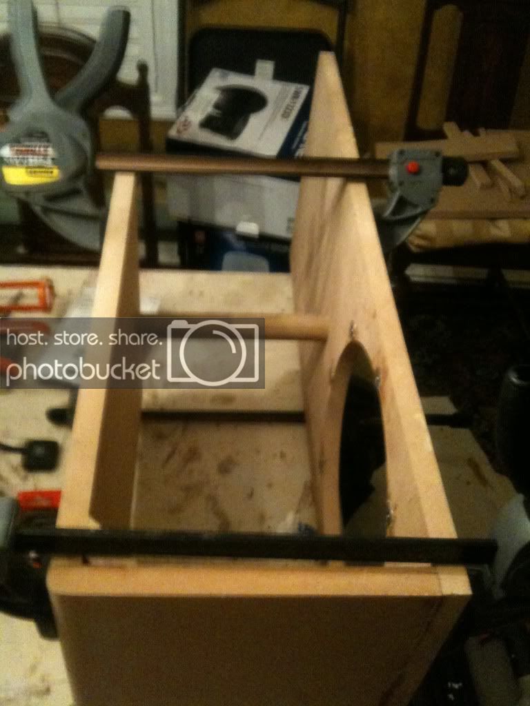

sides cured

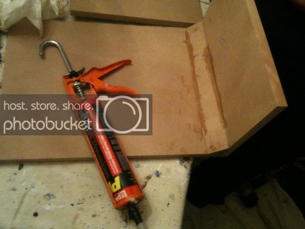

port wall glued and curing over night
45's curing over night

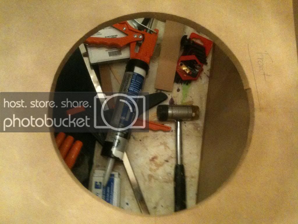

well... snowday tomorrow and I decided tonight was the night to get some work done. Tired of waiting to get a circle cutter for the router, so I busted out the jigsaw.
never used one before...did 2 practice cuts on spare wood and then did the real deal. turned out perfect. then i sanded her nice and smooth... next step is I have to decide about screws. thinking about not using wood screws so that I can remove the sub whenever without worrying about the mdf boring out too much over time.

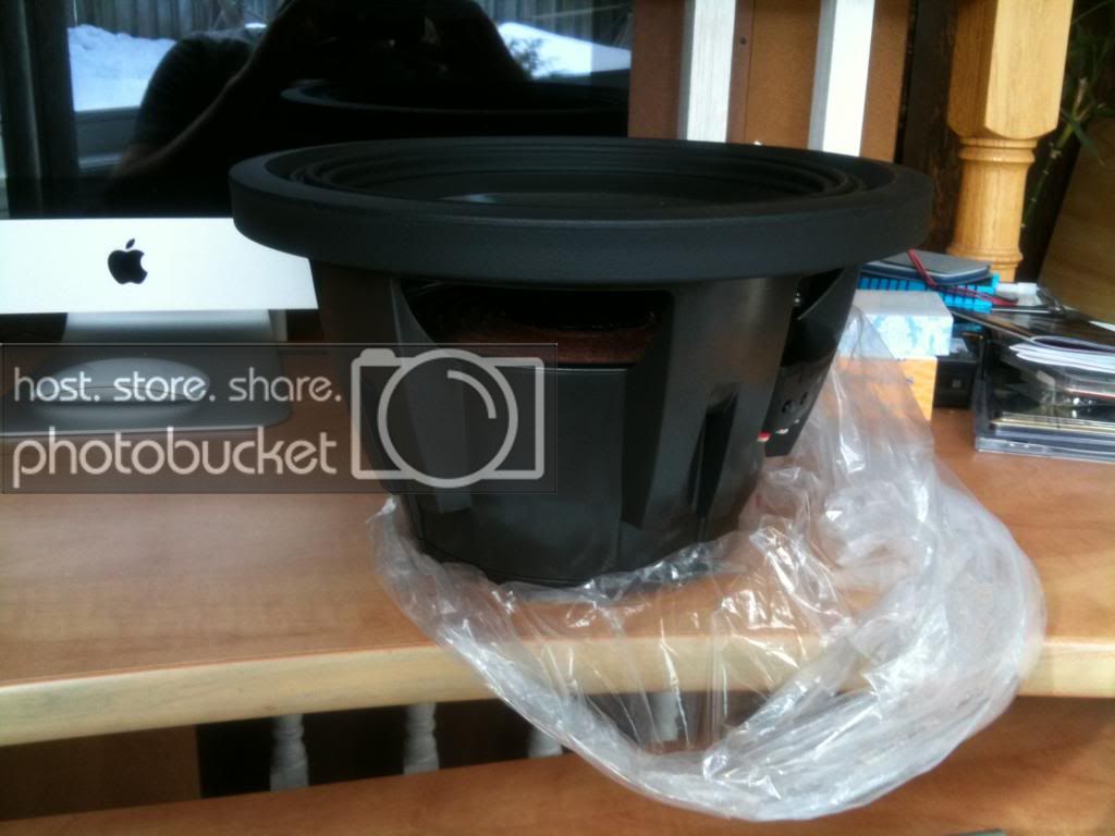

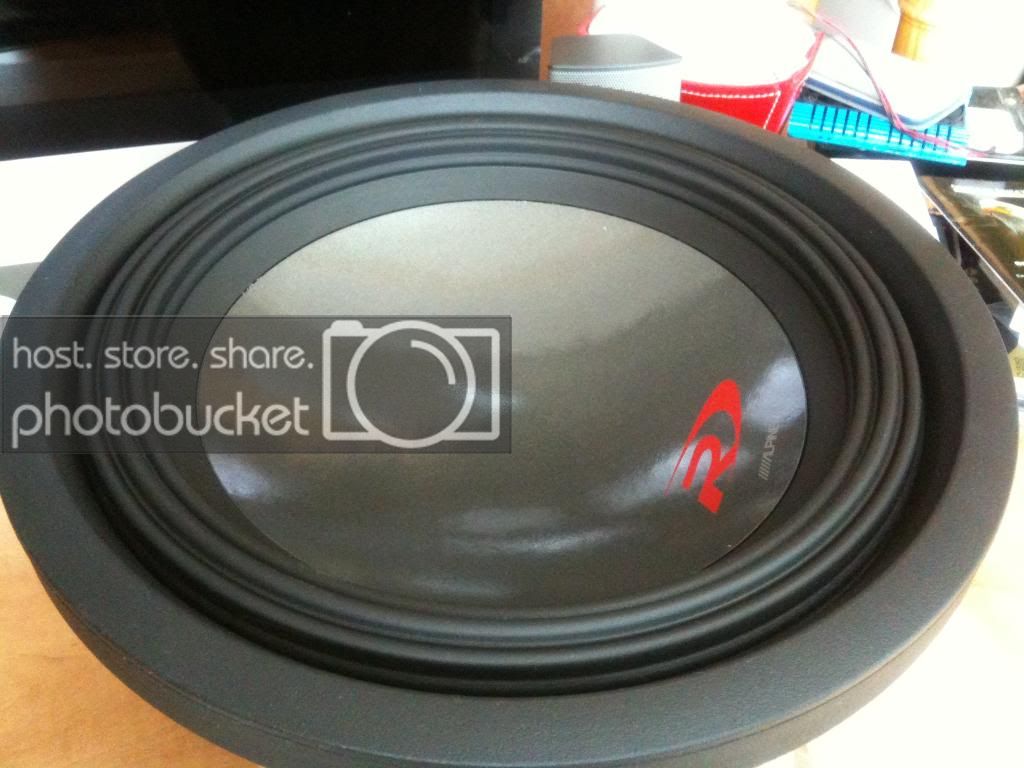

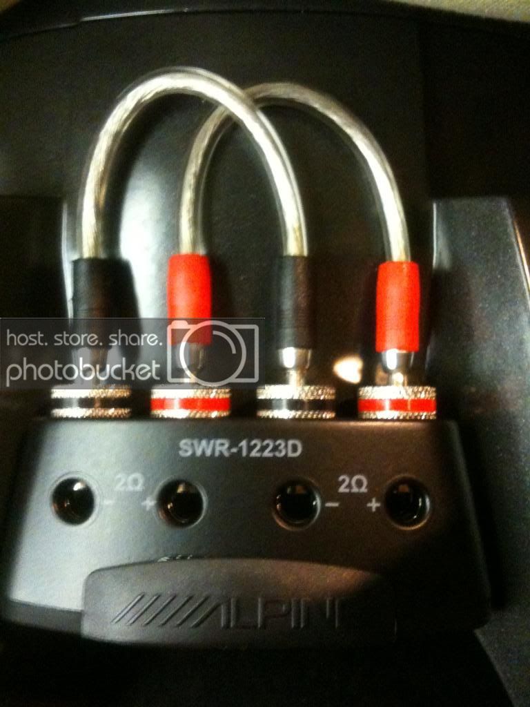

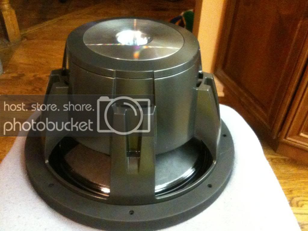

pictures of the sub and some first time jigsawing

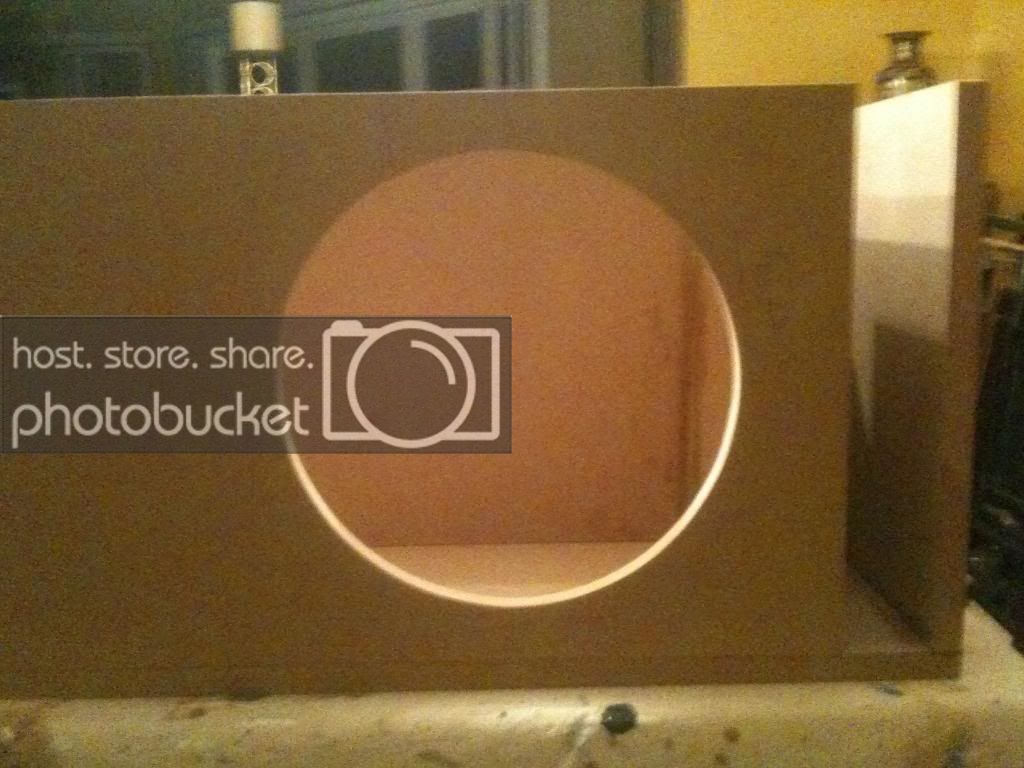

Sexy enclosure, nice job on the box build.
thanks. still gotta get the bracing on and the top...then i think im going to run it unfinished like this until the spring. then ill get the flush mount going and put a finish on the box. just unsure of how i want to finish it right now.

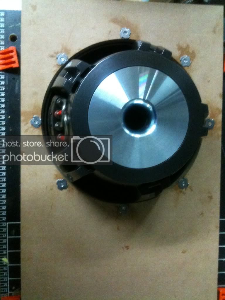

heading to hd to get t nuts
t nuts installed... put a little PL under them just so that they dont budge ever. 8 t-nuts, then #10x32x1" bolts. gotta the sub in and test fitted...everythings perfect!
