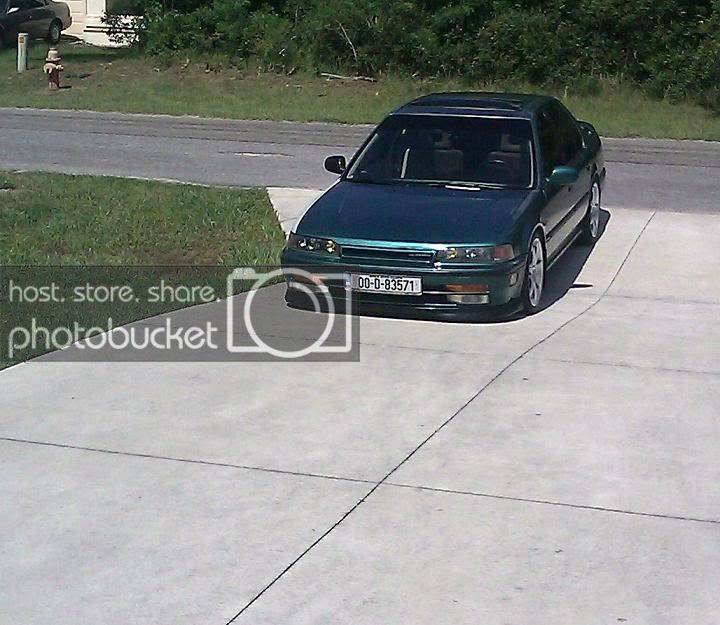

The car is a 92' Accord Ex. Ya I know I like old jdm style hondas just like everyone else....just not a civic kinda guy:

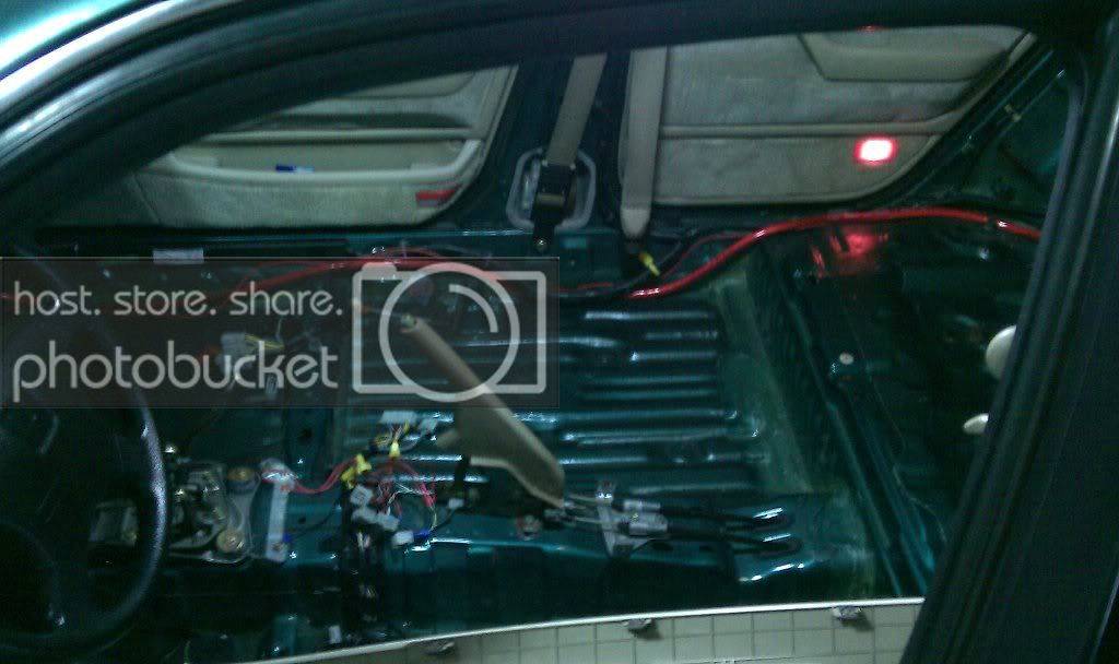

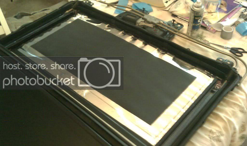

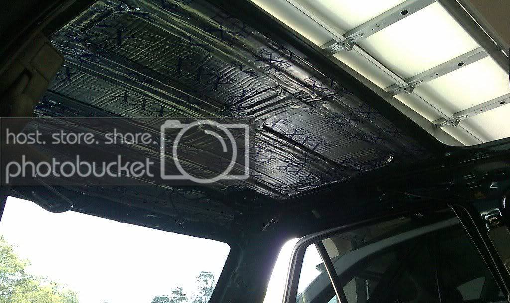

Then I got to work. First thing was sound deadening. I made the mistake of using fatmat. next time Im going with second skin. In fatmats defense, the rattletrapp 80 mil stuff seems to do the job as my car dosent resonate or rattle. I also used some mlv noise barrier. It was a 1/2 lb per sq ft.

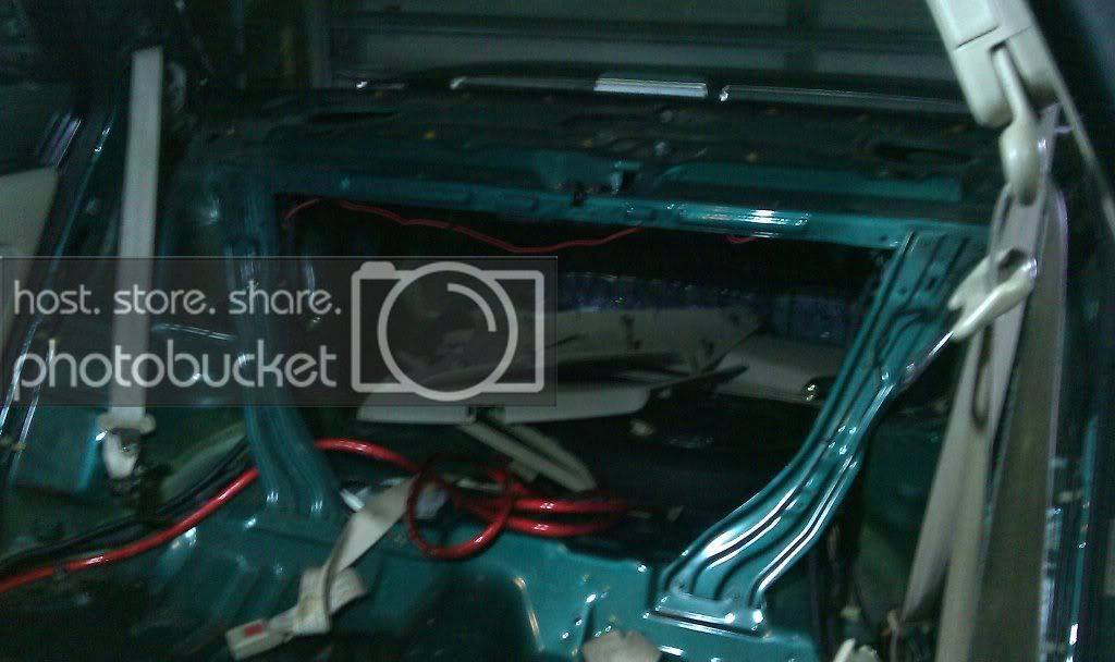

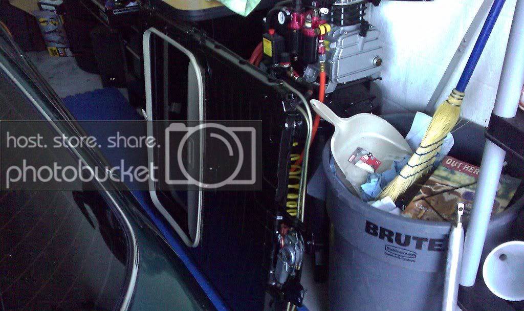

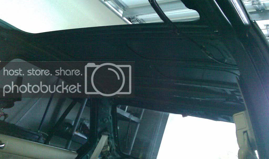

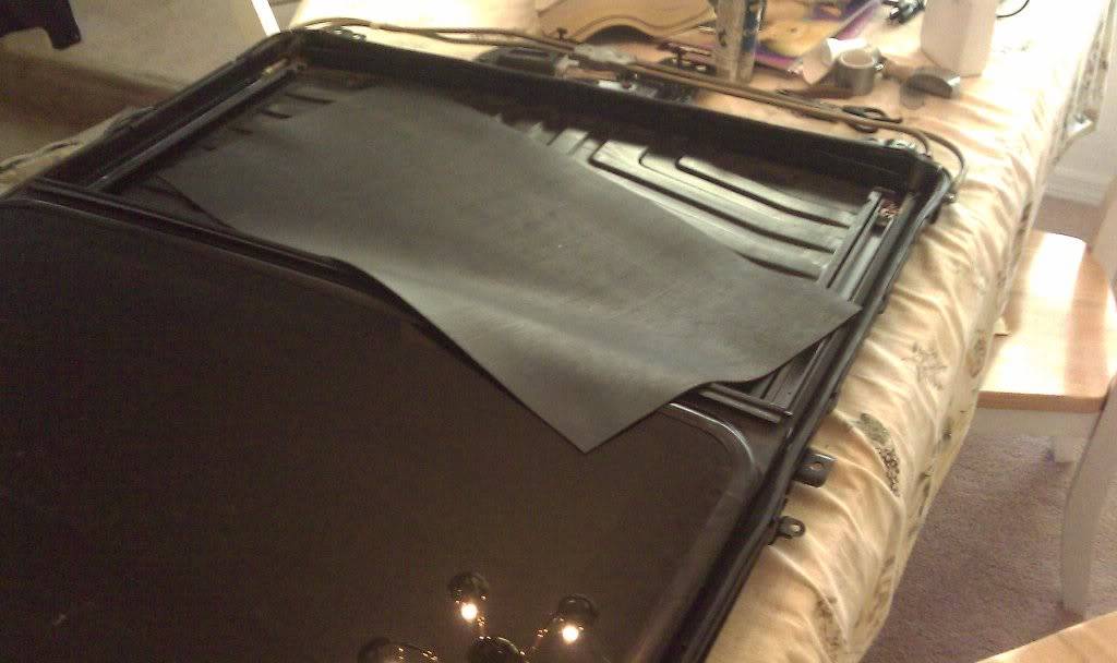

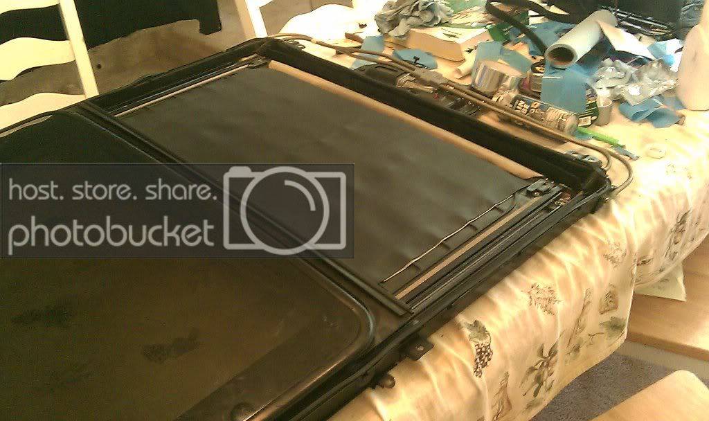

I removed my sunroof and used some fatmat on its panels and covered it with mlv where I could:
This was alot of fun to get out of the car........

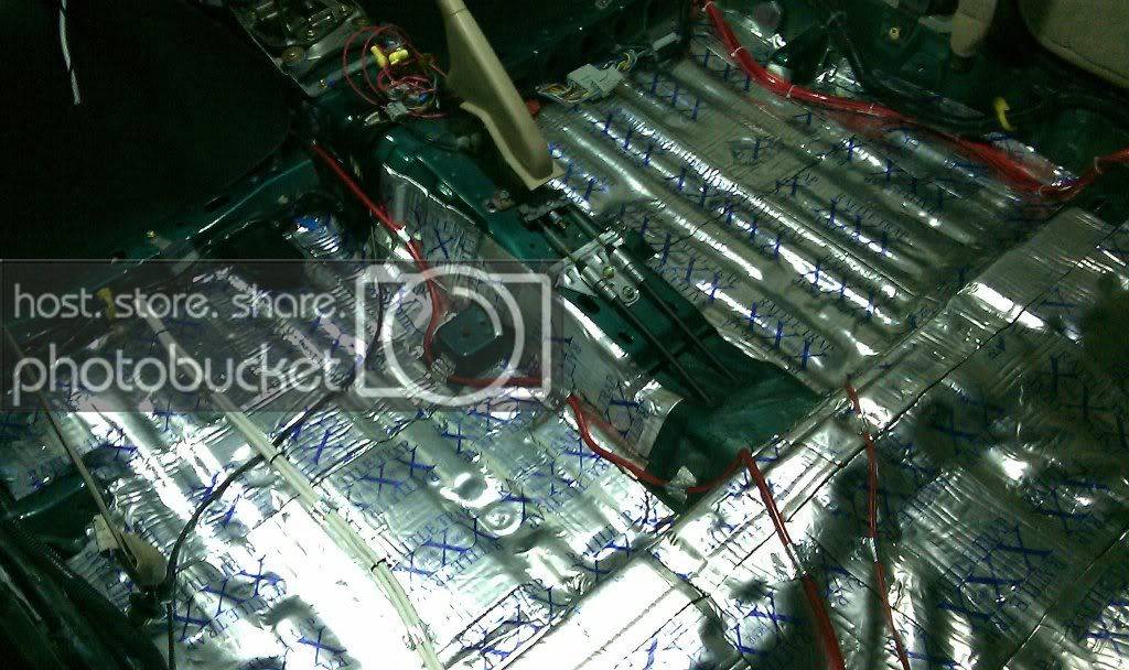

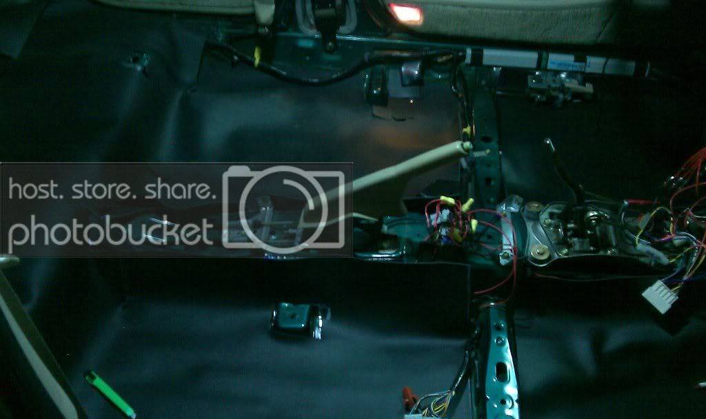

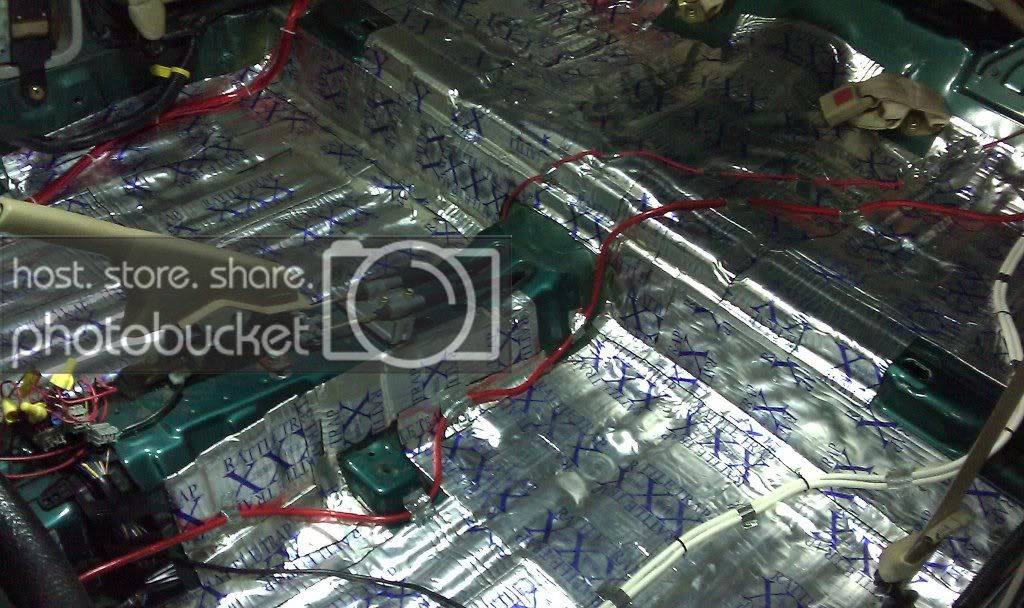

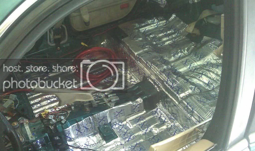

After I addressed the roof and sunroof I focused on the floor and rear deck i also ran all of the knu cl3 14ga for the comps, stinger helix rca's and the 0ga power run while I was at it... oh ya, the remote line too:

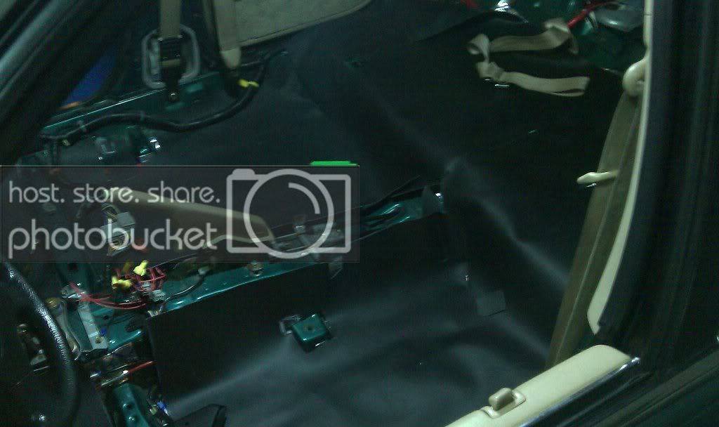

After I finished with the fatmat, I went on to the mlv. I learned that it was important to cover everything 100% with this and leave as few cuts as possible. so thats what i did:
I also have mlv over the rear wheel wells too... no pics though same thing with the fatmat in the doors.

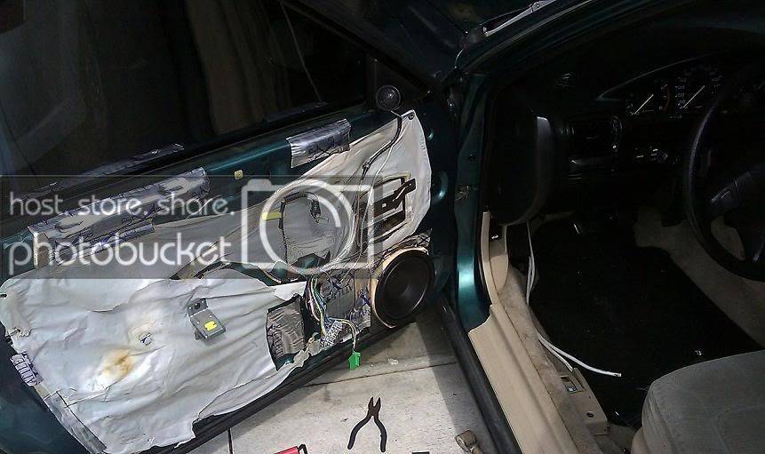

I went on to install the Image dynamic ctx65cs's next. Running the wire into the doors proved to be a pain in the ***. I didn't want to do it ghetto so I had to remove my fenders to get a clean run with grommets. The knu cl3 14 ga speaker wire is kinda thick with the amount of insulation on it-it is what it is.

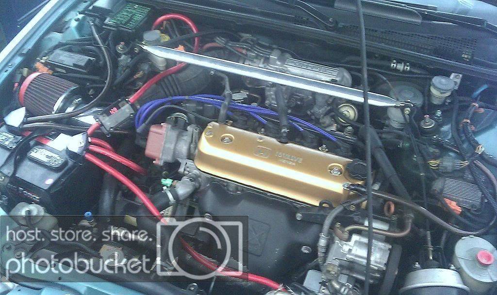

I also did a Big 3 with 0ga as well as replace the main ground and even the starter wire-not that that helps anything, but it looks better with all matching wire. In the near future, I will upgrade this battery to something like a yellow top or hc 1400 o5 1800.:

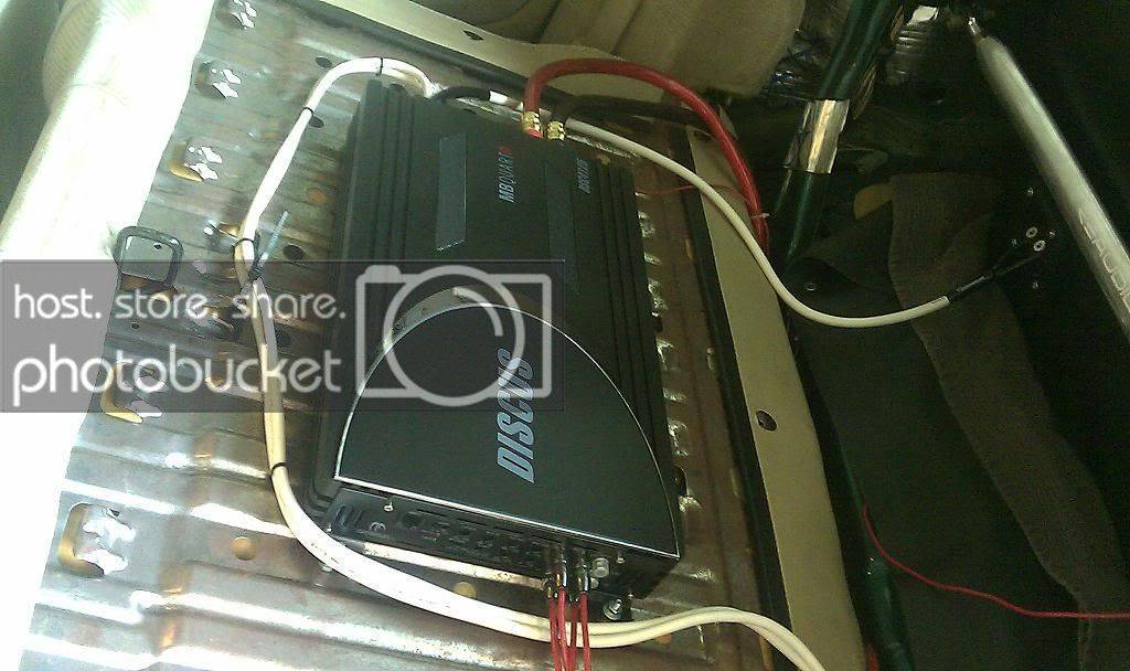

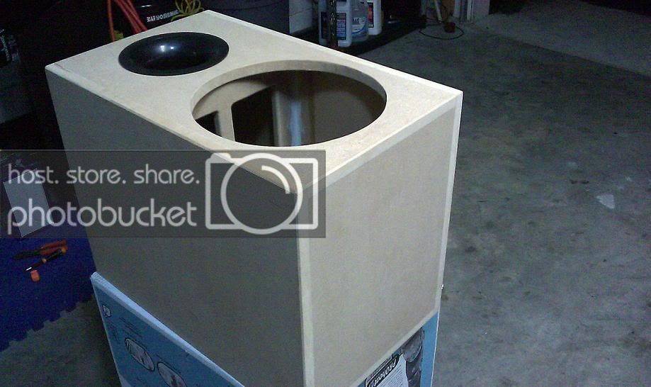

I next took myself to school on box building. I had some input from members here and then had a member design me a simple box for my RE se/x 12d2. I wound up going with 2.2^3@ 33 using a 4" aeroport. The reason for the slightly bigger than spec size box was due to my current choice of budget amp, an MB Quart 4125. I only have 500w rms to feed it. Heres my handy work:

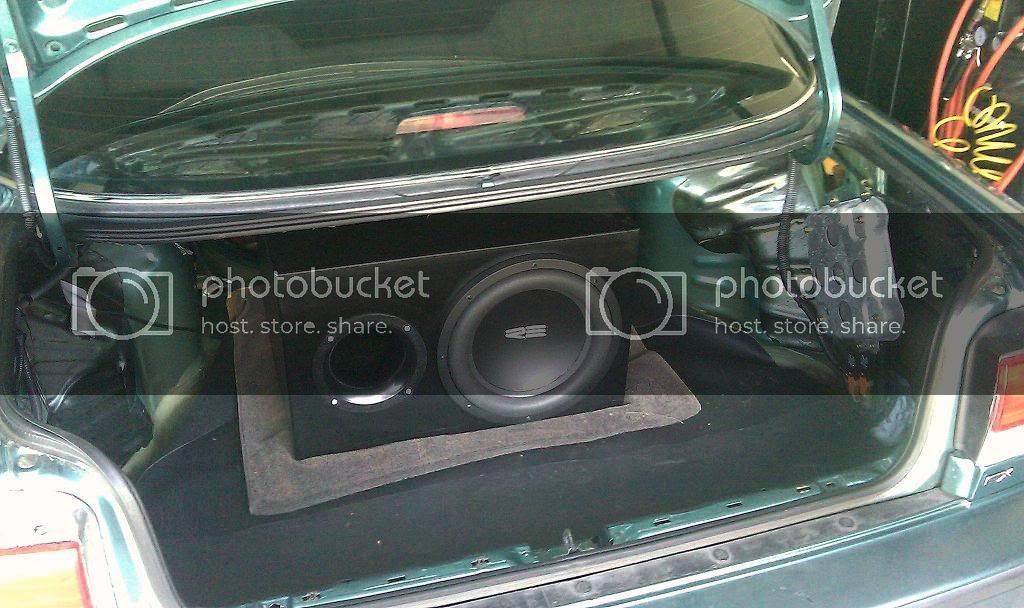

Then I just painted it. My trunk is not finished yet, its ***** right now with a towel under the box and some mlv. I have to build a new floor and install new carpet.:
The amp is also the same way. no carpet right now. I have to get it back in there!
