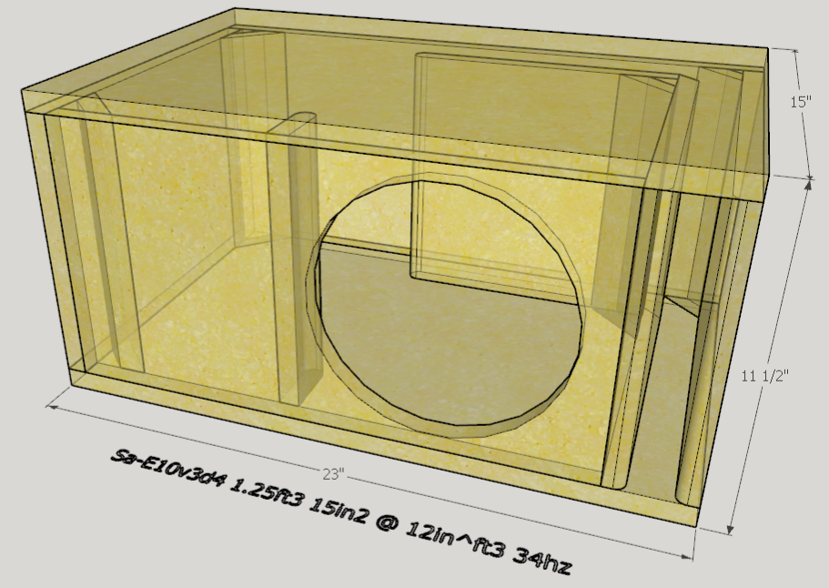

This is 1.25ft3 net for reference

I have a good amount of experience, would say my skills are up to par.  but my shoulder is broken/seperated.. so that's why iv'e been looking for a prefab between 1.25-1.5 cubes @ 34-36hz.  I just failed to understand that you must separate port volume from the open space behind the sub : [
Soundqubed has this layout @35hz:

you can buy a prefab for a 12 and then make a baffle for a 10 and it'll be the right airspace 😁😁😁
Great idea, and so simple..thank you!  With $55 down the drain on the last box, and no income for another month (injury), the most reasonable choice is to wait, buy a $30 sheet of 3/4 birch and build the box.  That's the plan.
