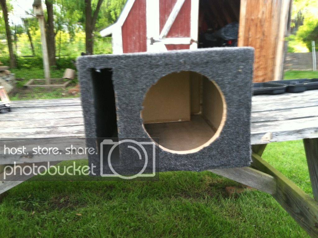

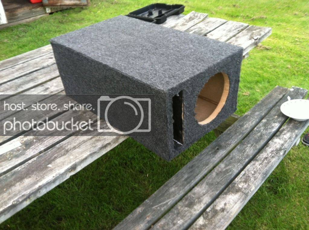

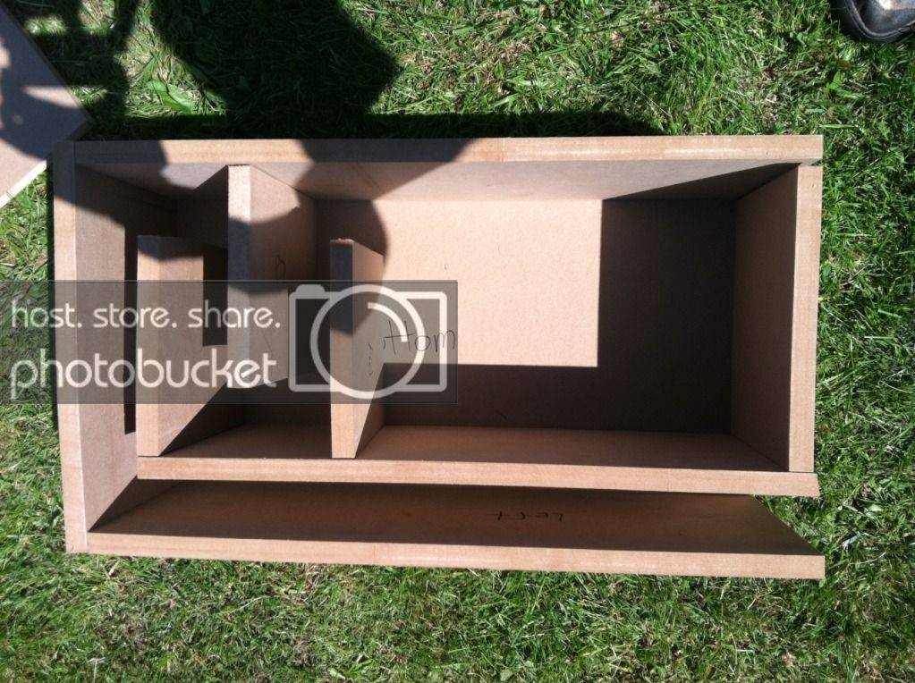

between now and wednesday im going to be putting a system in my buddy's 07 cobalt. here are some pics of the box:
This is before anything is glued and screwed. just to show the internals

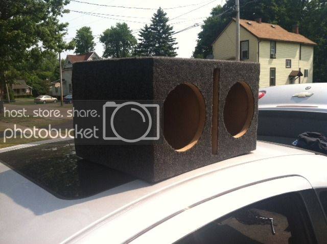

This is the front of it all carpeted. Not to happy with how it came out, i didnt have a proper razor and sissors. had to work with what i had.
Here is an angle shot of the box.

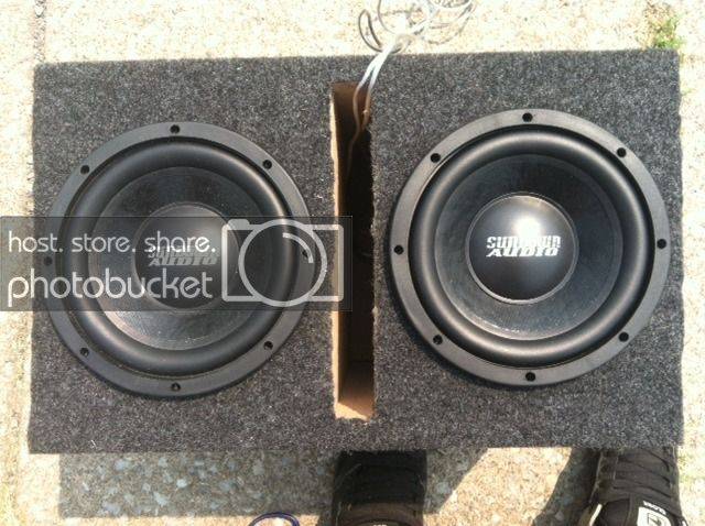

Two sundown e8's ftw!:

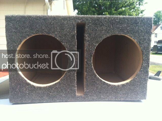

Front View of the box, right around 15 square inches of port, 1.1 cubic feet after displacements, tuned to 34 hertz:

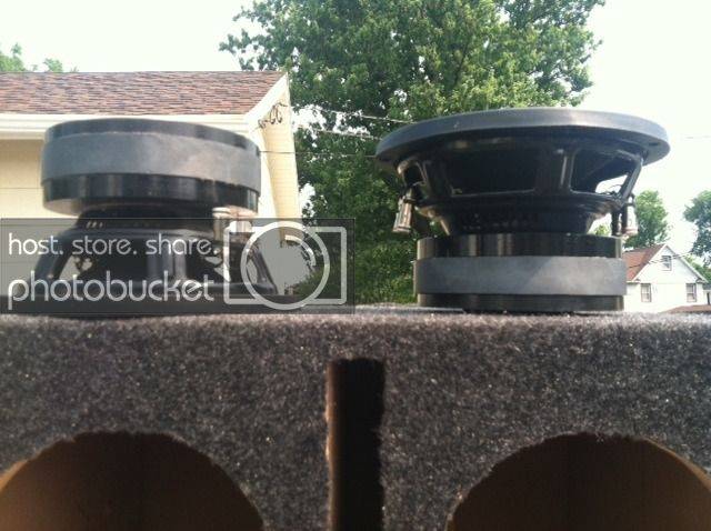

The side view of the box:
Pic of the subs installed:

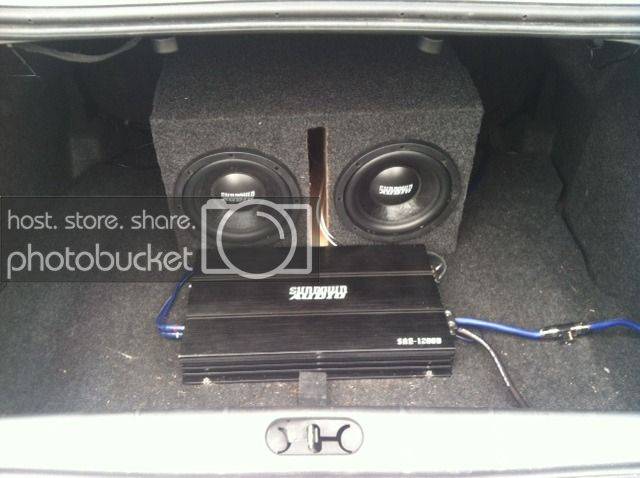

The final install:

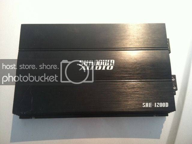

My thoughts overall, the two e8's get way louder than the one we had in there obviously. They hit pretty hard. i have them on double the rms at 400 watts a piece and they are taking them like champs. i know its not the cleanest install ever, but he didnt want to cut up his carpet and having the wires running along the side was the best i could do.
