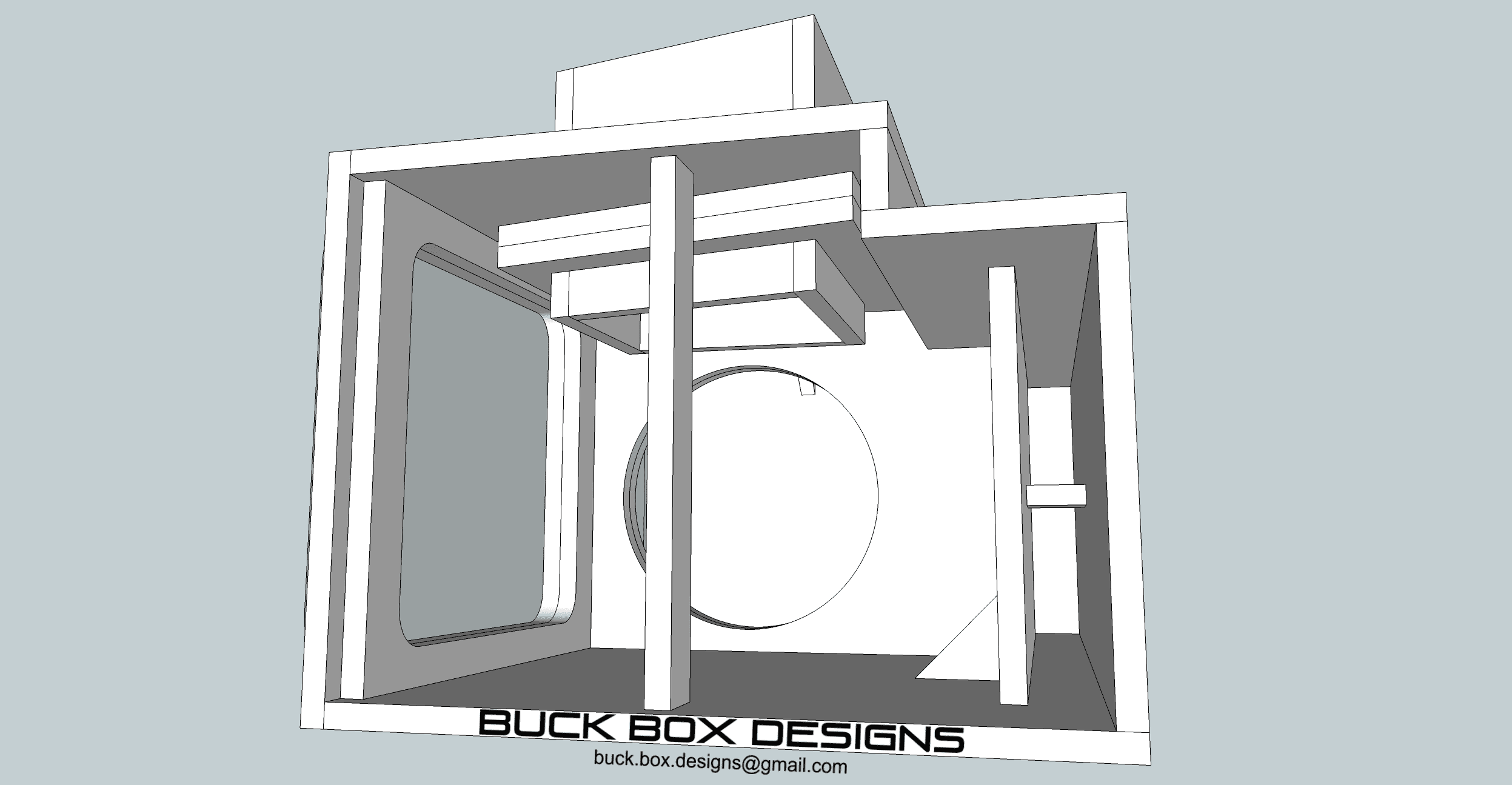

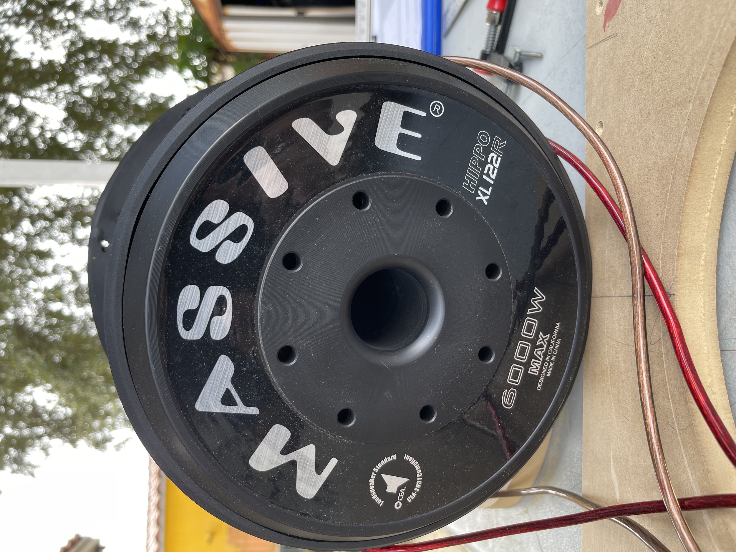

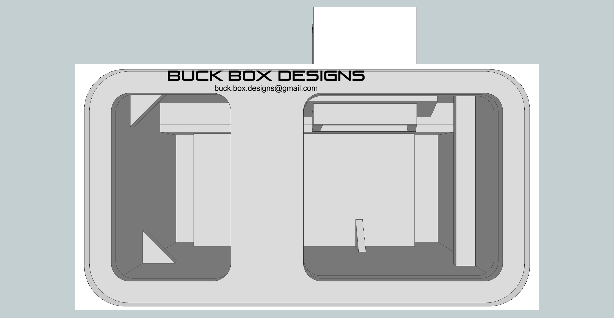

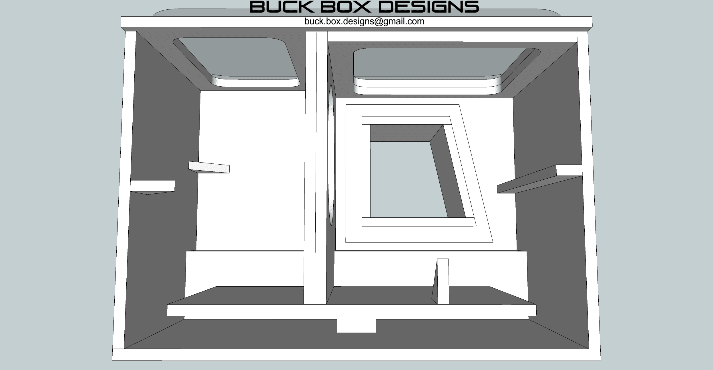

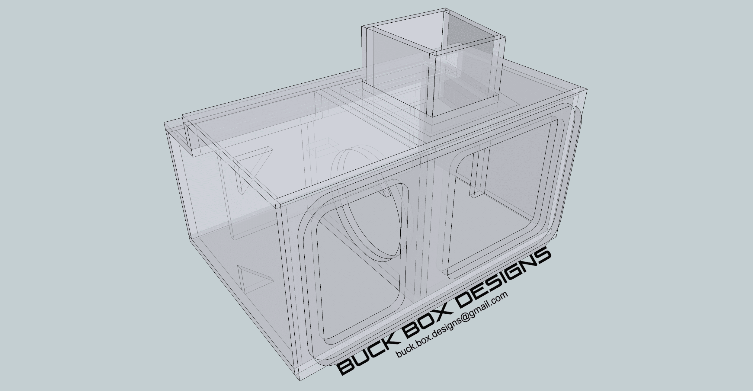

Massive Audio Hippo XL 122R (3000w RMS, 4" VC, 12" Sub) series 6th order bandpass going in the trunk of car and blowing through the rear deck.
This one took me a little while. Made the front port removable through the window hole that the sub mounts through, that you access through the removable window on the back of the series 6th order bandpass rear deck blowthrough box, lol. This whole box can be slid in and out of the trunk with the front/top port removed. Laying this out for a powerful sub with a high Fs like this Hippo is difficult, because the ports have to be fairly big. 3000w RMS 12's move a lot of air, naturally.

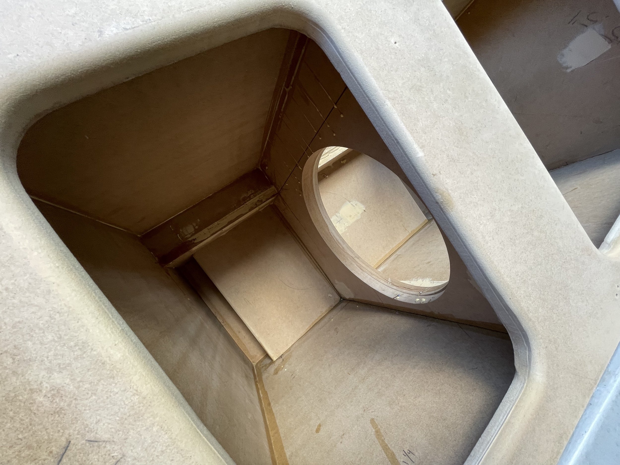

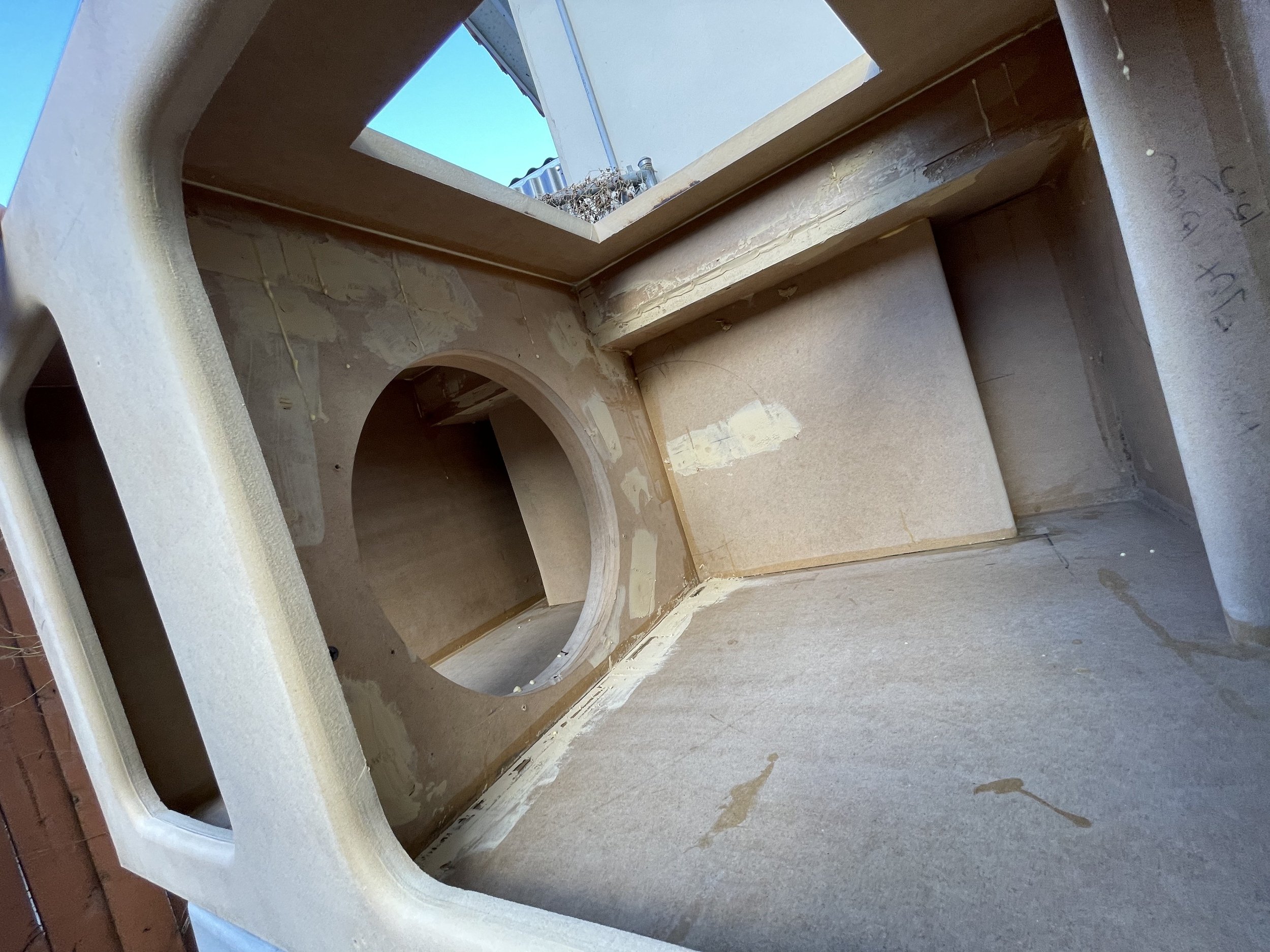

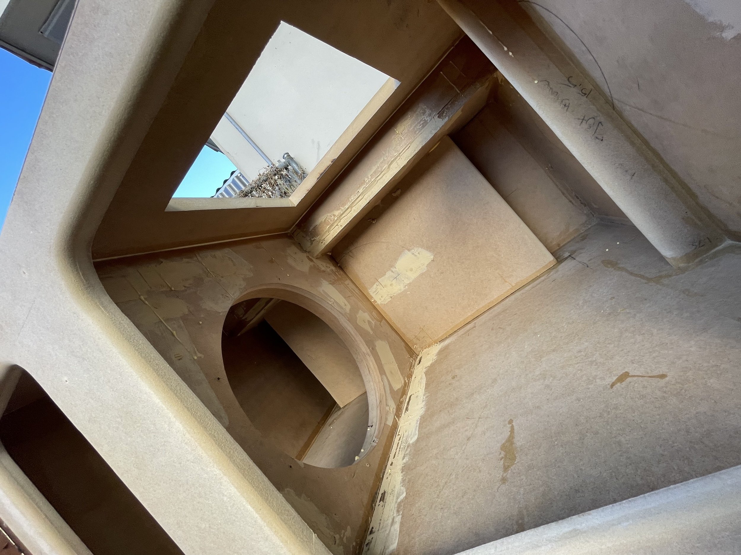

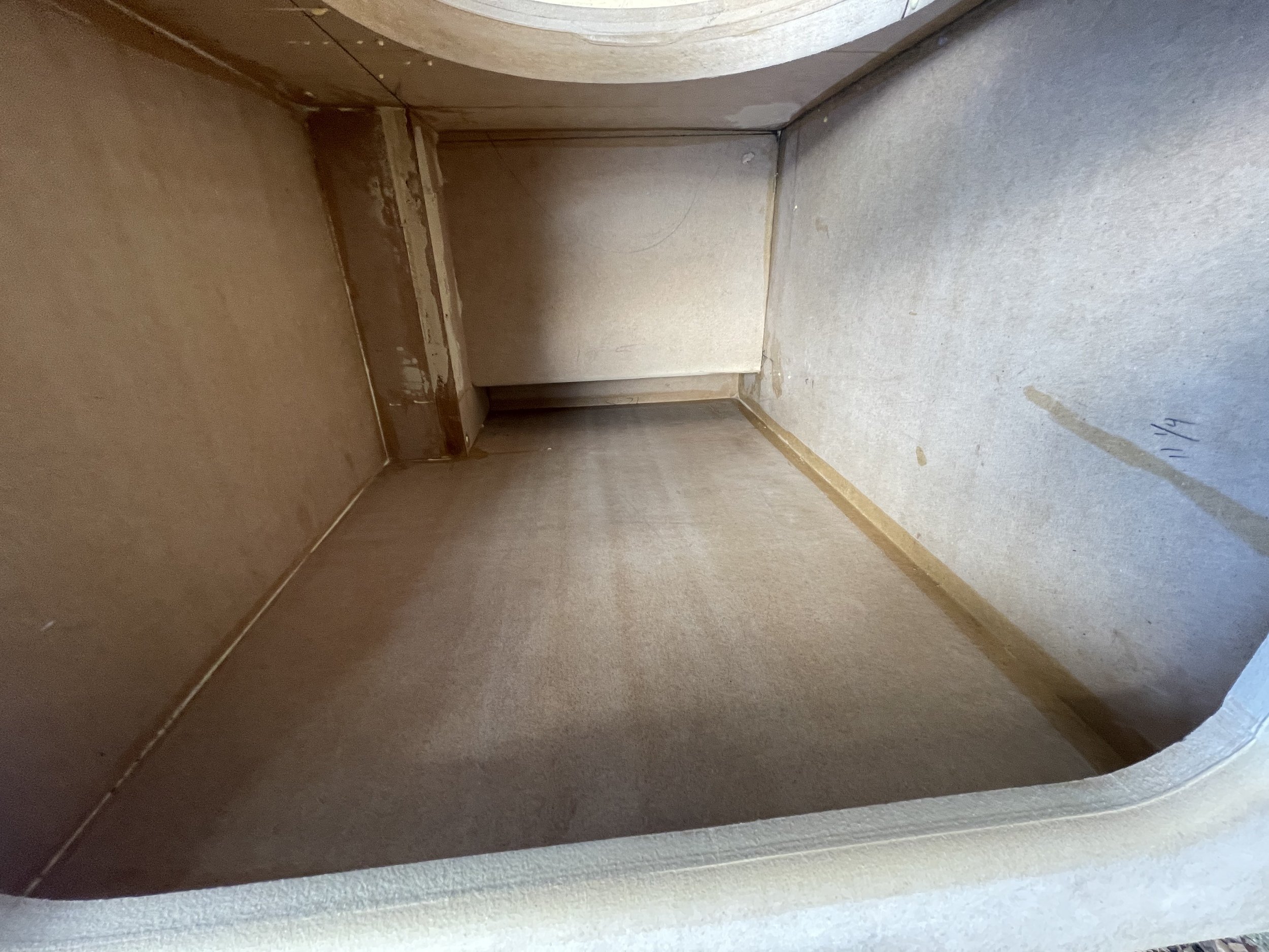

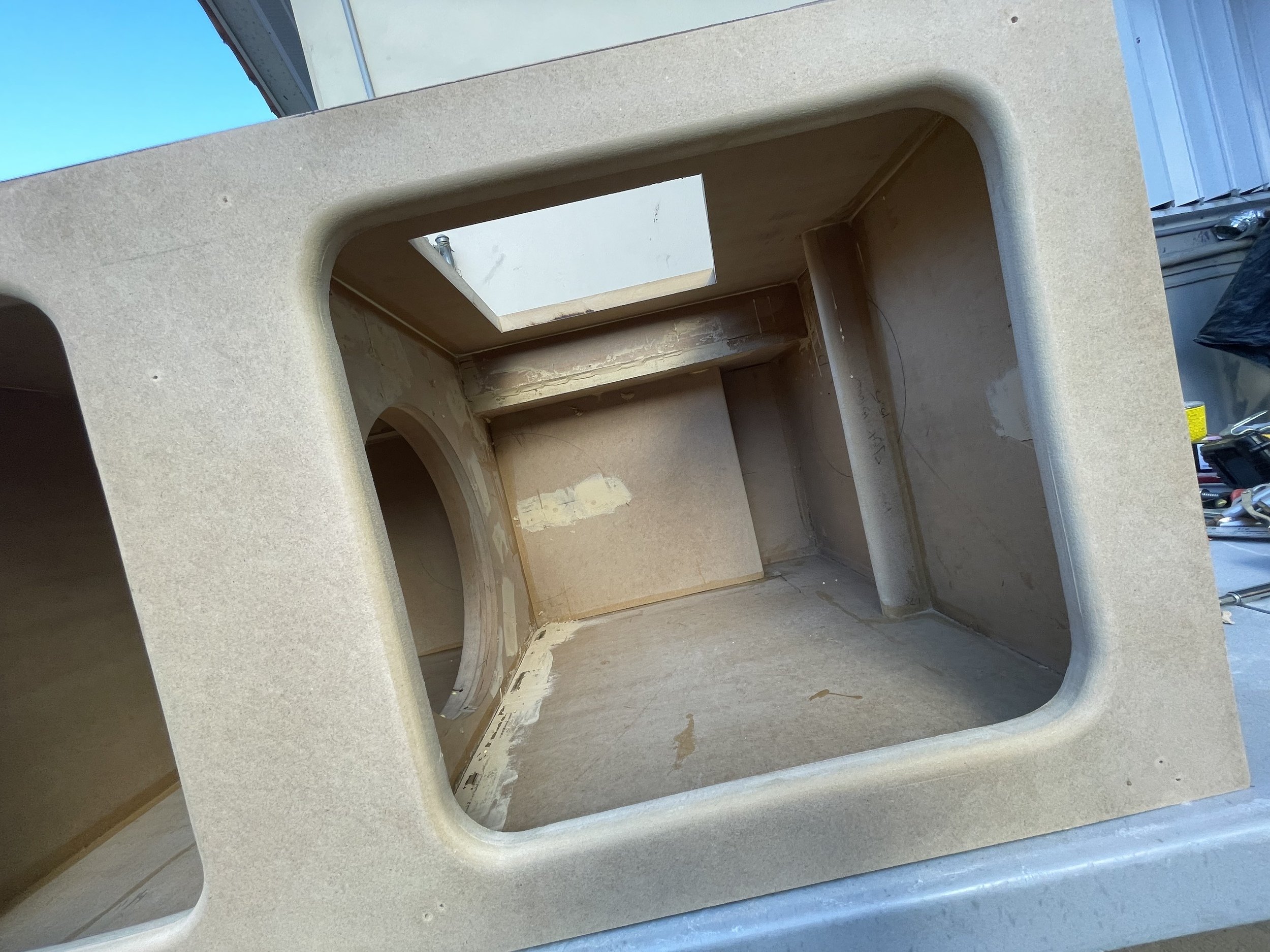

I got some box build pics of this one, too, as well as sub pics. I think he's gotta work on the rear port wall that's in the rear chamber, it wound up being slightly closer than it was supposed to. It happens, I've done it before 👀
I think this box is going to wind up looking very nice. This sub is 3000 watts, so it's going to be some bass. The owner isn't rushing to build, just taking his time. I can't wait to see that big window on the backside of this one and that huge Massive motor.

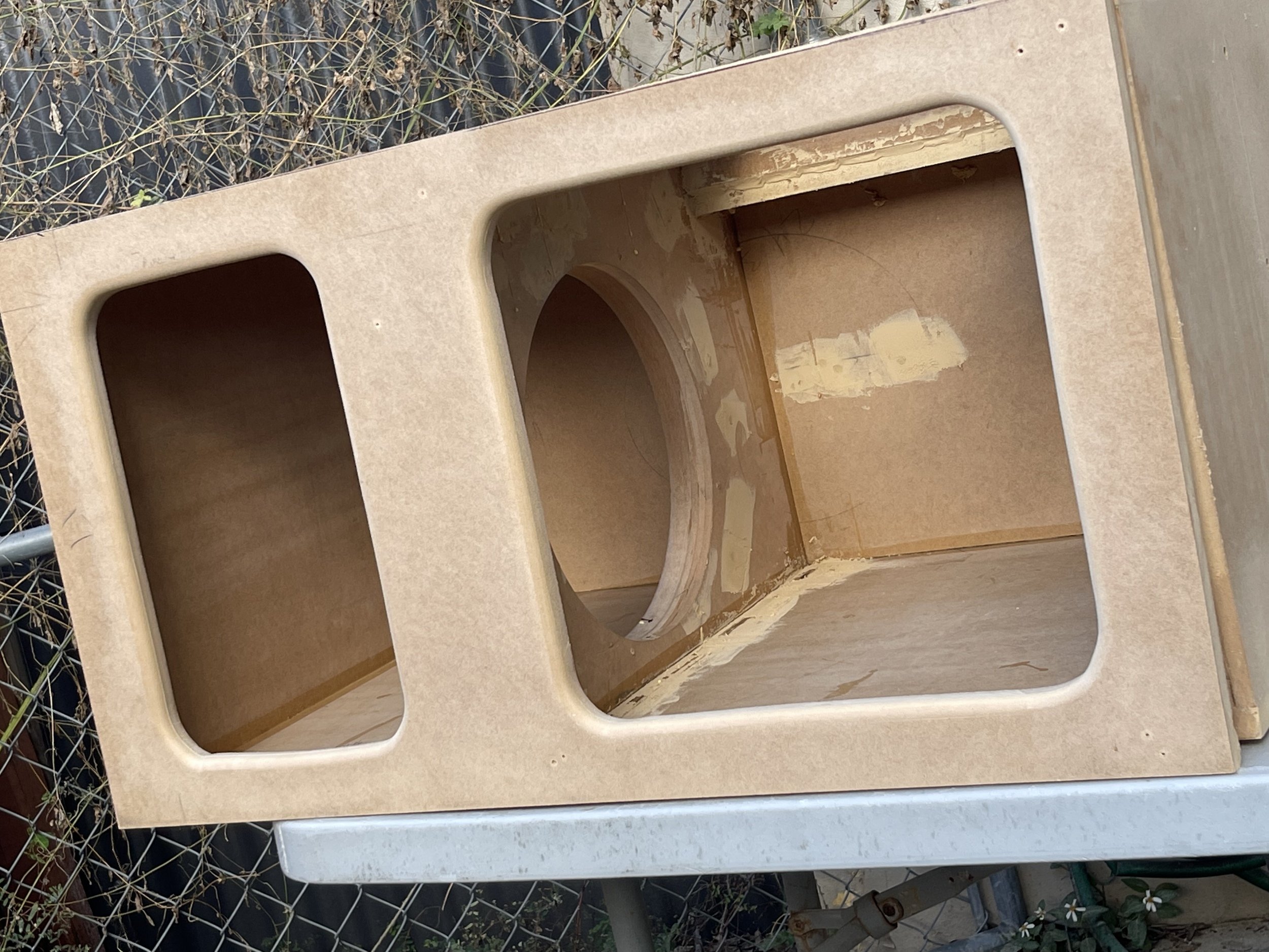

Got some build pics! I was exited to see this one. This is the first VXF (it's a 12") that I've done a bandpass for.

Box building quality looks pretty good to me. I think it's going to get some more beautification over time.
He should've just used MDF instead of the plywood that he used. Why do people still buy that stuff?
Because I got it for free. 🤷‍♂️
Little extra time with wood filler but it's getting carpeted anyways and I despise mdf dust.
No worries. I just can't stand the hollow spots in the cheap "Birch". I won't even call it Birch anymore. A thin veneer of Birch doesn't make it Birch. A lot of people actually think that MDF sounds better anyway. MDF dust or Birch dust, just sweep it up and toss it. I've never heard anybody shit on good MDF (there is a difference) because of the saw dust.
Maybe I've never used mdf of a good enough quality, but my problem is with the airborne dust. My jigsaw and router don't have vacuum connections and my sinuses get real fucked up from that amount of sawdust. Gives me a pressure headache for like 16 hours. Masks help but minnesota winter means I'm cutting in my garage and the shit lingers lol.
There’s no difference in the type of wood used other than looks. Some people act like wood snobs, as if real Baltic birch sounds better than cheap birch, or MDF sounds better than pine. None of that matters for sound.
Personally I've never been able to hear a difference but I can't say with 100% certainty as I dont know the numbers behind their different resistances to flex or if the surface could effect air drag to actually make a difference 🤷‍♂️ shit bumps that's all I know 🤣
