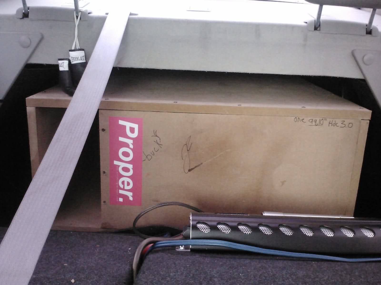

Buck Box Designs /// 6th order AQ hdc3.0 single 10"
I would like to know how firing the rear port into the front chamber works? Does it act like a normal 6th order because the front port has unloaded?

Fine Tuning still being done, Got another photo! But the Vid will have to come another time sadly =/ Still gotta work out some small kinks.
