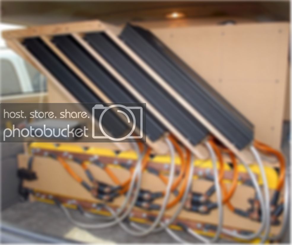

My (4) are in 12 ft^3 tuned to 35 Hz with 204 in^2 of port area. Peaks at 36-38 Hz.
I really like the BTL's.
Still on the hunt for 160 in my daily driver. . .
Brian
ahhh, so you are at 3 cubes each and still getting good low end, plus more upper end.
figured as much, but by the time i was thinking of doing another box to try to strengthen the upper end, i didnt want to recone the btl and sold it as is. i was running in low tuned in 4.5 so the low end was pretty strong as you can imagine
That was all the room I wanted to take up. By the time I got the amps and batteries in the back, there is not much room for groceries //content.invisioncic.com/y282845/emoticons/biggrin.gif.d71a5d36fcbab170f2364c9f2e3946cb.gif.
Brian
