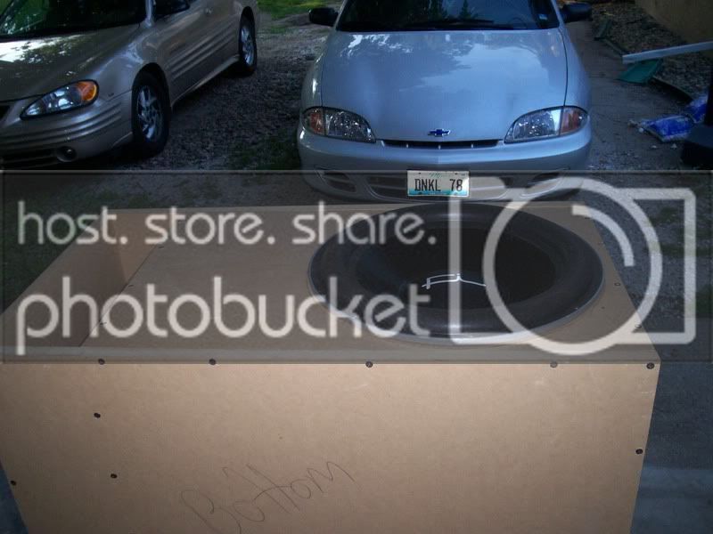

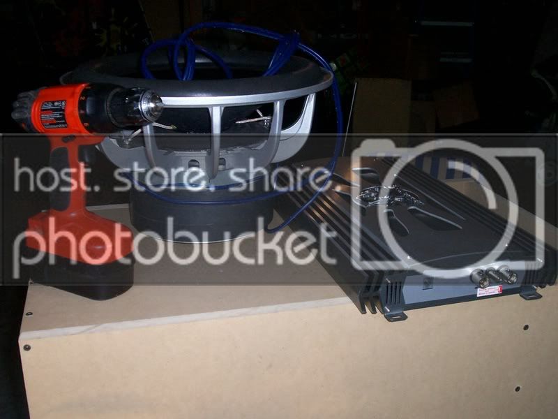

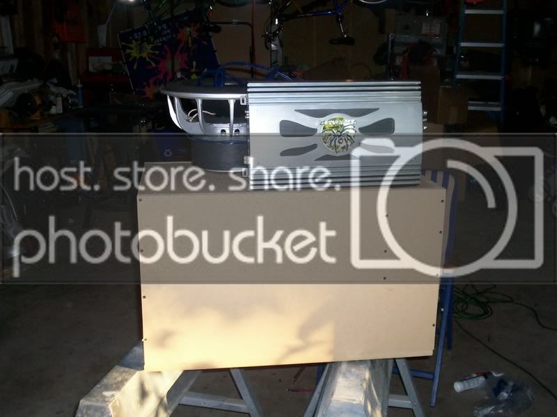

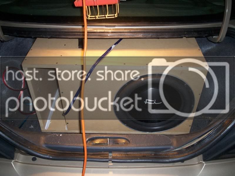

This is my build including a BTL 15 d 0.7 fully loaded in my 01 Grand Am. Powered by my SoundStream PCA 2000d. The sub actually reads 1.2 ohm so thats pretty cool.

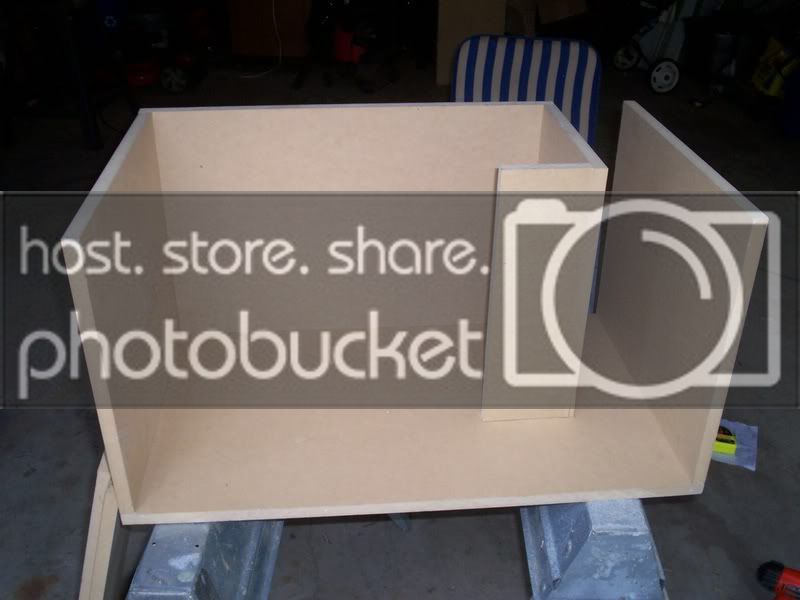

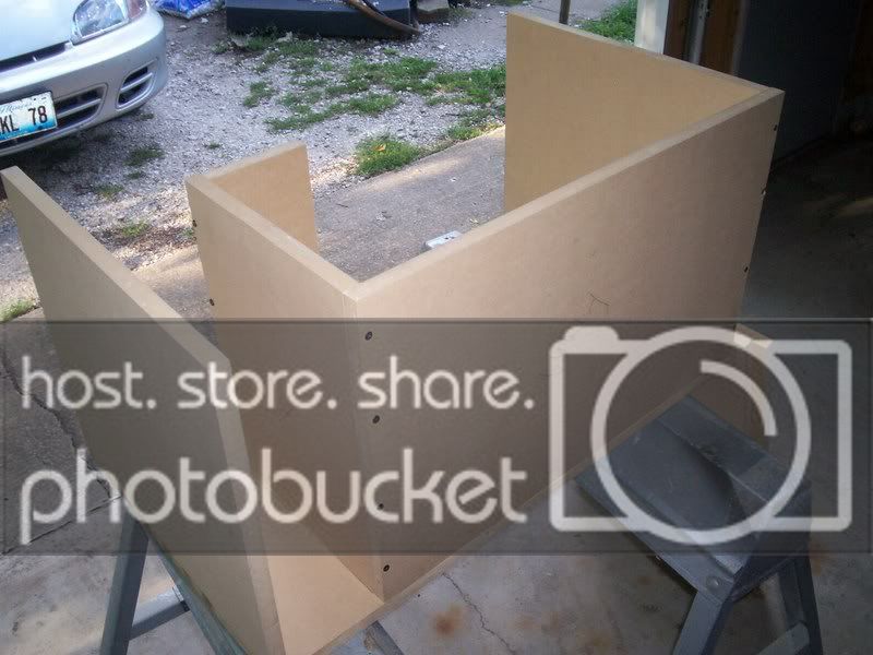

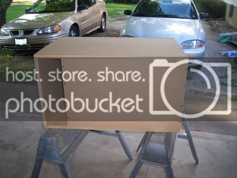

Internal lengths
heigth = 16
depth = 17.5
width = 30
4.86 cu ft total
PORT LENGTHS
height 16
width 5
depth 18
displacement of port is .78 cu ft
port go down 12.5 , then go right 5.5
tuned @ 45 hz
with alot of HELP from ZEUSILICIOUS ON ca.com
Thanks Man
ya the last photo had the light on it because it was actually DARK out...i was workin on it all day...
Hope ill do good at the comp on sunday July 29th!!!
yeah ive been thinking of addint a brace with a cut down 2x4..with music so far it sounds good...ima test it when test tones thursday and if it sounds like its flexing im going to defiantly stick a brace in it
Everything looks great man. Nice build. I'm waiting on my 15" BTL to get here right now. Just one question though, those measurements seem small to be 4.8 cubes. the box plans i have are 40L, 17.5H and 18W. after port and sub displacement i end up with 4.5. Is there a typo in your measurements?
pretty sure the ~5 cubic feet is gross volume, not net. I just built a box of almost identical dimensions for a 15'' Fi Q, it was 3.5 net and 5 gross volume
by the way, are you not going to use the rubber mounting gasket? It helps seal up everything where the sub mounts, and it looks nicer imo
it is a nice sub!!!
thanks again chris!!!
and the measurements are correct i believe...i dont really feel like doing the math right now...
And i actaully didnt put the gasket on because i had to mount it in the car and i culdnt have it already in the baffle and its a really heavy sub...and i had to do it alone...yeah...if i can get someone to help me do it i will ...
