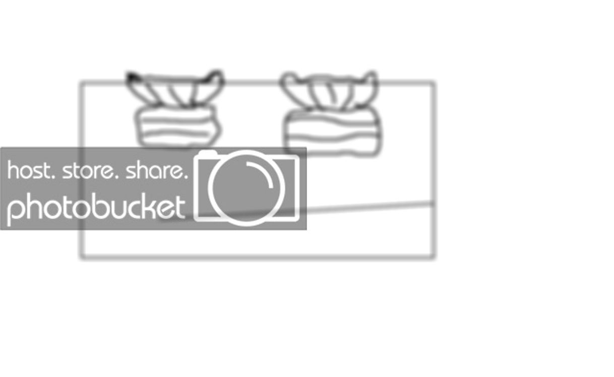

here is the basic concept of the box, the sub to the right is the one that gets warm. Its furthest from the port.
and yes, the nightshades are that huge lol
ya that right sub might be gettin a little choked there depending on how much space it has. it def could be your problem.

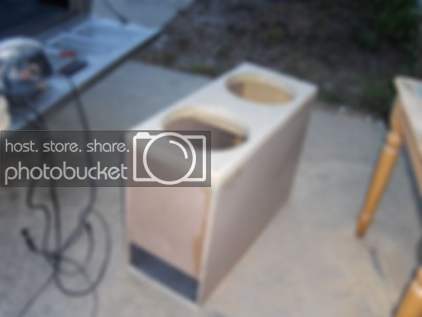

btw, heres a pic of the box, it came out pretty good. too bad i might have to scrap it //content.invisioncic.com/y282845/emoticons/crap.gif.7f4dd41e3e9b23fbd170a1ee6f65cecc.gif
good lookin box. just started mine today, hopefully it will come out lookin somethin sexy like that. i hope thats ur problem tho, cuz, like u said, it's alot easier to build another box than ruining spendy subs!!

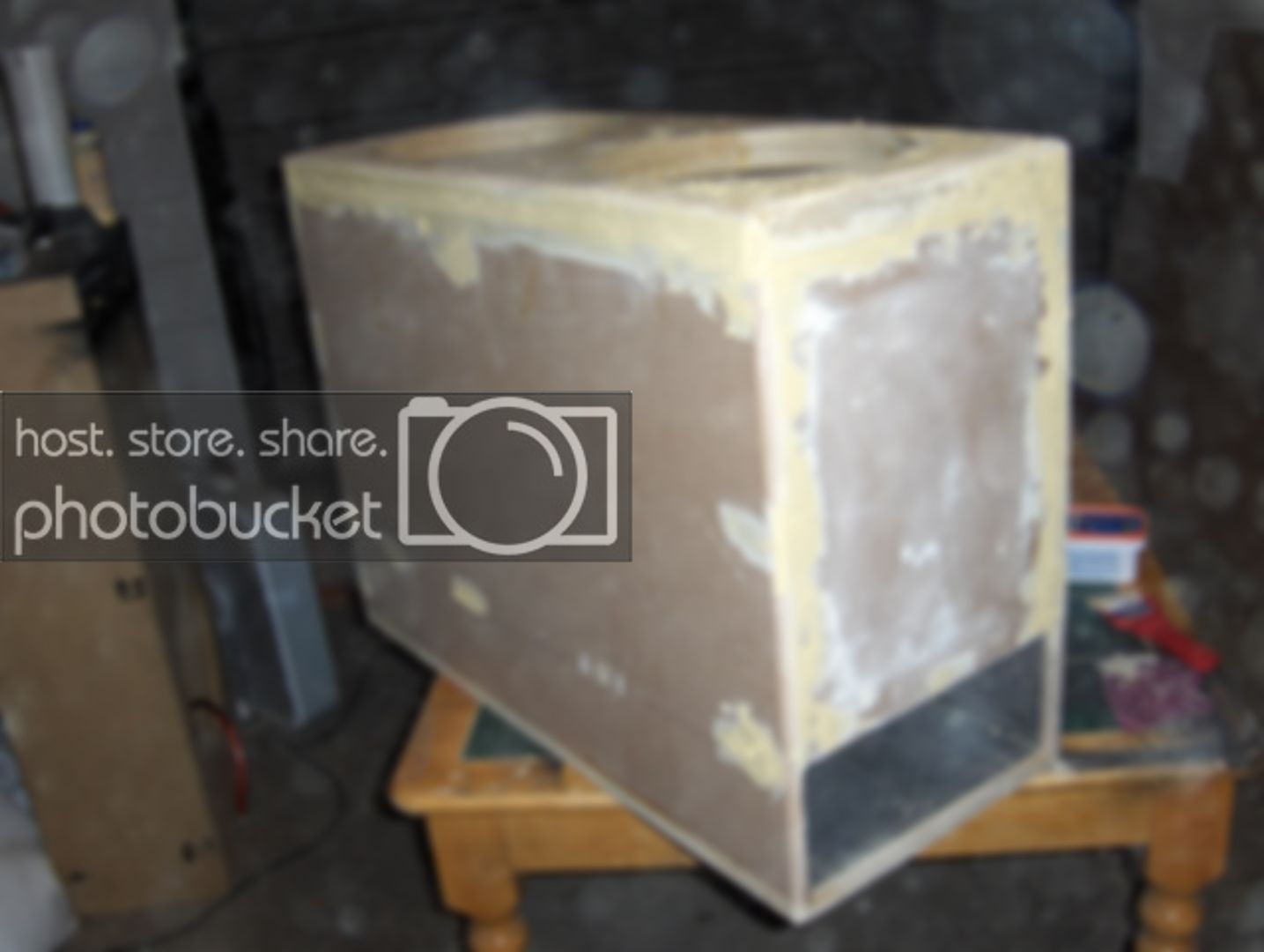

heres another pic, put a few hours in wood filler and sanding into it //content.invisioncic.com/y282845/emoticons/crap.gif.7f4dd41e3e9b23fbd170a1ee6f65cecc.gif
