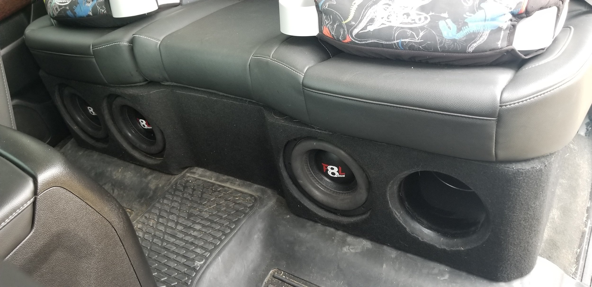

Nice setup. Can they really take 700-800 each? I guess after rise they might be getting around 500-600. I've never seen a box like that, sweet design. How many cubes did you get? I'm guessing 3.5-4 net.

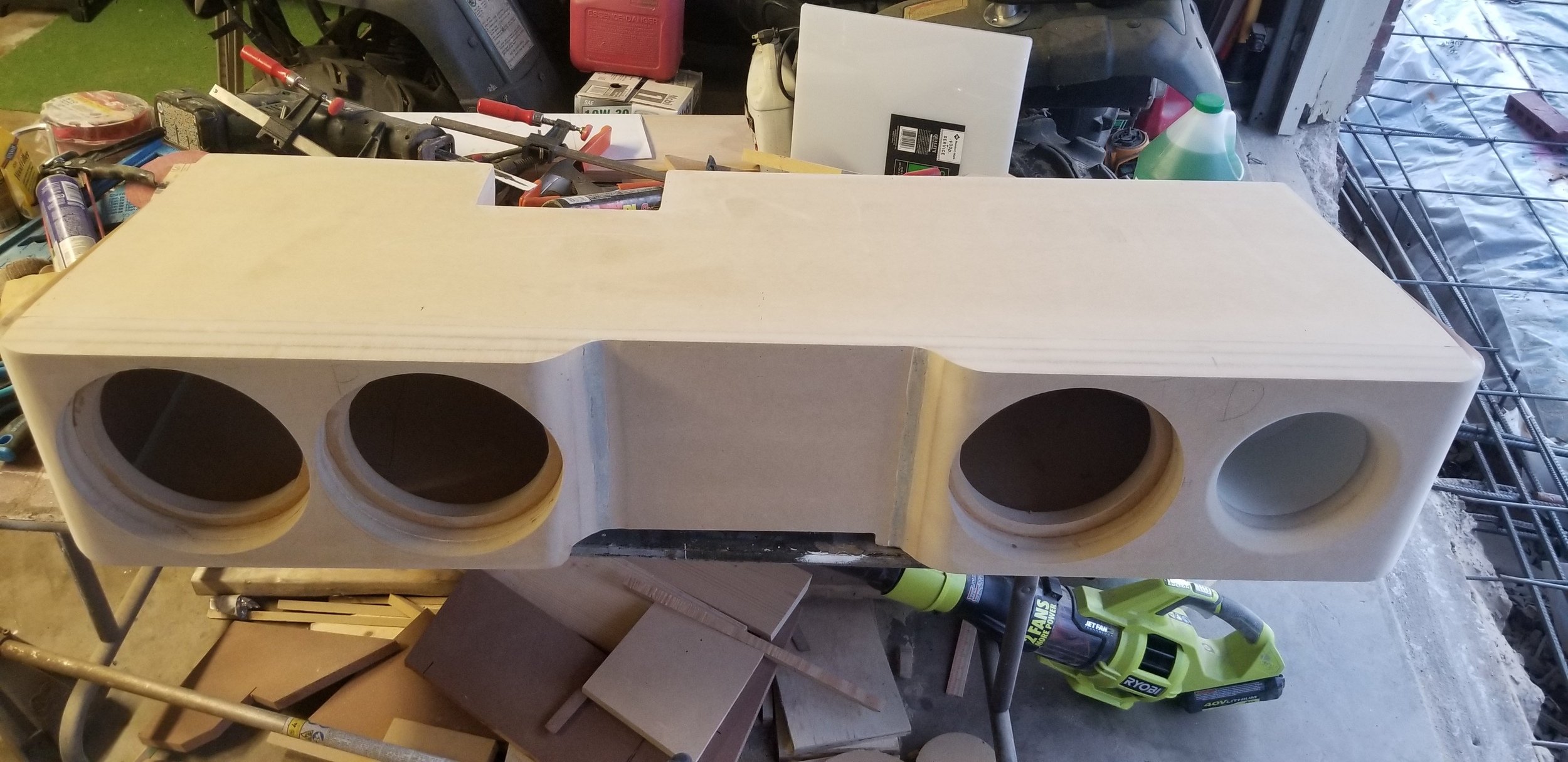

Before this I had 2 on the same amp at 1 ohm. They handled it pretty well. I could tell I was maxing them out sometimes, so I added a third. With the 3, I max out my voltage before I do the subs. So time for HO alt and batt upgrades.

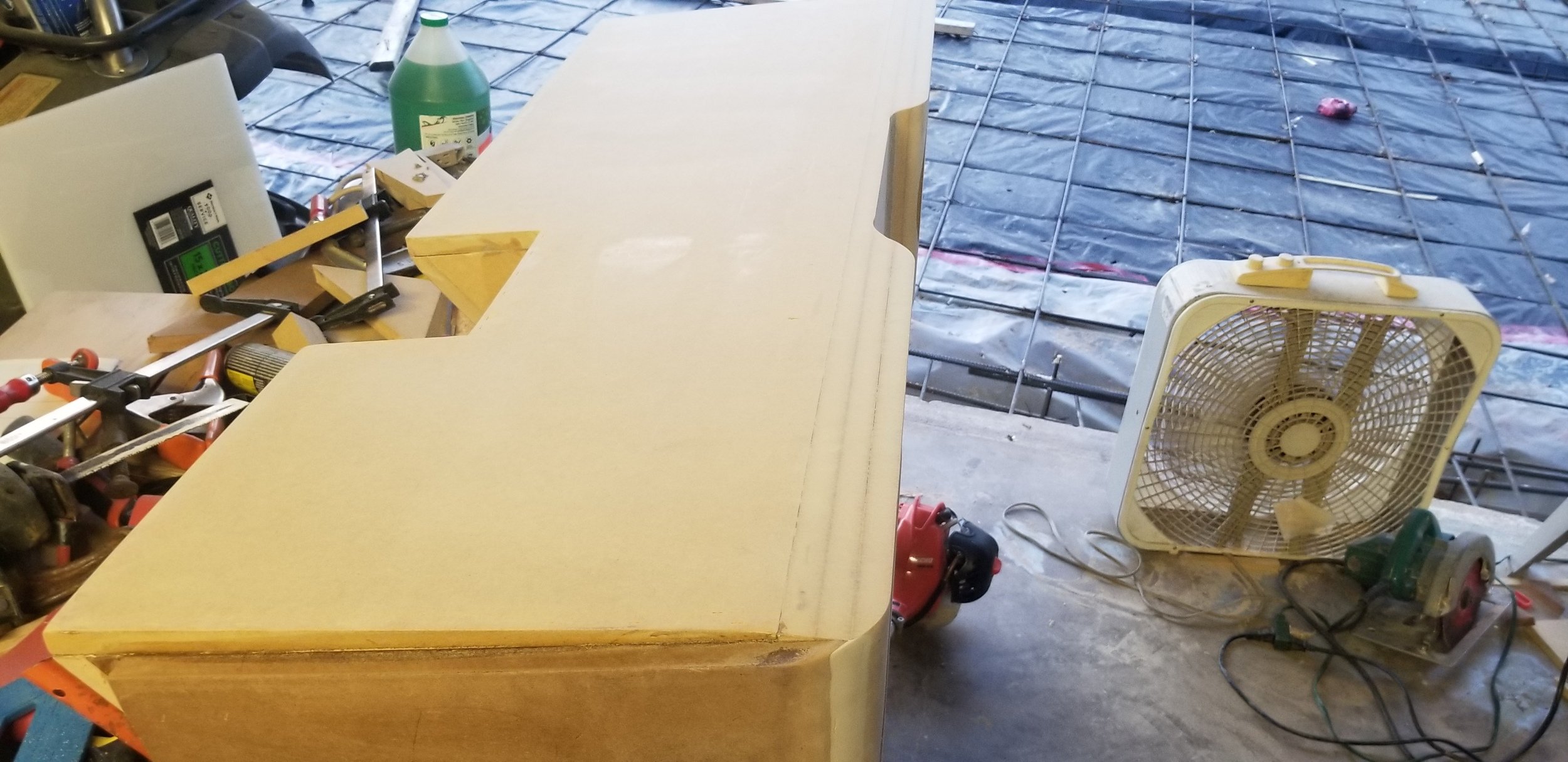

I squeezed every dimension I could to make it fit decent, tried to follow seat curves as best I could without sacrificing airspace. I believe I'm right at 3 cubes gross. And 1.95 net @33. Fitting that dang 6" port sucked. And I believe I'm technically probably a little low on port area.
I plan to press some mesh grills for fit the openings and cover the subs flush with the outside. What's why the subs are recessed so far.

Are you good on cubes net, or, a little shy? I tried to get two cubes net for my two VFL'S.
